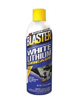

If the key is worn then I would start with getting a new key cut. If that doesn't work then it could be seized. At that point, you can put a straw from the lubricant can and it will get down in there. Or you can spray the key down with White Lithium Grease and then insert the key and let it sit in there for 10 minutes, then start working it to see if will work loose.
