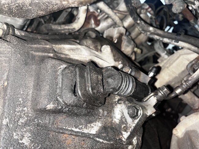

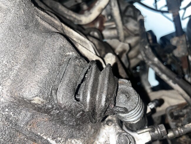

TIMANAJONES
This the boot to my clutch slave it’s torn, would this cause it?
Sep 13, 2024 at 8:34 PM
  • CAR REPAIR CONTRIBUTOR
  • 54,436 POSTS
No, that would not cause the engine to run rough at idle. did you check for vacuum leaks? Also, when was the last tune up?
