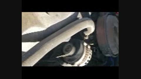

My truck idles really rough to the point it shakes the whole truck and then shuts off this happens when idling, at low speeds and stops. I have checked sensors and replaced fuel filter not sure what else could be causing this?

If this just started happening then the most likely cause is a vacuum leak. Let's run through this guide and go from there.
If this does not help then we need to check for codes but I am pretty sure we have a vacuum leak so I would be surprised if that doesn't help point us in the right direction.

Okay, I know I already asked and I haven't checked whether it is a vacuum leak but I just thought I would add a video for reference. I will check for a vacuum leak tomorrow.

That does help. Thanks. It does point to a vacuum leak as well so clearly that is where we need to start. If you have no check engine light the I doubt it is a misfire but if there are no vacuum leaks that will be the next thing we need to check. If you have not replaced ignition components in a while, that would not be a bad idea to do anyway but clearly start with a vacuum leak as you said. Thanks
