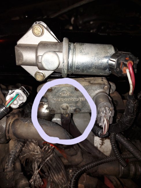

Vacuum leak.
Apr 13, 2021 at 5:55 PM

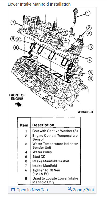

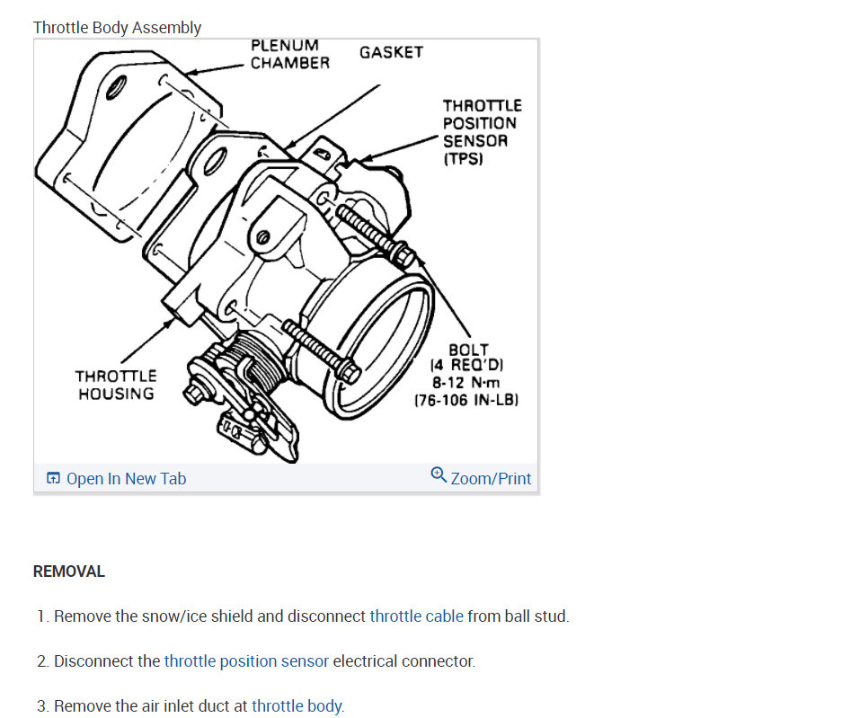

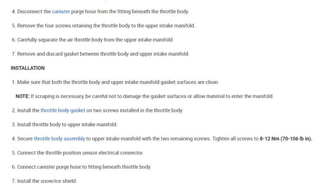

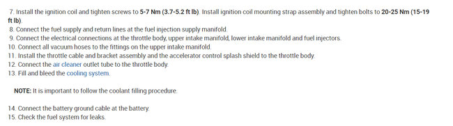

  • CAR REPAIR CONTRIBUTOR

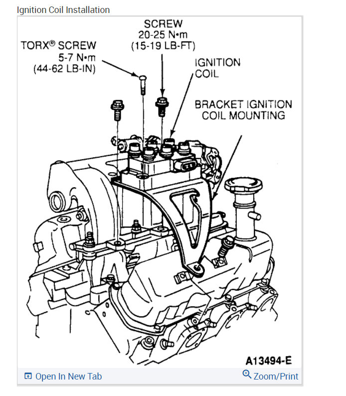

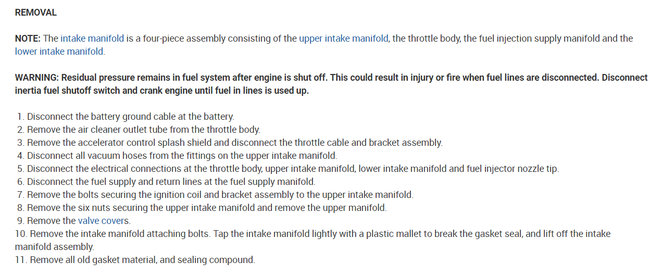

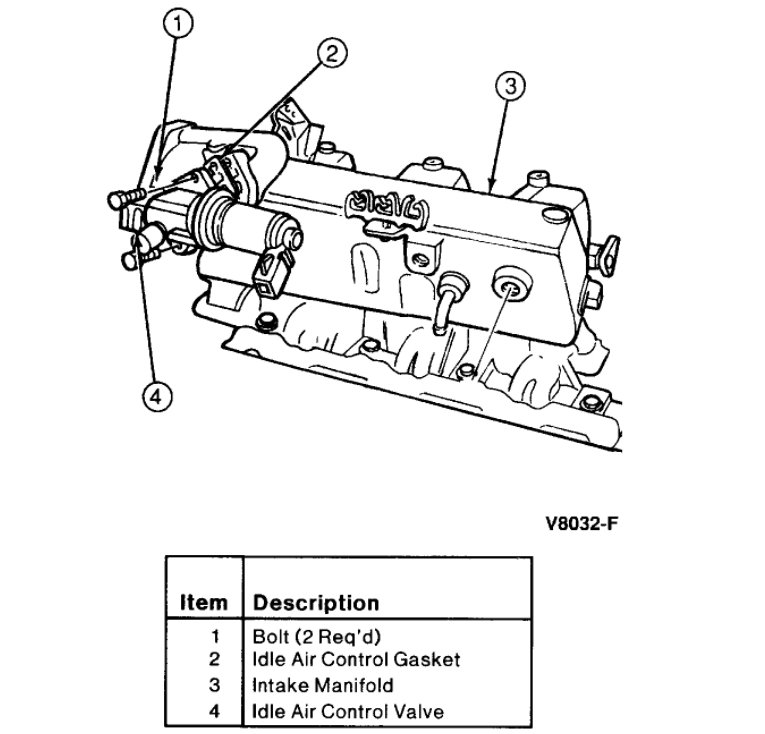

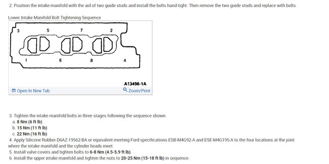

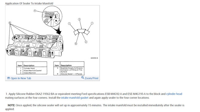

This sounds like you need a lower intake manifold gasket from where you are spraying.
The valve you circled is the DPFE and that will not cause the leak.
https://www.2carpros.com/articles/replace-intake-manifold-gasket
I attached the procedure for you to view.
Apr 14, 2021 at 12:32 AM

From your video, it points right to it.
Did they give it back to you that way after the repair?

With you spraying carburetor cleaner and the idle changing, you have a vacuum leak right there. Most of the time it is those gaskets.
Apr 14, 2021 at 4:41 AM
