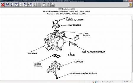

I rinsed my engine compartment yesterday and when I started my car this morning, the engine idle speed was fluctuating between 1000 -2000 rpms. I figured that it might have been due to the moisture from the wash and so I started driving to work. I did not noticed anything different while driving it (26 miles) but when I arrived at work and put the car in park (automatic), I noticed that the idle speed is still fluctuating the same way as when I first started the car. What can i do to fix this problem. Please help. My car is a 1999 Honda Accord V6 EX with automatic transmission. Thanks.

MERLIN2021
  • 17,250 POSTS
On your throttle body locate the idle air control valve, unplug it and get any moisture out! If the doesnt help you may have shorted it out, and may need to replace it. Try compressed air at the connectors.

ILIKETHIS1968
Is the idle control valve the one that site on top of the throtle body with the accelerator cable attched to it? If it is shorted out, what or how can I replace? Thanks in advance.
Wednesday, September 25th, 2019 AT 2:28 PM (Merged)
MERLIN2021
  • 17,250 POSTS
No it's on the bottom and has a connector, and a few screws.

ILIKETHIS1968
It idled steady at 1050 rpm after I sprayed it with wd40 then I drove it for 3 minutes and put it in "park" then it started fluctuating again. Why does it run nice and steady when it is in drive and fluctuates when it is in "park"?
