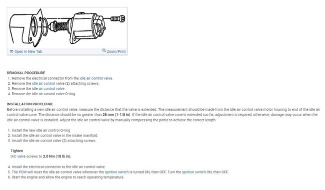

Accidentally moved setting of IAC while cleaning it, idles low then high

It is self-adjusting, and you cannot adjust it.
https://www.2carpros.com/articles/how-to-replace-an-idle-speed-control-motor-iac
Also, there is no cleaning as the areas that stick you cannot access. The only repair is to replace it with a new one.
