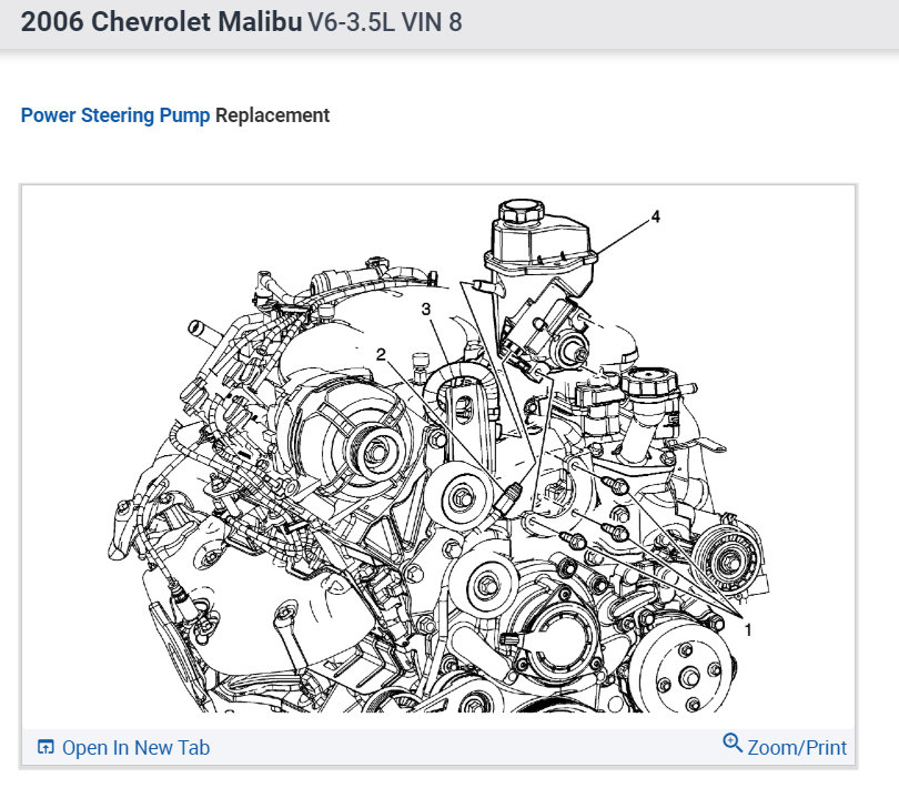

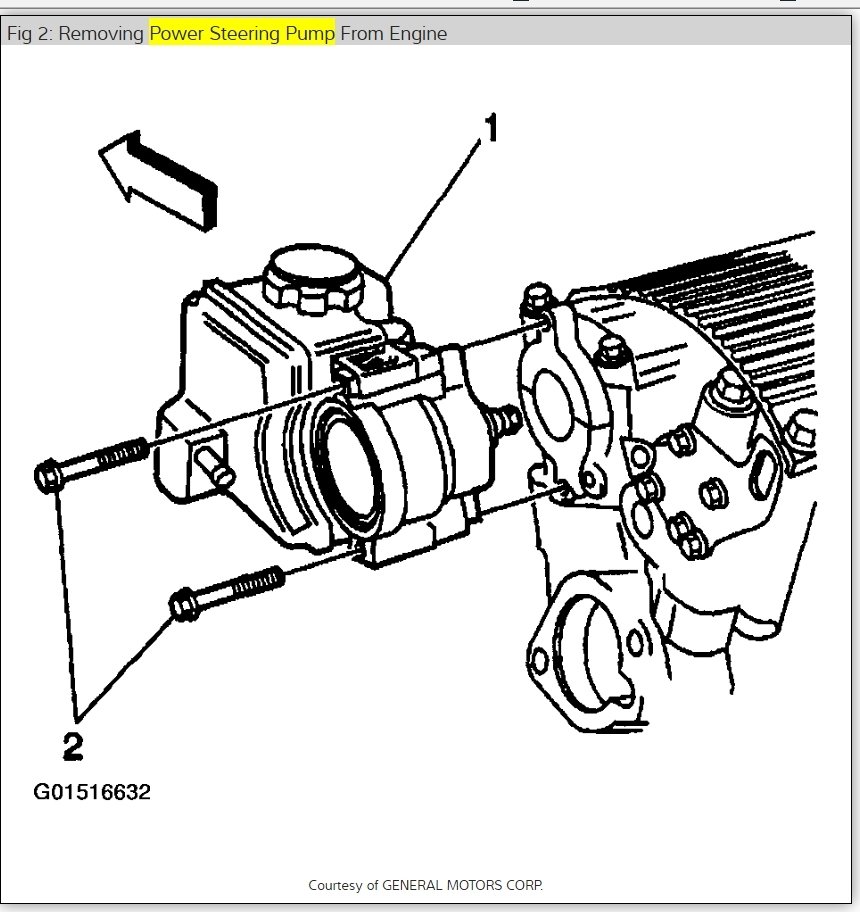

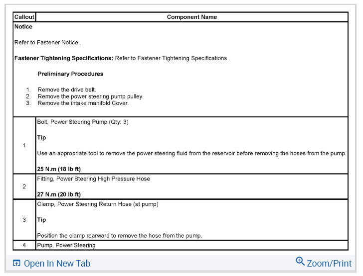

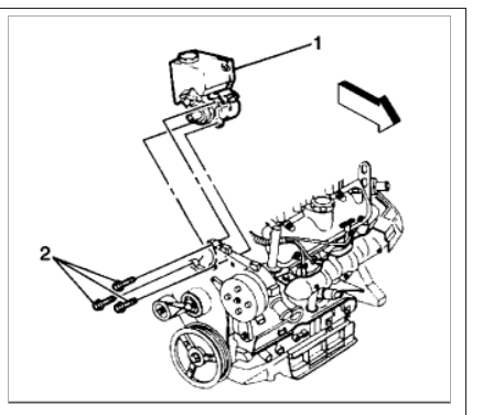

How do I replace the power steering pump and high pressure line?
Sunday, September 4th, 2016 AT 9:06 AM
11 Replies
HMAC300
  • 48,601 POSTS
Here is a guide to help walk you through the steps on a similar car with instructions in the diagrams below to show you how on your car.
https://www.2carpros.com/articles/how-to-replace-a-power-steering-pump

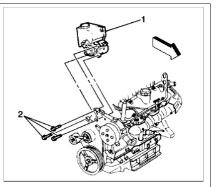

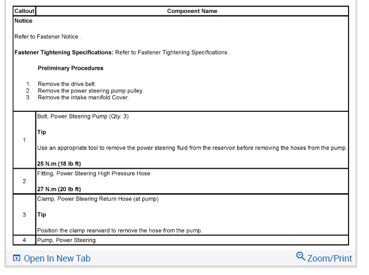

Hey David,
On 2.4L models, remove air cleaner duct. On 3.1L models, remove upper engine mount. On 3.4L models, remove serpentine drive belt. On all models, disconnect pressure and return lines from pump. Remove mounting bolts. On 3.4L models, support engine by oil pan. Remove engine mount. Remove pump.
On some models, it may be necessary to remove pump bracket with pump.
To install, reverse removal procedure. Tighten bolts and fittings to specification.
Here is a guide and video on how to do it.
Please let us know what you find so it will help others.
Best, Ken

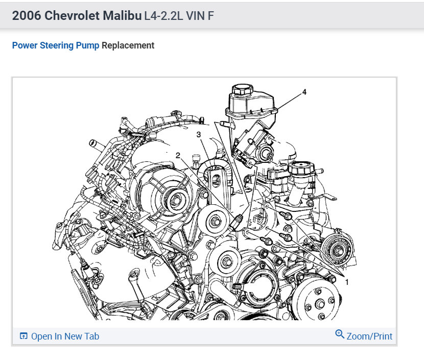

How do you change the power steering pump
Saturday, May 2nd, 2020 AT 12:03 PM (Merged)
ROWTIEAR
  • 91 POSTS
Remove the serpentine belt,
Remove the pressure and return hoses from pump.
Remove the 3 13mm bolts through the holes in the power steering pump pulley.
Remove the pump.
Remove the pulley from the pump on the bench. (Special puller required)
Remove the reservior from the pump.
Install the new pump in reverse order.
