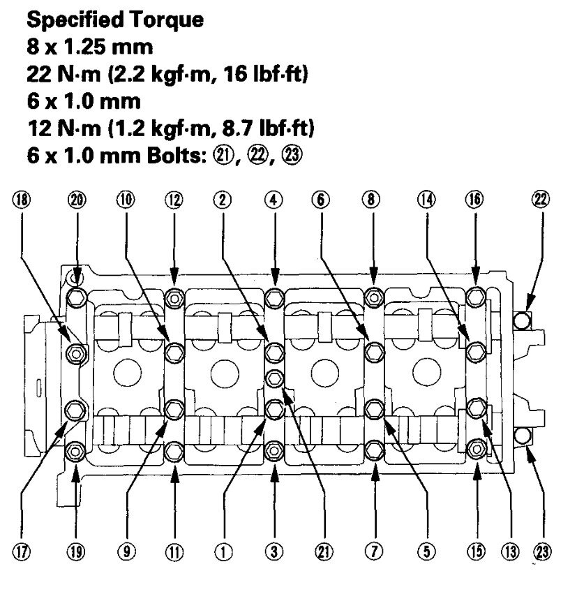

I need the torque specs for the camshaft caps?
2008 ACURA RDX
170,000 MILES • 2.3L • 4 CYL • 4WD • AUTOMATIC
MICAEL
I can really find anything related to the torque specs for the camshaft cap bolts.

This should cover the caps and torque sequence. It also has in the notes that some don't have the bolt tagged as 5 and if it isn't there to ship it and just keep going.
