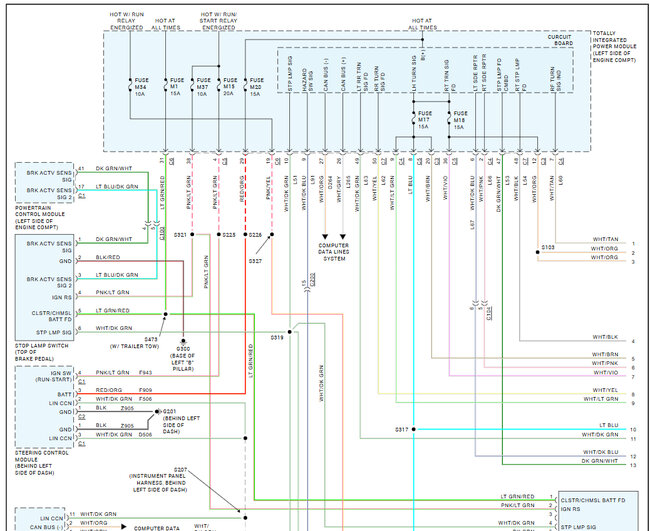

I just had my TIPM replaced. Now my turn signals are not working. I need a diagram on how to rewire it. I need 599-982 that part number wiring diagram.
Nov 1, 2024 at 9:29 PM
  • 54,520 POSTS
Sure, here are the turn signal wiring diagrams and I have included a guide to help you test the wiring connections as well.
Check out the images (below). Let us know how it goes.
