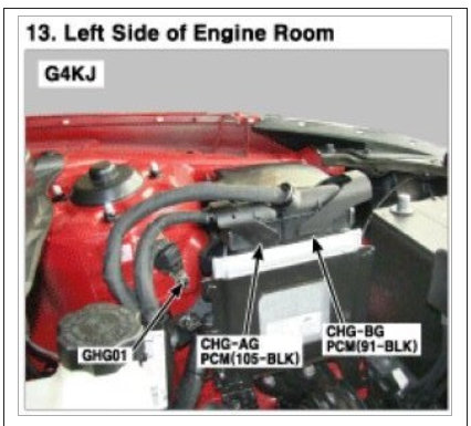

I have problem with oxygen sensor code p0130. I have replaced o2 sensor but after 12 km check engine light comes again. Please help me. Did p0130 code can come for air sensor also or anything else.
Saturday, June 23rd, 2018 AT 6:41 AM
KEN L
  • MASTER CERTIFIED MECHANIC
  • 55,291 POSTS
I have seen this problem being the computer being bad. Here is the location you will need to get the new one programmed at a shop. It should cost about $130.00.
Check out the diagrams (below). Please run some tests and get back to us.

Yes, it sounds like the PCM is bad.
Monday, June 25th, 2018 AT 10:48 AM
MUHAMMAD SAQIB
  • 8 POSTS
How can I set PCM?
Monday, June 25th, 2018 AT 12:27 PM
KEN L
  • 55,291 POSTS
A shop will need to do it should cost about $130.00.
