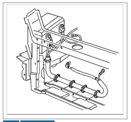

My car listed above is the GT model. It has been intermittently losing all power. I have tested my battery and my alternator and starter on a bench tester and a hand held. While still on the car voltage readings are fine. My computer has wiped all codes from its memory, but I do not have any electrical power. I have used every resource I could to find the problem. I have cleaned all my connection and replaced my ignition lock cylinder. Still the same issue. Does anyone have any suggestions?
Wednesday, July 4th, 2018 AT 6:08 AM
KEN L
  • MASTER CERTIFIED MECHANIC
  • 55,488 POSTS

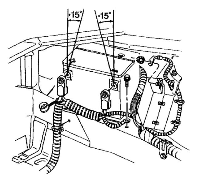

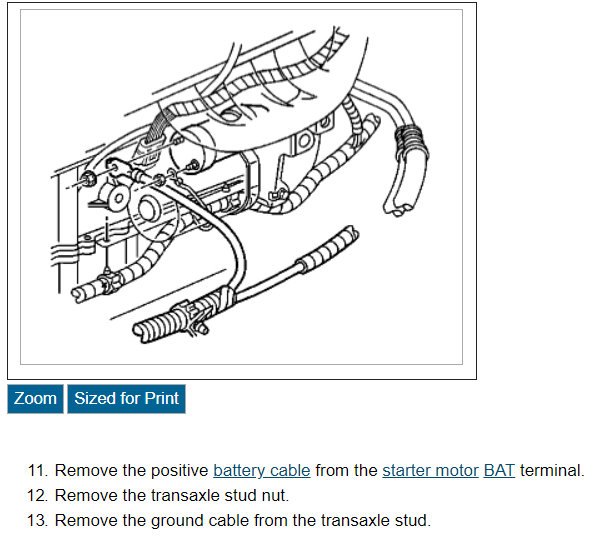

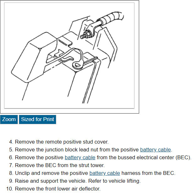

This is common when the positive battery cable goes bad. Here it a diagram to show you how to replace the cable. Make sure the terminals are clean.
