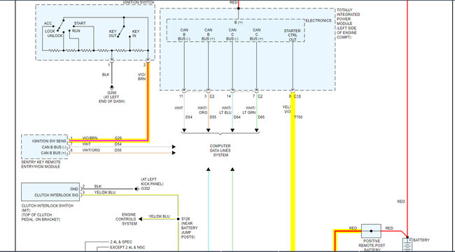

The car cannot start.

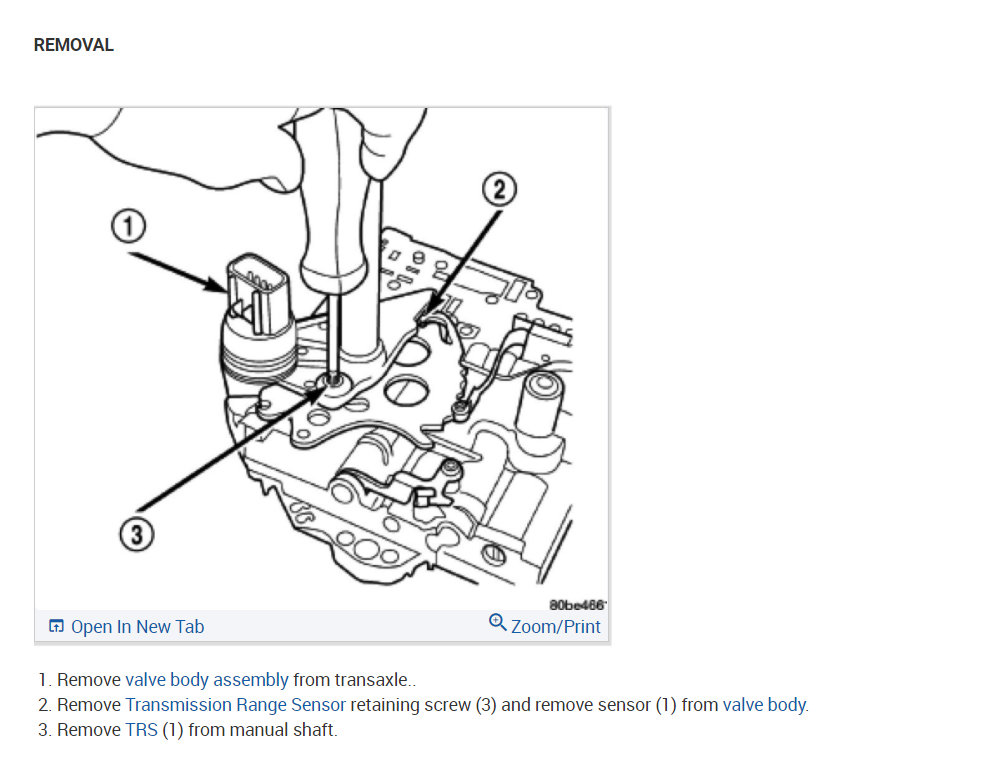

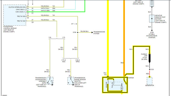

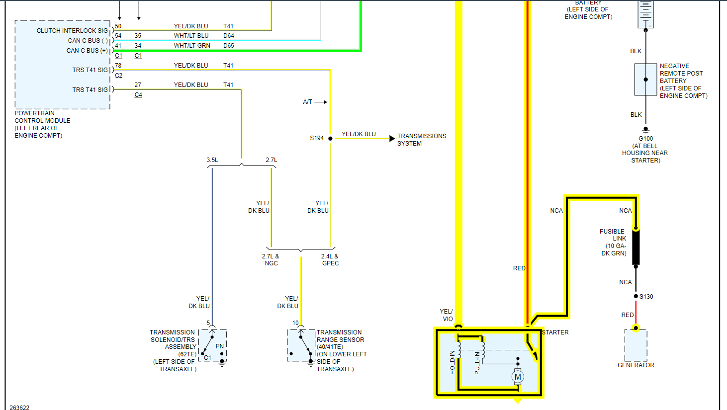

I attached the wiring diagram for starting. The signal comes from the TIPM itself based on input from the park/neutral switch.
https://www.2carpros.com/articles/how-a-neutral-safety-switch-works
