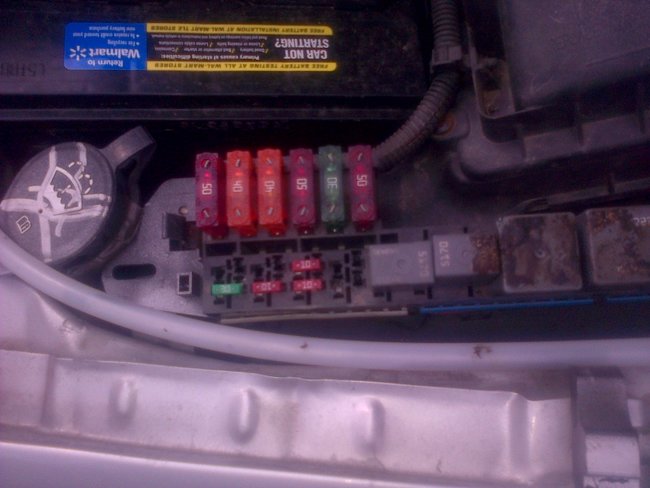

Maybe it is a blown fuse or fried fusible link not allowing your "good" alternator's juice to reach the battery.
If you are still kind of lost on this, send your VIN number and I will attempt to find an informative wiring diagram in "Prodemand". It should list all components in the charging system with their locations.

Hey guys,
I found this for you, I hope this helps.
Best, Ken Lavacot

I would run new wires to the battery and controllers. The wiring is pretty simple follow the diagram i sent you.
