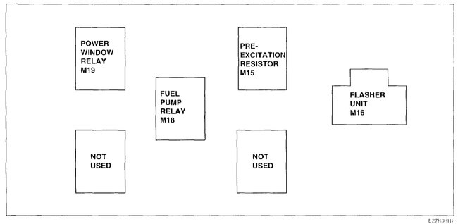

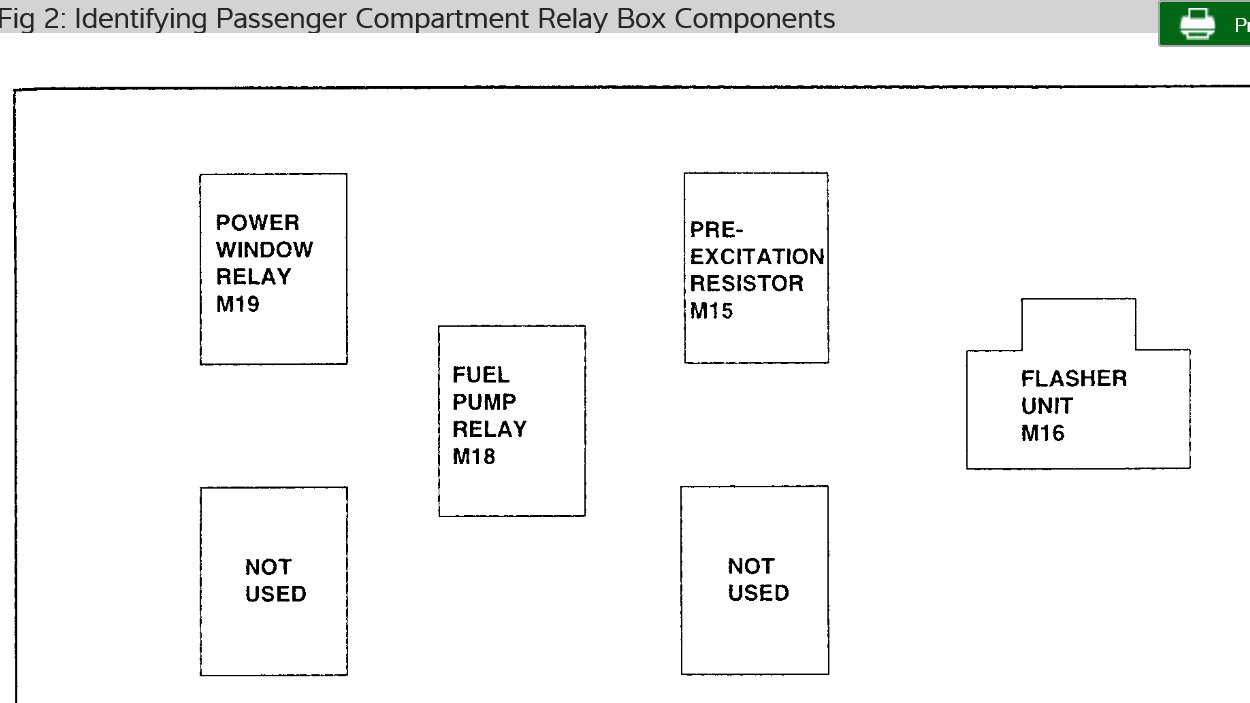

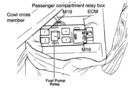

where is the fuel pump relay on the 2001 tiburon. I keep hearing in the passenger compartment relay box. Is that under the hood or actually under the glove box area?

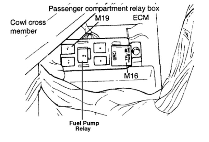

The fuel pump relay is in the passenger compartment relay box under the hood. See the image below
https://www.2carpros.com/forum/automotive_pictures/12900_fp_46.jpg
Here is a guide to help you test the relay to confirm the failure.

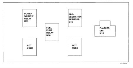

Where is the fuel pump relay on a 2000 hyundai tiburon and does it have an inertia switch

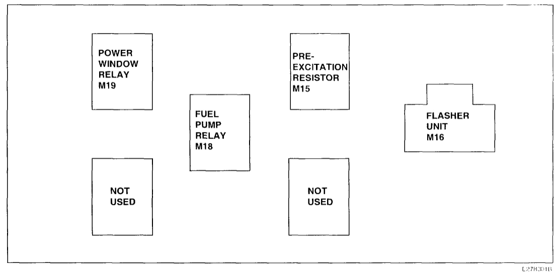

2000 Hyundai Tiburon L4-2.0L
Fuel Pump Relay
https://www.2carpros.com/forum/automotive_pictures/12900_fprh1_1.gif
Passenger Compartment Relay Box (Layout)
https://www.2carpros.com/forum/automotive_pictures/12900_fprh2_1.jpg
No it does not have an inertia switch.

I kind of doubt it is the relay as they either work or will not work. check fuel pressure with a gauge it may be blockage on return line if you have or filter auto parts rent gauge and you may need an adapter to test. See link and picture relay in pass compartment relay box.

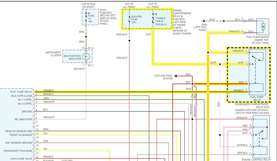

Hey guys, so I have an interesting problem. I have an 01 tiburon and it cranks but does not start (turn over).
So I figured the problem could be fuel, spark or air. Checked the spark and air and they are good. Check the fuel and there was no gas going to the engine. So I took out the back seat and checked the fuel pump. The fuel pump turns on if manually given 12 volts but it doesnt turn on normally. Checked the voltage at the electric line coming in and it was 0. So I thought it was the fuel pump relay. I swapped out one of the relays from the front and still no voltage.

First, there will only be power to the pump for 2 seconds with the key on, then 12 volts while cranking.
Re test the pump under these conditions first
Thursday, January 7th, 2021 AT 1:32 PM (Merged)

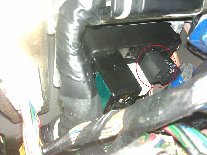

PSIN2005
Hi Roy, I checked the voltage in the beginning as well as while cranking and its still 0 (it fluctuates a bit but only by.01 volts).
My next thought was to check the relay once again and I replaced the relay that was there. Here is a picture of what I replaced.

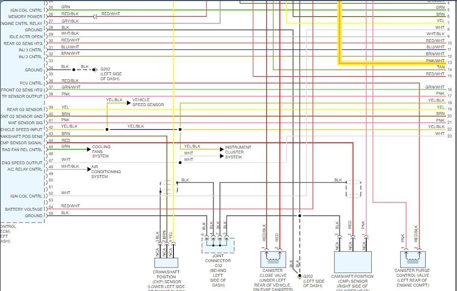

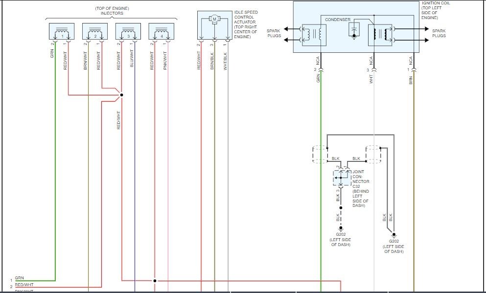

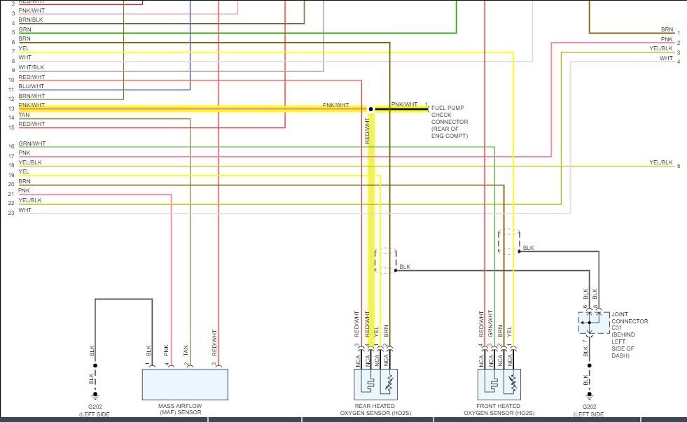

It sounds like a wiring issue between the relay and the fuel pump.
I attached a wiring diagram for you to view.
Check for powers to the relay to be sure power is available.
