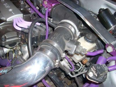

I have a tiburon 98, the engine light comes on while the car is idling, or after a fast drive, coming to a stop, like at a red light.
When the car is idling in the mornings, the light doesnt come on since its cold, any ideas?
sometimes going in 1st gear, the car shutter, or acts as if it wants to stall, then pressing more gas, its back to normal. I know the problem is around the throttle body area on the pic here.
TPS? o2?
https://www.2carpros.com/forum/automotive_pictures/224560_maf1_2.jpg

SENSIBLEJACK
Fault is due to- Long Term Fuel trim additive, air system too lean.
