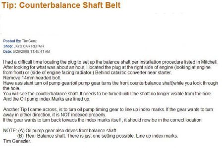

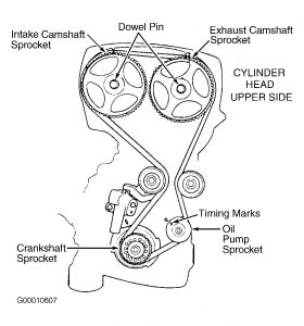

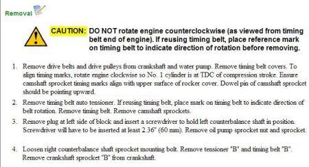

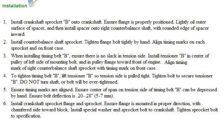

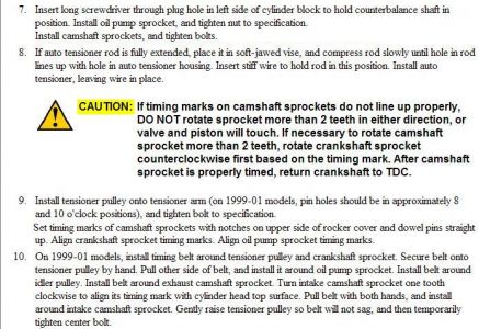

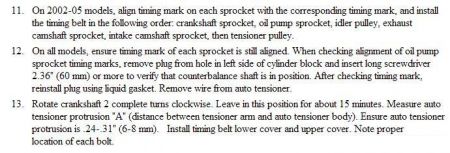

I was wondering if it is possible to change the timing belt on my 2002 Sonata by just supporting the engine and removing the engine mount. It still looks pretty tight. Will everything I need to remove be accessible. Also what does the "b" belt do?
Friday, January 22nd, 2010 AT 3:16 PM
BLUELIGHTNIN6
  • 16,542 POSTS
"B" belt refers to your counterbalance shaft belt which is removed same time as timing belt. Replacement steps are below..
