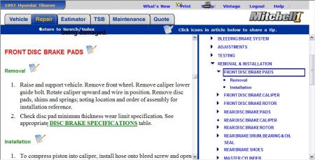

How do I change the front brakes on my 2002 Hyundai Accent GL?
Sunday, November 4th, 2007 AT 8:53 AM
MECHANIC
75,992 POSTS
Read instructions below
