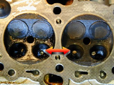

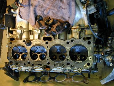

And it explains all of the codes. That vacuum leak raises the idle, thus the first codes. That air entering the manifold is not calculated by the computer as it is bypassing the sensor that reads where the the air should be coming in. That extra air leans out the air/fuel ratio thus the misfires on all cylinders.
If you need any help navigating through Mitchell let me know. IF you haven't done the timing belt I strongly recommend it. When they break on these it WILL trash the head and sometimes pistons.
https://www.2carpros.com/forum/automotive_pictures/30961_cylhd4_1.jpg
https://www.2carpros.com/forum/automotive_pictures/30961_cylhd2a_2.jpg
Notice how all of the valvs on the one side are snapped off.
