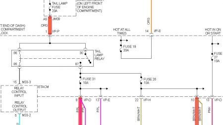

The tail light fuse blew on my XG#%). I replaced it ant blew again within minutes (not immediately)
Friday, October 17th, 2008 AT 6:20 PM
MECHANIC
75,992 POSTS
XG350 Model
Check the tail lamp relay or swap it and see what happens
If its the wires going back to the tail lights are shorting out it will blow fuse no.31 10amp and fuse no.26 10amp.
