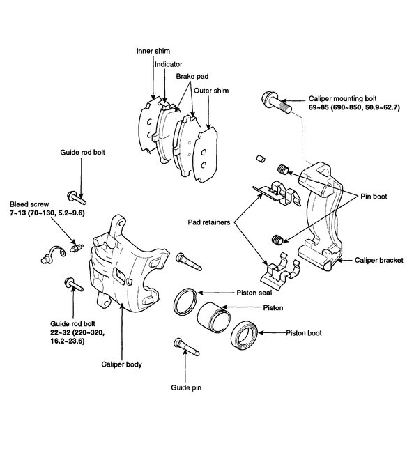

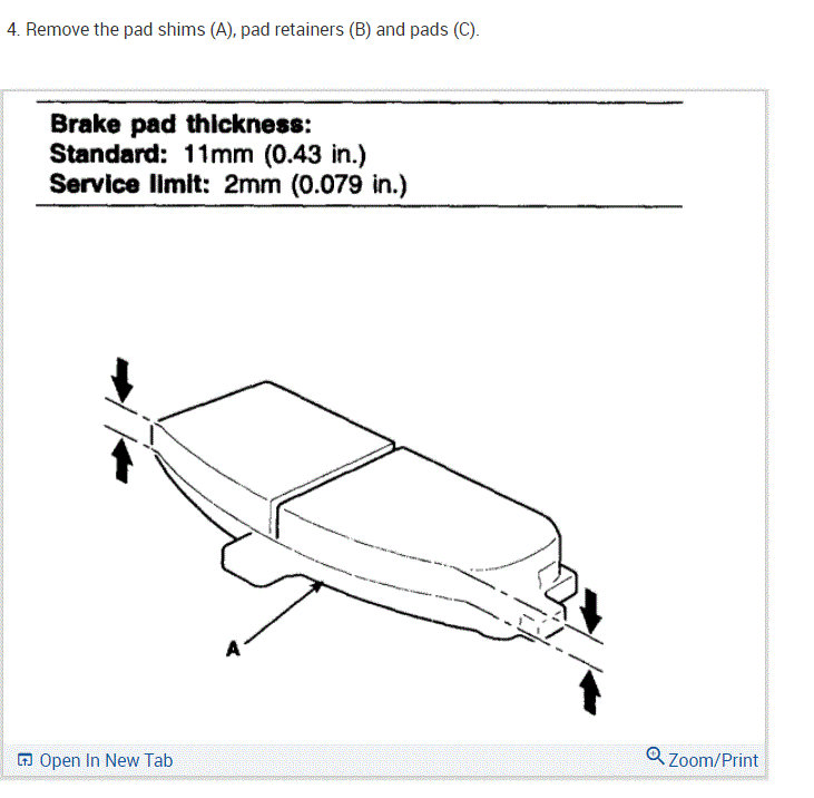

I found the brakes were bad so I need to do them, can you help me?

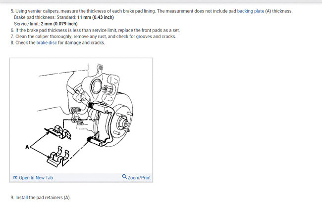

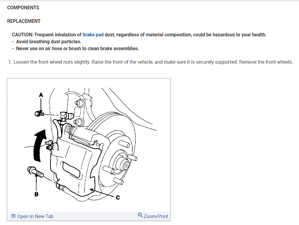

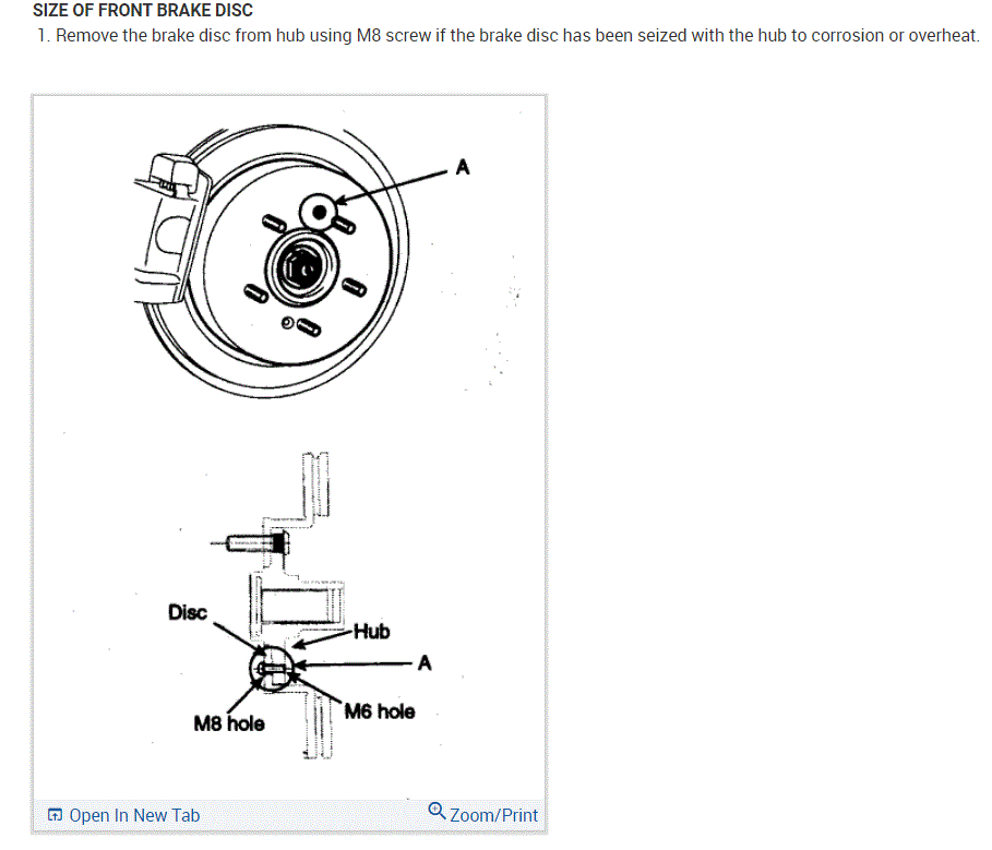

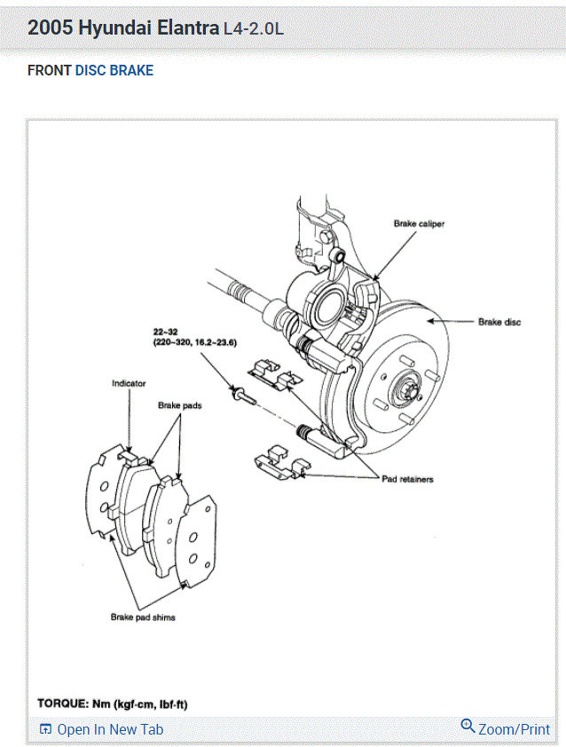

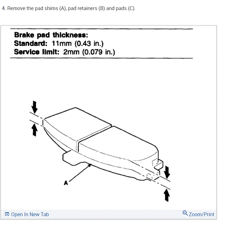

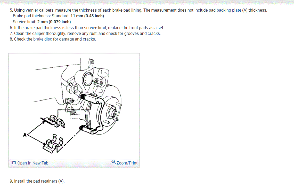

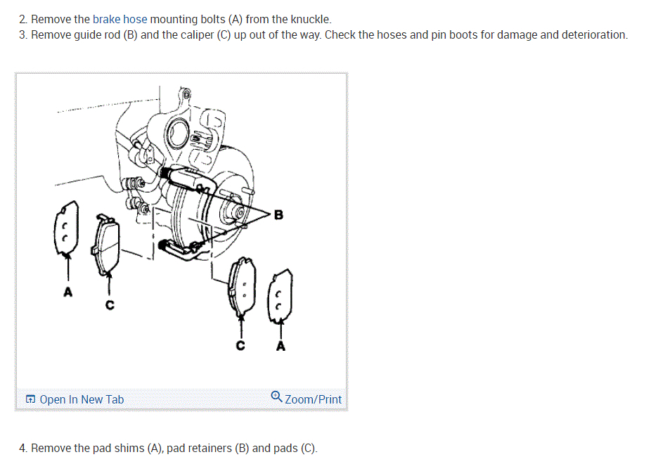

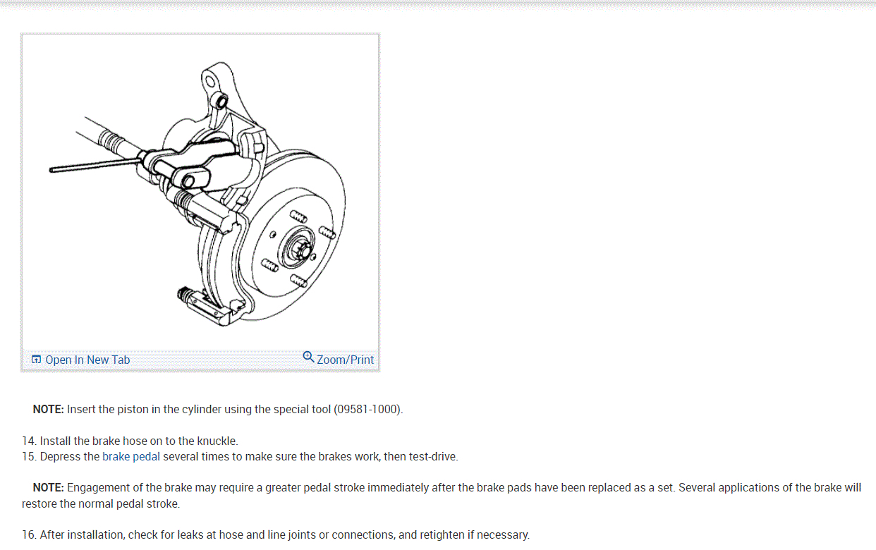

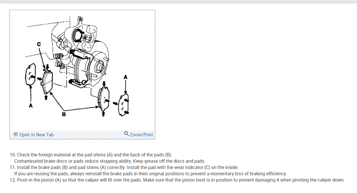

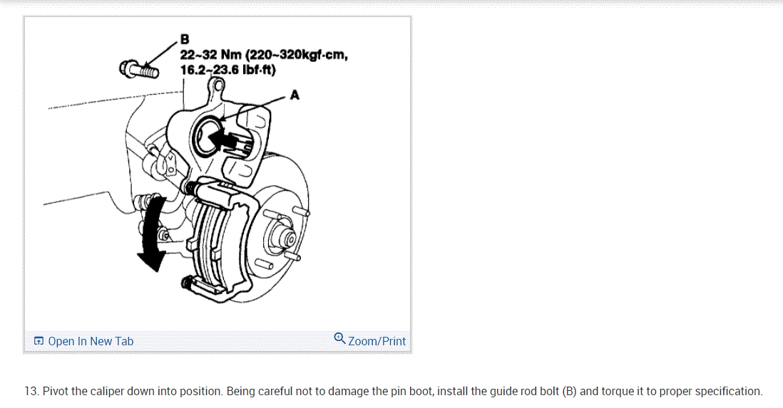

Replacing front brake pads and rotors really isn't too hard to do. If you do it yourself, make sure to get lifetime parts so you never have to pay for them again.
To get you started, here is a link that shows in general how it is done. You can use it as a guide.
If you look at the pics below, they include the directions and pictures specific to your vehicle for this job. Also, here is a video showing the procedure being done on a Sonata. It's a different model, but the procedure is very similar.
https://youtu.be/7zjHSFVangI
PS: See pics below for directions.
