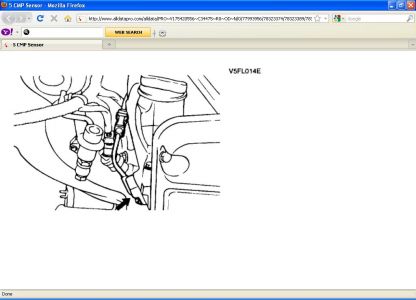

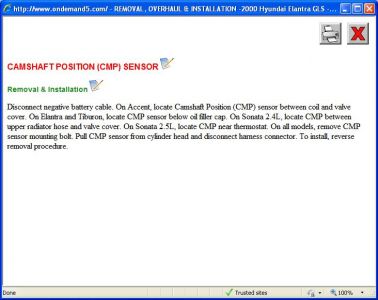

How to replace a camshaft sensor
Monday, August 16th, 2010 AT 12:28 PM
SATURNTECH9
MECHANIC
30,869 POSTS
There you go.
