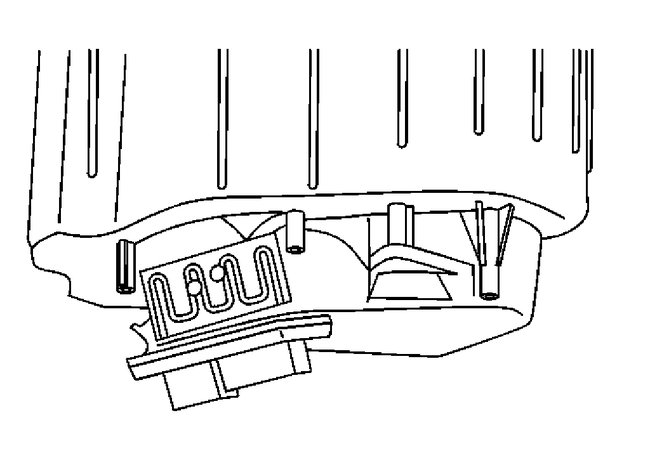

They will replace the resistor and splice in a new connector. Below is the part numbers of the parts you need. There are 2 resistor part numbers. Order the one that applies depending if you have A/C or not. Replace the resistor and cut out the old connector and splice the new one in.

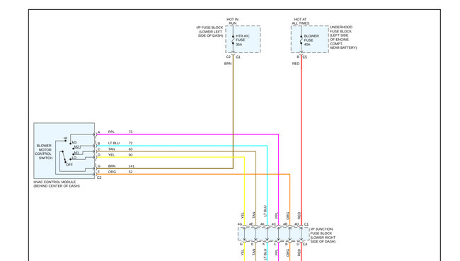

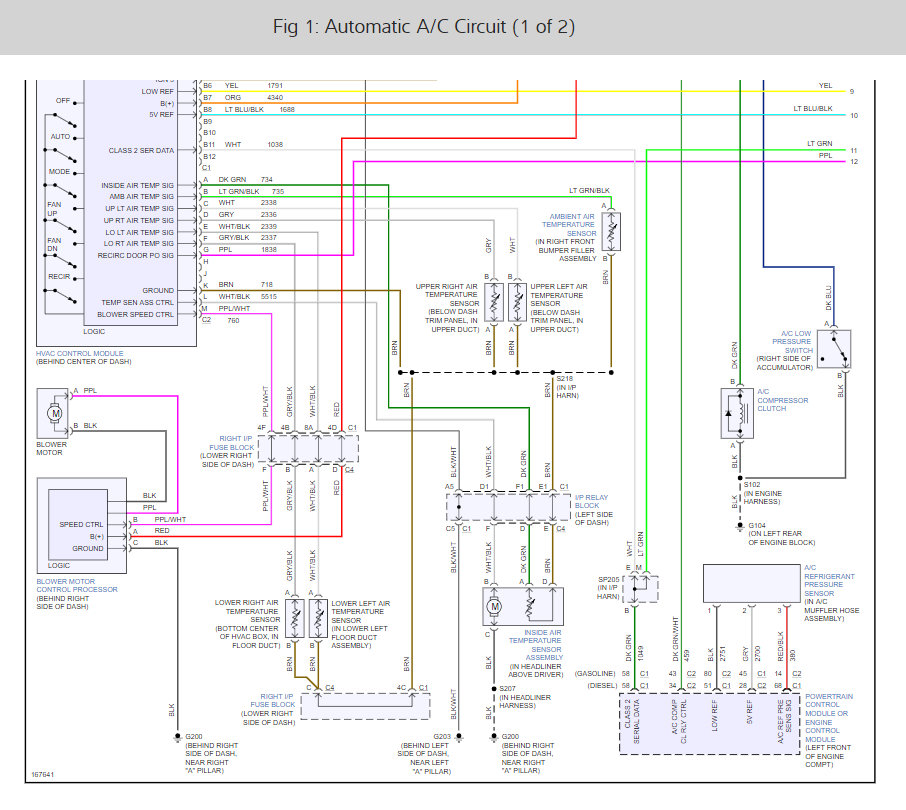

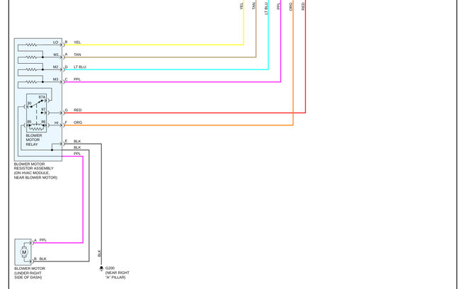

Joe from what I am reading you only have 6 volts on the red wire, This is not good you should have a full 12 volts, It is possible you have a loose or corroded ground wire. I am sending you wiring diagrams of the heater blower motor and the main ground location the links are below. Please look at them and please let us know if this helped you and what fixed problem.
Thank you,
Joe Terwilliger
Wednesday, December 11th, 2019 AT 4:26 PM

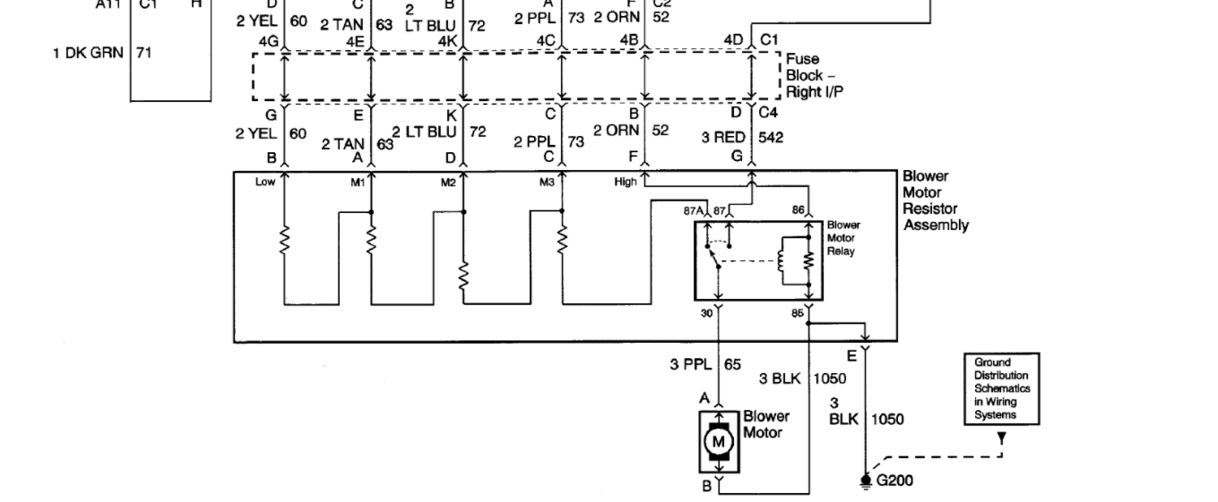

Thanks for the info. Here's what I've concluded after working on the truck on and off for the last few weeks: There is no G200 ground location as indicated in your wiring diagram. Instead there is a wiring harness that it plugs into on the side of the glove box. I have burned up 2 new plugs that adapt to to the resistor for the blower motor so far. During the process of replacing the harness I discovered that the ground wire (the black wire in the harness is hot as it sparked when it touched another wire in the harness. This happened with the ignition off. So I believe it's a ground issue but I can track it down. Any help would be greatly appreciated. Thanks, Joe
Thursday, January 23rd, 2020 AT 4:35 AM
TOUGHDIVER
  • 224 POSTS

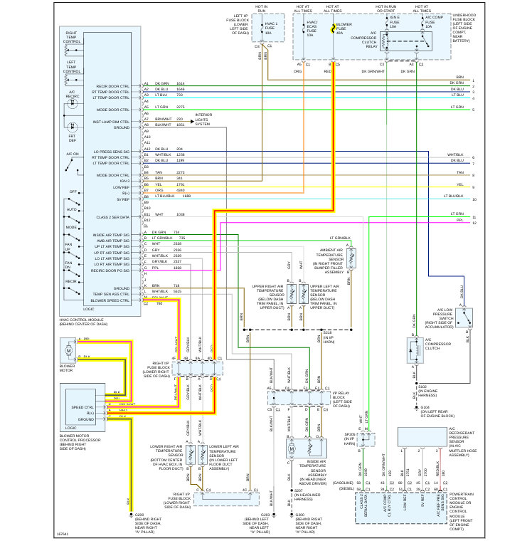

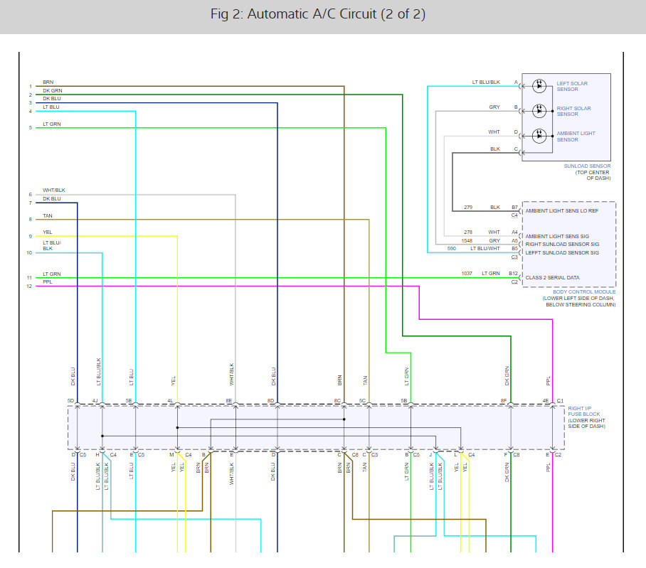

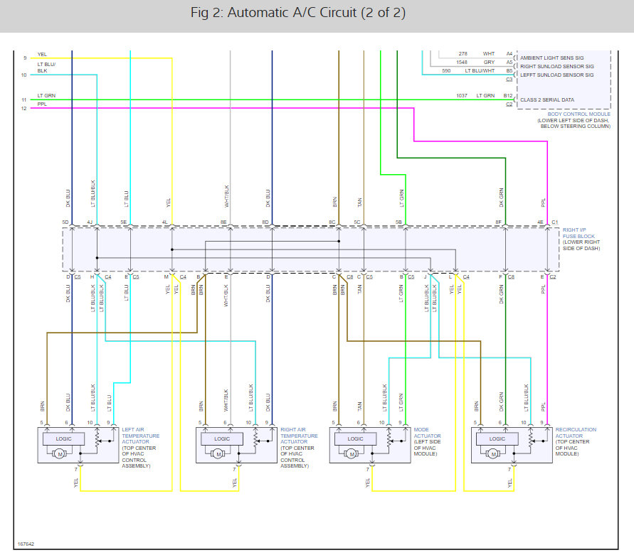

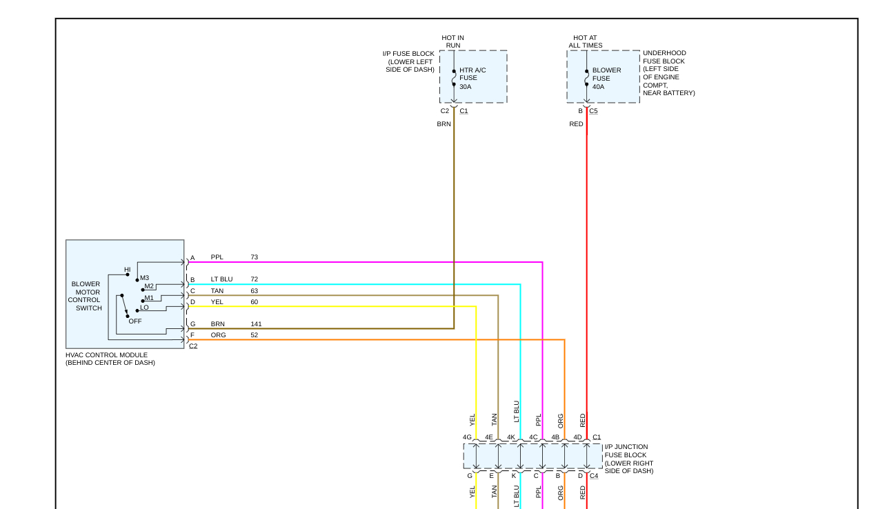

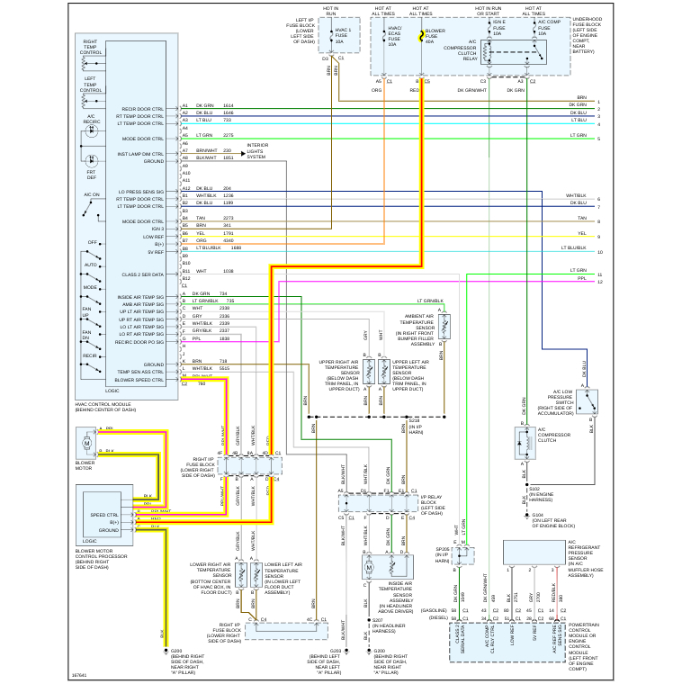

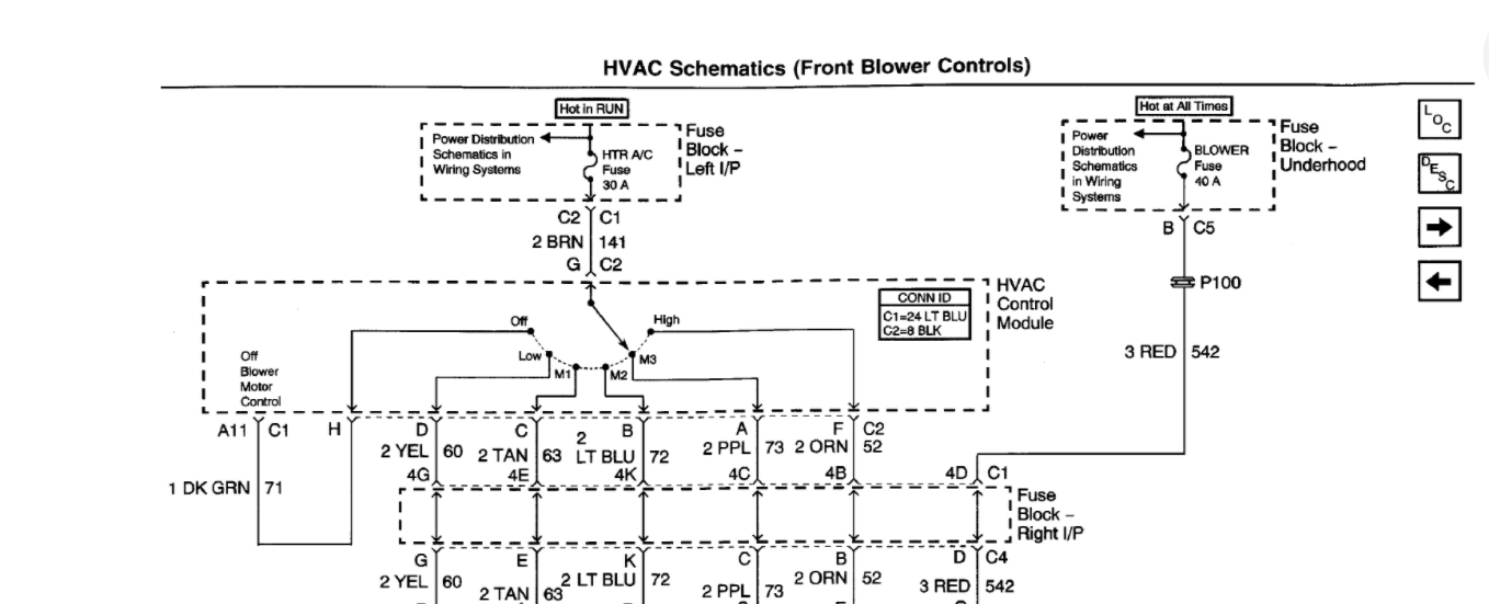

Joe, the G200 ground wire should be on the drivers side front door pillar but I want to be sure what heating and air conditioning unit we are working with is it manual or automatic. It will make a difference in the wiring system. The first wiring diagram below is for the manual system. With the key in run position not running should have 12 volts at the red, orange, and purple wire and to both black wires I highlighted the wires for you. The second diagram is for automatic heating and A/C control and there should be 12 volts at the red wire to black wire connector C but the purple wire with a white white stripe and the solid purple wire voltage may vary because voltage for these wires are controlled by the heater control module and the heater blower motor processor. It could be a faulty control module behind the center dash or blower motor processor right lower dash were resistor should go. Please let me know if this info is helpful and if you need any more information.

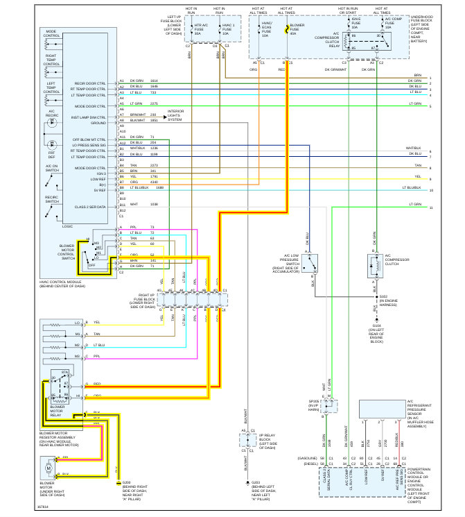

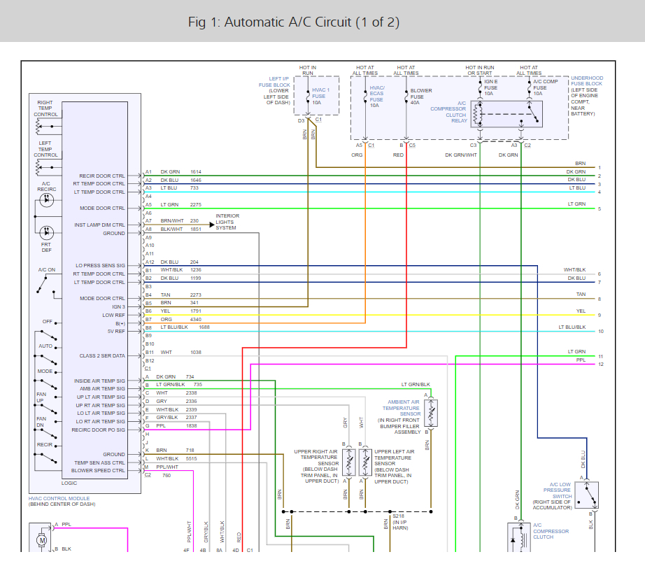

So you have power and ground and replaced the controller blower motor and resistor, there must be a wiring issue. here is a guide to help you with the wiring diagrams for the system enlarged so you can read them. Check continuity to ground on all none ground wires.
Check out the diagrams (below). Please run this test and get back to us.

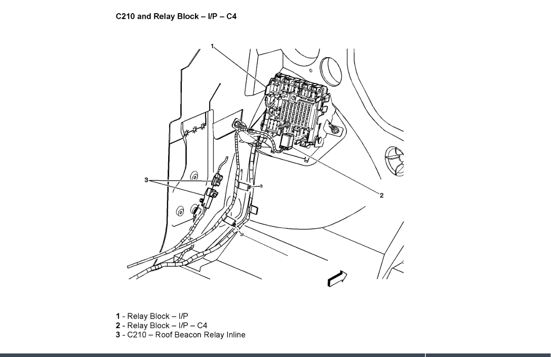

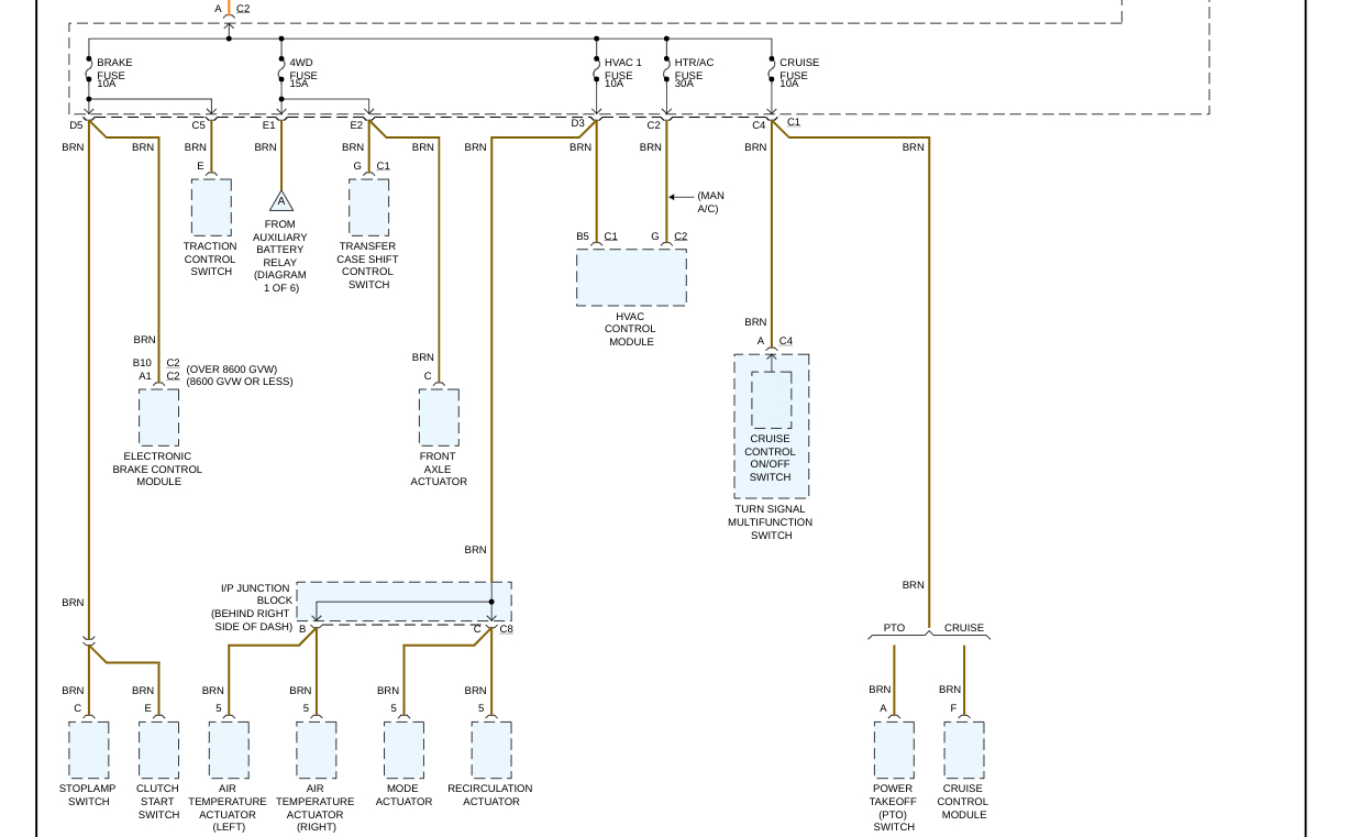

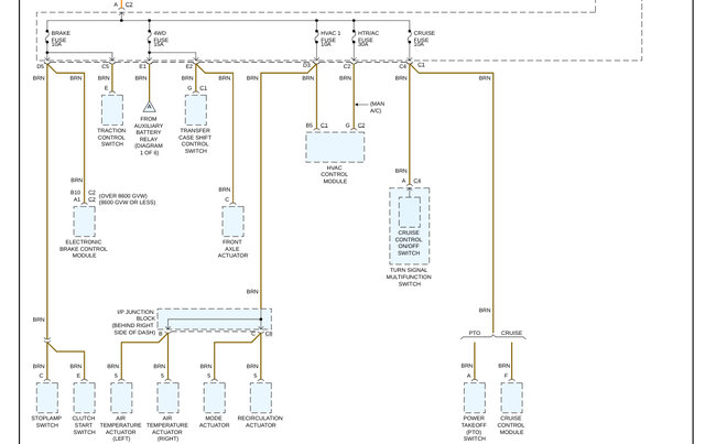

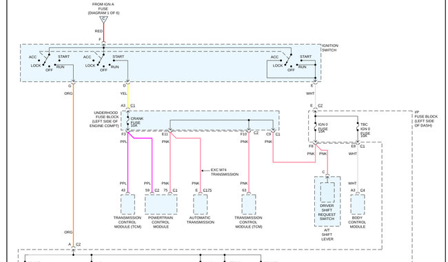

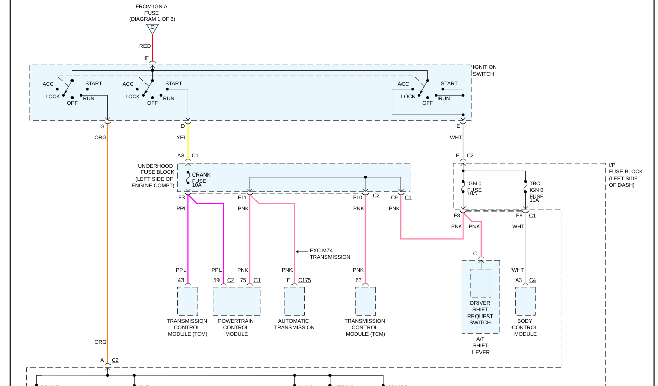

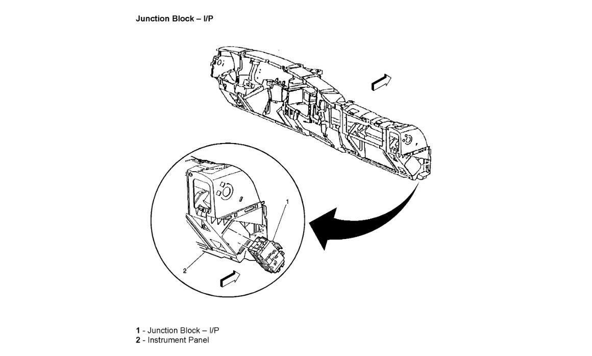

The blower motor circuit is a isolated circuit if the ABS light is coming on the problem could be a voltage drop at the junction block. Check the orange wire C2 terminal A for a voltage drop at the IP fuse block (it's the big wire) this wire runs from the ignition switch to the back of the IP fuse block. You will need to remove the block to access to the wires. Check the back of the fuse block for burnt or melted wire or wires. I'm attaching wiring diagrams and fuse block locations below. The wiring diagrams are into 2 hafts for easier viewing. Please let us know if this was helpful.
Thanks
Joe T.

Finally figured it out. Swapped out Ignition Starter Switch and blower works on all speeds as well as the ABS lights and service brake system gone. Thanks for all the help. Hopefully this will save someone some time down the road. - Joe
