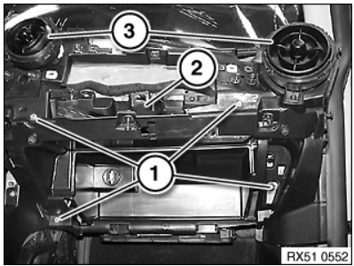

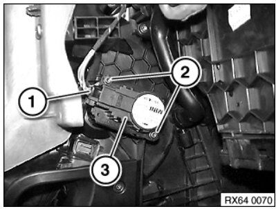

I am looking for a diagram of the actuator location and/or a tutorial video to replacement this part so I can have cold air for the spring, here in Florida

So which blend door are you looking for? I assume the temperature, you will need to remove the glove box to get at it. Check out the images (below). Let us know if you need anything else. Ken

Thank you, Ken! It is for the temperature. I’ve checked refrigerant and fuses-all good there. The car is only blowing HOTTTTT. are there any videos out there to help shoe me where all the screws are located to remove the glove box, I actually tried to start on that yesterday, but only saw the 3 screws across the top of the glove box…

Hmm, it looks like this might be a big job, here is what they show. Check out the images (below). Let us know how it goes.
