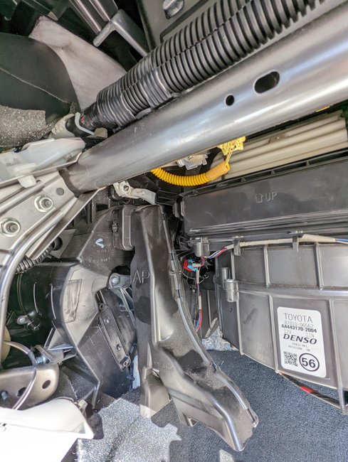

I recently noticed that when turning on the vehicle (Venza), the HVAC controls don't work (rear/front defrost, mode change, temperature, etc.,) and the word "auto" is shown on the screen. After 30-45 seconds, the controls work but the airflow is stuck to the front facing vents. Changing to front defrost or footwell doesn't provide any airflow to those locations.
I've searched online but the only mentions I've come across are about the airflow mixer/actuator and replacing that. However, that seems to be for people that have a problem where it's constantly hot or cold airflow. Would replacing the driver's side actuator help resolve the issue of the airflow not diverting to the selected option? Or is there another actuator that would need changing? Is there such a thing as a "mode" actuator?

Yes, they called it an air outlet servo motor here is the location in the images below. Check out the diagrams (below). Let us know what happens and please upload pictures or videos of the problem.

Well, got some bad news from the dealer. They checked the scanner for DTCS codes and there were none. They took apart the glove box area and confirmed that both actuators were ok meaning they saw movement. They said that they couldn't confirm if there's any damage to the HVAC blend door without removing the entire dashboard to access the HVAC control box. Which they said that if they're going to go that far, they might as well replace it (part# 87050-06581). The work would end up costing around $3200 CDN and both the service rep and I agreed that it probably isn't worth it considering that everything else still works just not the airflow direction.
Any other thoughts or suggestions or is this it? FTR, I did manage to take a look inside by the passenger area where they had taken things apart. I confirmed with the tech that he had seen movement on the air outlet servo motor, and he thinks that it's likely the vent flaps themselves on the inside that may be stuck or damaged.

Yes, I have seen the HVAC housing vent flap have a problem, so this is possible. I would have liked them to remove the actuator and move the pivot by hand to confirm the failure like in this guide to give you an idea.

So not much of an update. I took apart the glovebox area so I could have a better look at the blower motor and actuator area. I can confirm that when changing the air mode, the gears and pulleys don't move for the one up top which I believe is the air outlet control servo motor. I tried moving the gear and lever a bit, but it wouldn't budge. So, since I had this much access, is it possible to replace that part without tearing out the entire dashboard? Seems tight and I could see having to remove the blower and maybe the long air tube directing airflow downwards but is that piece even changeable? Also, what part number is it? I'm having a bit of a challenge finding the part. I think it's Toyota 87106-06250 but would love it if someone could confirm.

They don't give us the part number on this particular car for some reason, sorry. That is a tight fit to remove the servo motor try to remove as much as you can to get at it. Also, I noticed this car has a cabin filter, remove that to see if it is plugged.
