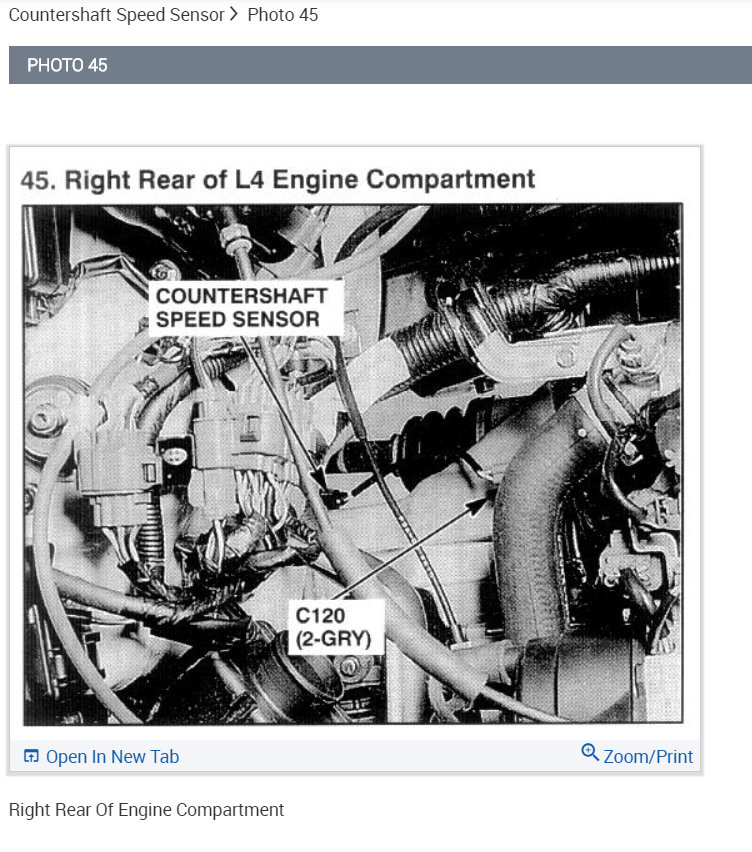

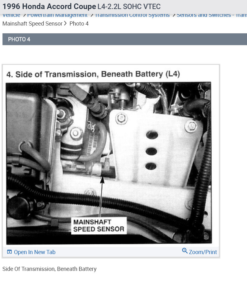

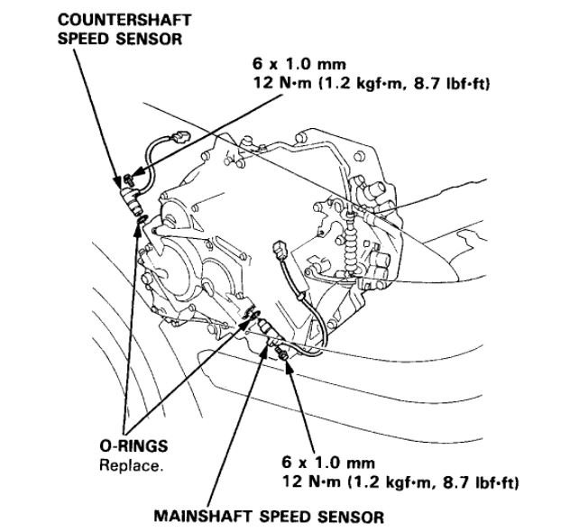

I have found a video for a 1997 Accord to replace the input turbine speed sensor. Does this also apply to 1996? If not, could I please get some information on how to replace and where the part in question is?
Nov 4, 2017 at 7:43 PM
Good morning,
I attached the location of the only 2 sensors for the 1996 Accord transmission.

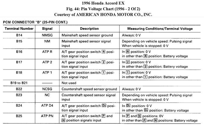

I have the 2.2 liter v-tech engine and when I drive it down the road it shifts fine until it warms up and then downshifts by itself to second gear. The trouble code was the turbine speed sensor circuit A. I tested the ohms on the input and output turbine sensors and they are both within 400-600 ohms. The check engine bulb has been removed by the previous owner but I don't know if that would have anything to do with it or not. I think the TCM may be bad but I need the check procedures to diagnose it correctly on the harness pins. Can you help me please?
Feb 25, 2021 at 3:29 PM (Merged)
KENNOR
The trouble code was P0715.

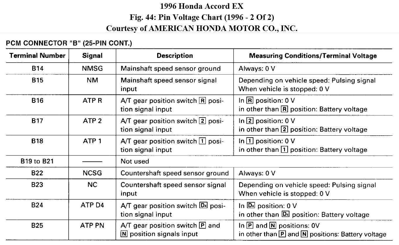

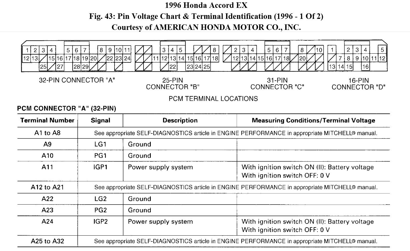

KHLOW2008
  • 41,814 POSTS

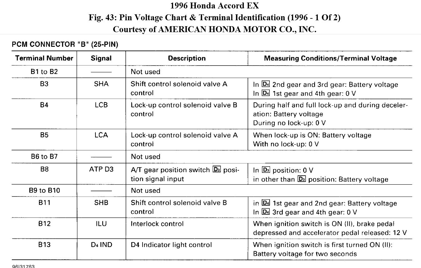

DTC P0715: (FLASH CODE 15) MAINSHAFT SPEED SENSOR
NOTE:
DTC P0715 (FLASH CODE 15) doesn't always mean an electrical problem in mainshaft speed sensor or circuit; this DTC can also be caused by a mechanical problem in transaxle.
1. Ensure mainshaft and countershaft speed sensors are installed properly. Disconnect mainshaft speed sensor connector and measure resistance between sensor connector terminals.
2. If resistance is not 400-600 ohms, replace mainshaft speed sensor. If resistance is
400-600 ohms, disconnect PCM 25-pin connector "B". Check continuity between ground and PCM 25-pin connector "B" terminals No. 15 (Orange/Blue wire) and No. 14 (White/Blue wire). See Fig. 43 and Fig. 44 .
3. If continuity exists, repair short to ground in Orange/Blue and White/Blue wires between PCM and mainshaft speed sensor. If continuity does not exist, reconnect
mainshaft speed sensor connector. Measure resistance between PCM 25-pin connector "B" terminals No. 15 (Orange/Blue wire) and No. 14 (White/Blue wire).
4. If resistance is not 400-600 ohms, go to next step. If resistance is 400-600 ohms,
perform DTC P0720 (FLASH CODE 9) diagnostic, check for loose PCM connectors and replace PCM with known good part, as necessary.
5. Disconnect mainshaft speed sensor connector. Check continuity of Red wire between PCM 25-pin connector "B" terminal No. 15 (Orange/Blue wire) and mainshaft speed sensor connector. If continuity exists, go to next step. If continuity does not exist, repair open Orange/Blue wire between PCM 25-pin connector and mainshaft speed sensor connector.
6. Check continuity of White wire between PCM 25-pin connector "B" terminal No. 14 (White/Blue wire) and mainshaft speed sensor connector. If continuity exists, check for loose PCM connectors and replace PCM with known good part, as necessary. If continuity does not exist, repair open White/Blue wire between PCM 25-pin connector and mainshaft speed sensor connector.

Here is a video of the sensors being replaced and the location of the sensors on a similar car for your car in the diagrams below
https://youtu.be/f3bETtCIdxM
