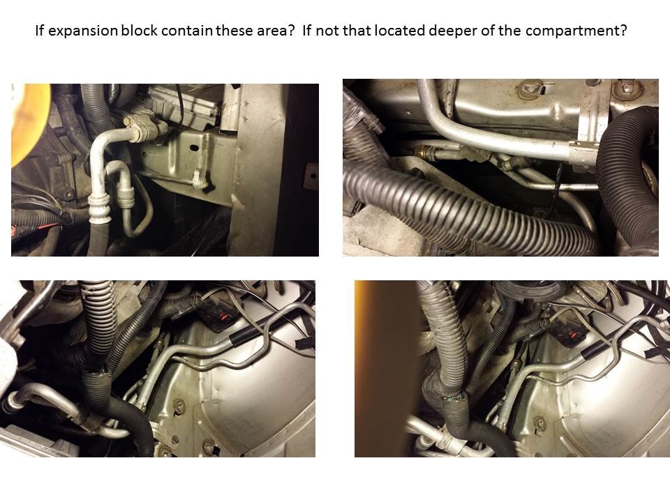

I was wrong that there was no orifice on my car, only have expansion valve instead of it. Where the expansion valve located? It is said to remove left lower quarter trim panel first by service manual.
Is it located on the front or rear of the car?
Is It locate at front of dashboard that I have to remove dashboard? Thanks for your help and instruction. What is technical difficulties?
If it contained these compartment?
Thanks!

There is no expansion valve in these images?
Best, Ken

You are kiding!
Aug 7, 2017 at 3:01 PM
  • CAR REPAIR CONTRIBUTOR
  • 54,328 POSTS
Can you use an arrow and show me what you think it is?
Aug 8, 2017 at 1:19 PM
XJSHEN
  • 251 POSTS
How can I see it when it was behind of engine compartment, and have to remove all dash board from inside of car. I removed dash board follow repair manual. I think you should know well about the fact, there was no expansion valve on my images.

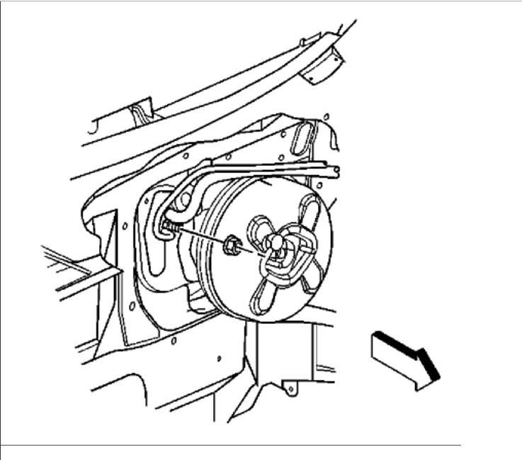

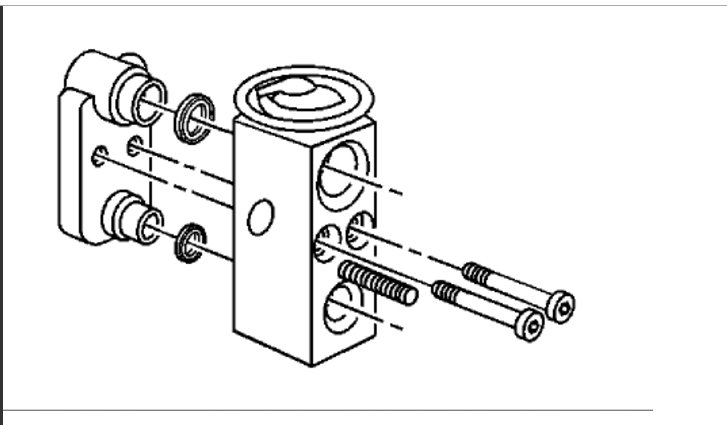

Hey,
Sorry for the confusion. Here is the location and some diagrams to help you get the job done. It looks like it is right by the brake booster.

Thank you for the help, you guys are the best!
Aug 13, 2017 at 2:57 AM
XJSHEN
  • 251 POSTS
fixed by removing dashboard and all front parts. cost $250.
