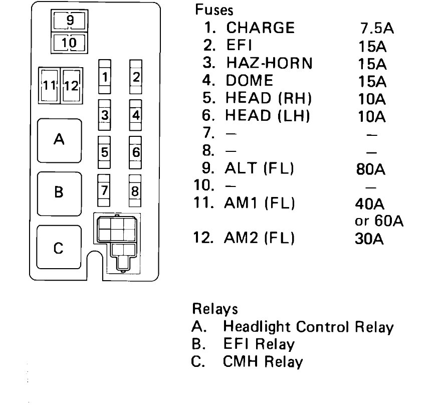

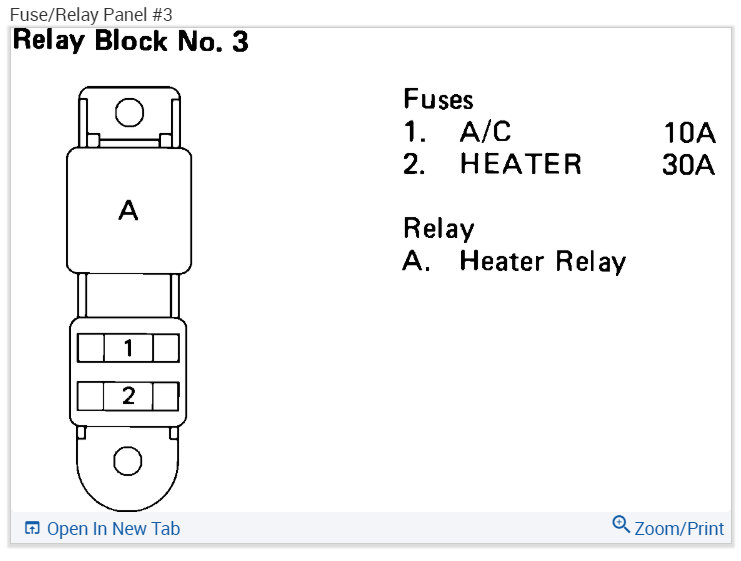

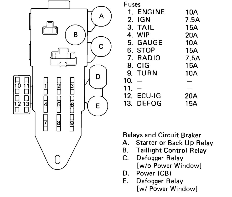

Speedometer is not working and also oil indicator not working. How to check the problem?
Monday, December 31st, 2018 AT 5:46 AM
KEN L
MASTER CERTIFIED MECHANIC
55,130 POSTS
Let check the cluster fuse (#5) first here is a guide to help us get started. The fuse location and identification are in the diagrams below.
Check out the diagrams (below). Please let us know what you find.
