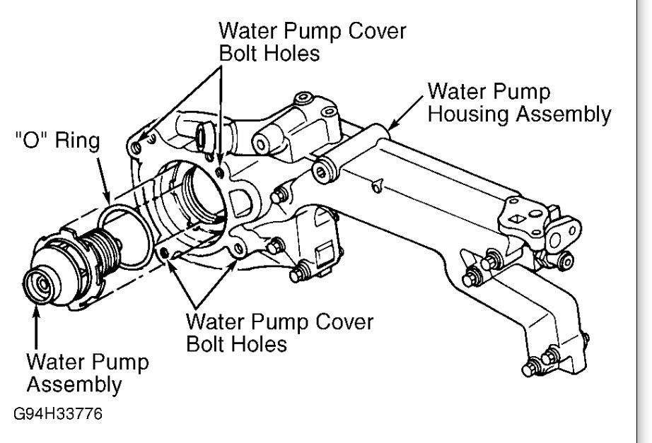

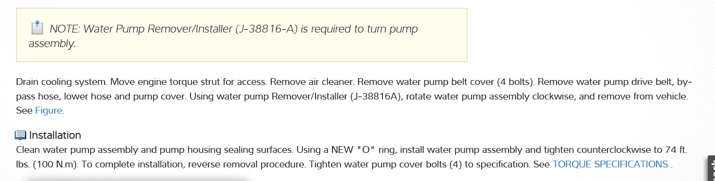

Cooling leaking
Monday, January 25th, 2016 AT 8:39 AM
HMAC300
MECHANIC
48,601 POSTS
If you don't need to remove water pump disregard that part.
