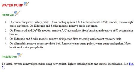

Hello! In dire need to know regarding the torque bolt adapters, do I need male or female for the ratchet for the water pump removal? Also is there ANY guide step by step you could please please offer me>? I do not have the money to purchase a guide and if you would please offer that step by step removal process I would truly appreciate it! I am a previous GM Cadillac Mngr and no longer have access to the guides or Svc Mngrs. So please ANY HELP WOULD BE WONDERFUL! I'm just a girl. Wink wink and want to install this myself! Thank you!

https://www.2carpros.com/forum/automotive_pictures/261618_Noname_877.jpg
FIG. 7
https://www.2carpros.com/forum/automotive_pictures/261618_Graphic_130.jpg
