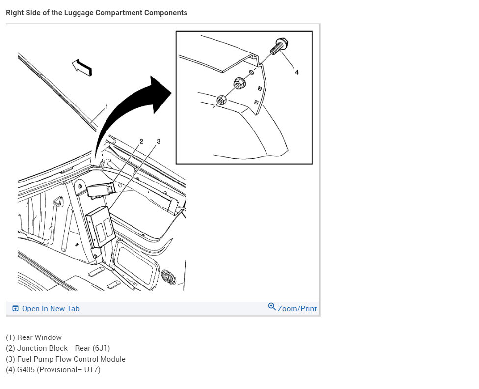

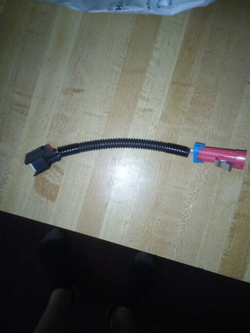

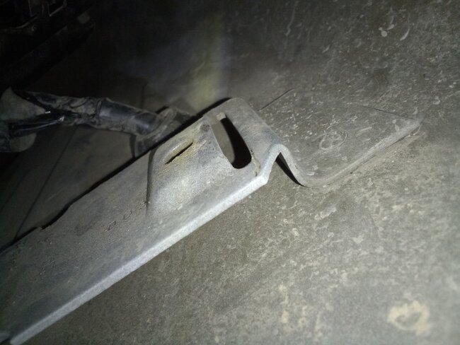

I recently changed my evap canister but not the wiring harness. Checked voltage with multimeter and nothing. I have a new harness I just can't get to the other connection. I've looked in trunk maybe you can help. I've included a pic that shows where wiring harness goes into car body.

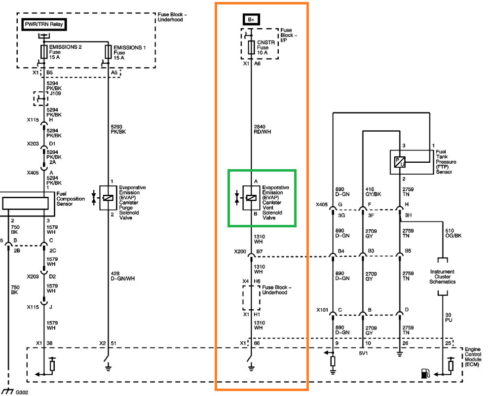

Did you even check the fuse to see if its blown (CNSTR FUSE)? Or check the resistance of the Vent valve? Youre going to replace the entire harness that runs all the way into the engine compartment fuse panel and then back to the ECM without knowing what the issue is.
This is the circuit youre dealing with, its 1 wire, if the fuse is blown, then check for a short to ground, this harness probably runs under the carpets inside the vehicle, since it runs up into the unibody.

No not the entire harness. I'm going to go check these out. When I bought a new canister, it came with an 8in wiring harness just the other end of it goes into car body somewhere not all the way up.

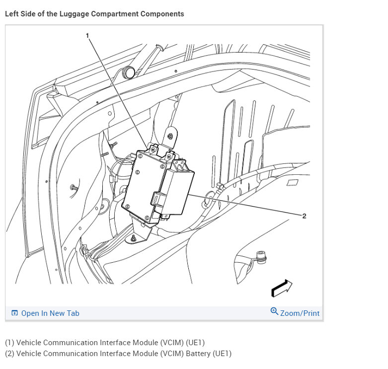

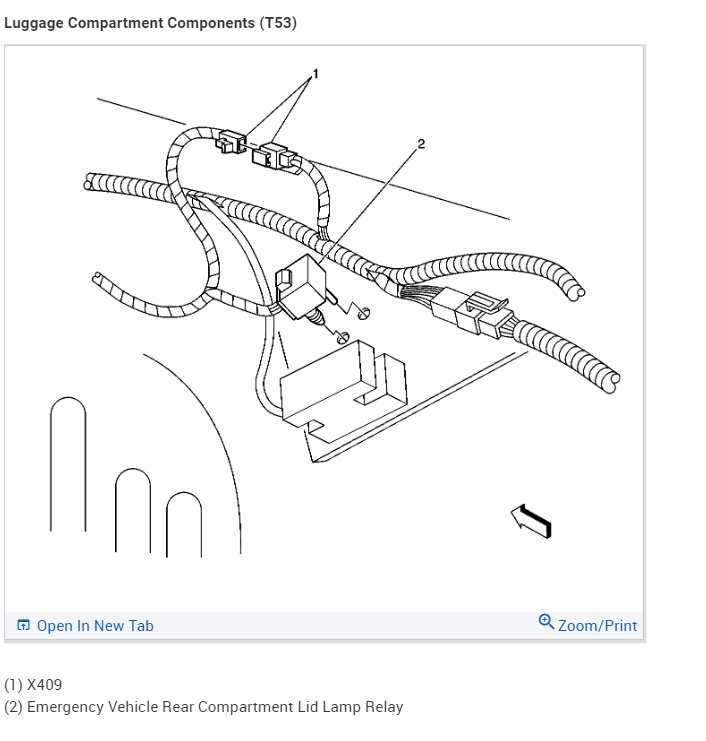

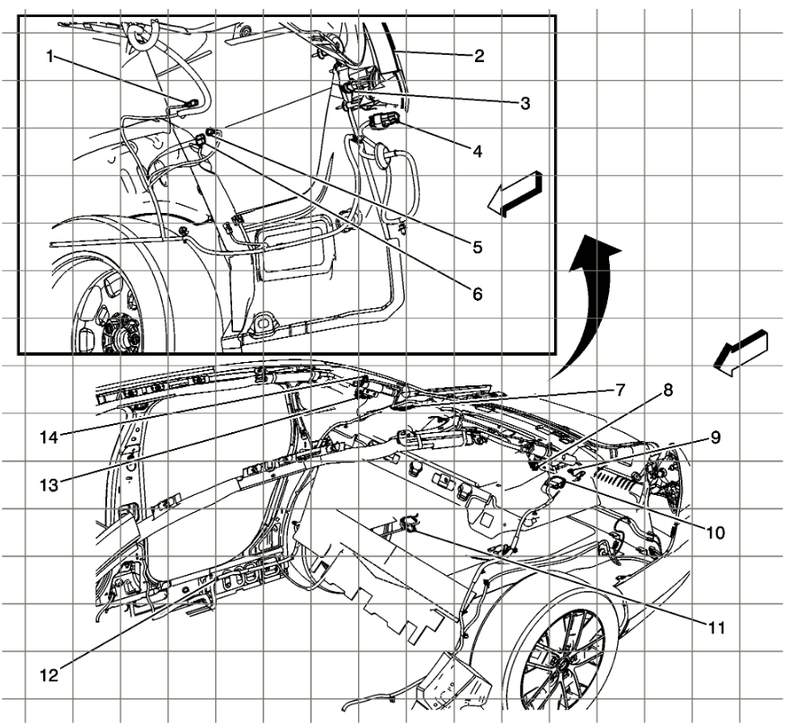

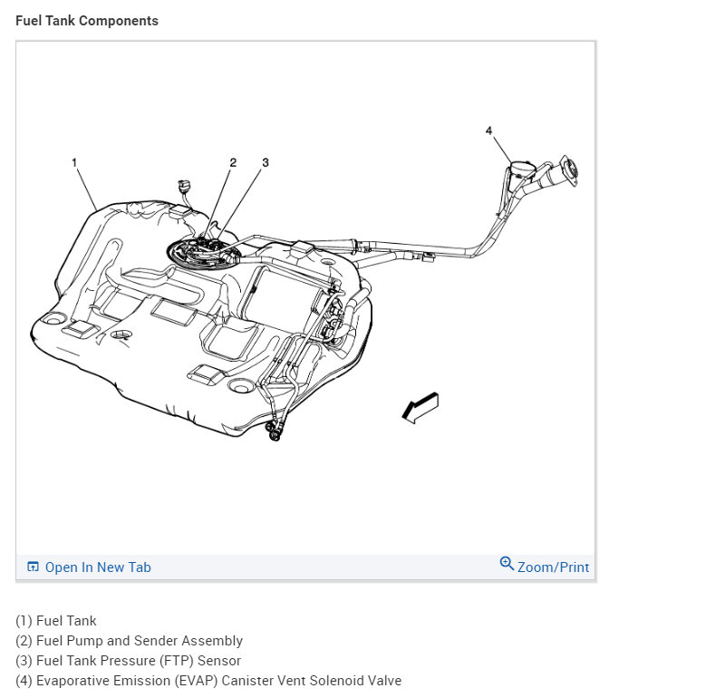

There should be a rubber grommet that the harness runs up into to prevent the wires from getting cut on the body, wherever that grommet is, is where you should be able to find it inside the vehicle. Are both wires in that connector? The diagram I posted is the OEM diagram. These are all the under vehicle diagrams I could find, if this vent valve is located near the filler neck such as the 6th diagram is showing, then the harness must run into the trunk area behind the trunk lining. On the side that the filler neck is.

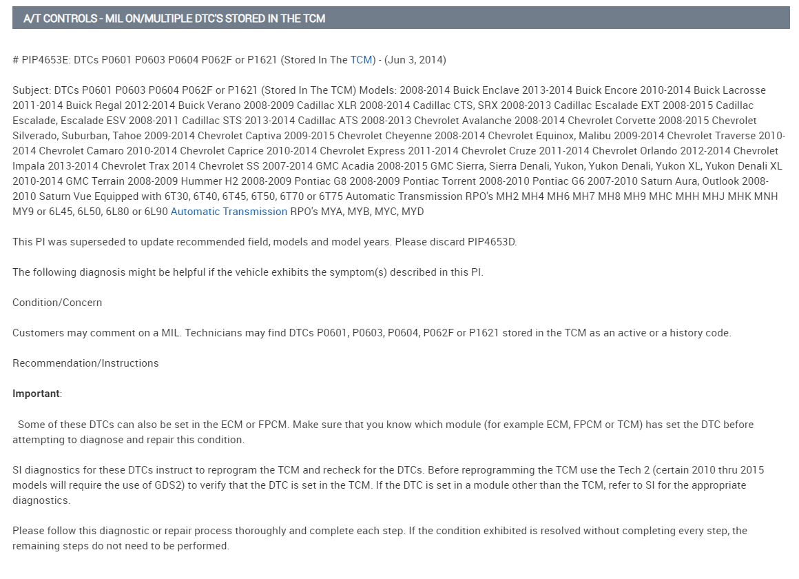

I posted on your other thread, let's stay on this one. Are you referring to the shifting issues? What I posted in the other thread is if you're going to want to continue repairing your own vehicles, it would be wise to invest in a higher end scan tool so you can scan the entire vehicle for any trouble codes, there may not be any codes stored in the ECM right now, but there might be some stored in the Transmission control module or other modules that a basic OBD2 scan tool cannot access. Those cheap code readers only scan the engine computer for codes, and modern vehicles have many modules in them, so buying a decent scan tool that can read live data from any module will be a huge help. That way you can see if any sensors or data readings look out of place, the ECM will try to compensate as much as possible before setting a trouble code, this is where learned values come into play, I use multiple scan tools as well as oscilloscopes, and a range of different multimeters and testing equipment. It's impossible to tell what might be happening with the vehicle if you have no codes for one, but also no way to see what the engine data is. A sensor can be bad and not set a code all the time, right now you're having shift issues, so it can be a problem in the transmission such as line pressure not being correct or electrical issue with the shift solenoids, none of these will show up on a basic Global OBD2 scanner.
Like I posted in your other thread the Autel mx808 is a less expensive scan tool, but it can scan all the modules in the vehicle, as well as some special functions, there's too many to list, Topdon is coming out with great scan tools now, I own their lowest level scan tool and it does all kinds of bi directional controls, such as activating components on the vehicle for testing.
Back to the vehicle, you mentioned having issues at 40 and 60 MPH, which might have something to do with the torque converter clutch lockup, or not unlocking when it should. Once you're at a cruising speed and the crankshaft speed and transmission input shaft reach the same speed, the torque converter clutch will lock up so it's a 1:1 ratio to help improve gas mileage, but once the engine rpm and transmission input shaft start to differ in speed the torque converter clutch should unlock. So, it might be an issue with the torque converter or the solenoid that controls it or even just the overdrive in the transmission. Here's a couple guides on transmission hard shifts and clutch packs slipping.

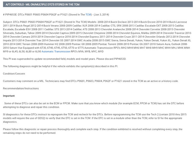

Also at the bottom is a link to the Autel mx808, this version is even better than the one I have right now. And the price has gone down at least $100. But you need to be able to see what the engine computer is seeing and doing, as well as scan the transmission control module for codes. The shifting problem has nothing to do with the Vent valve, I'll take a look for any TSBs or recalls on the transmission and post them here.

It sounds more like you might be having a transmission that is slipping more than an engine issue, you would have codes setting in the ECM if it's that bad, you would have misfire codes or something setting a code. Under heavier engine load, so when you are trying to jump on the throttle to get out into traffic, the transmission line pressure needs to increase as well. So, if there is low line pressure or clutch packs slipping you would have that kind of feeling like something wasn't catching. You can check the condition of the transmission fluid and see if it's brown and has a burnt smell to it. It should be nice and reddish and clear. But if you find there are no codes set in any modules, you can first check the live transmission data, it will show if certain pressures are not within range. next would be having a shop check the transmission line pressure and doing a brake torque test to see if the pressure is where it should be.

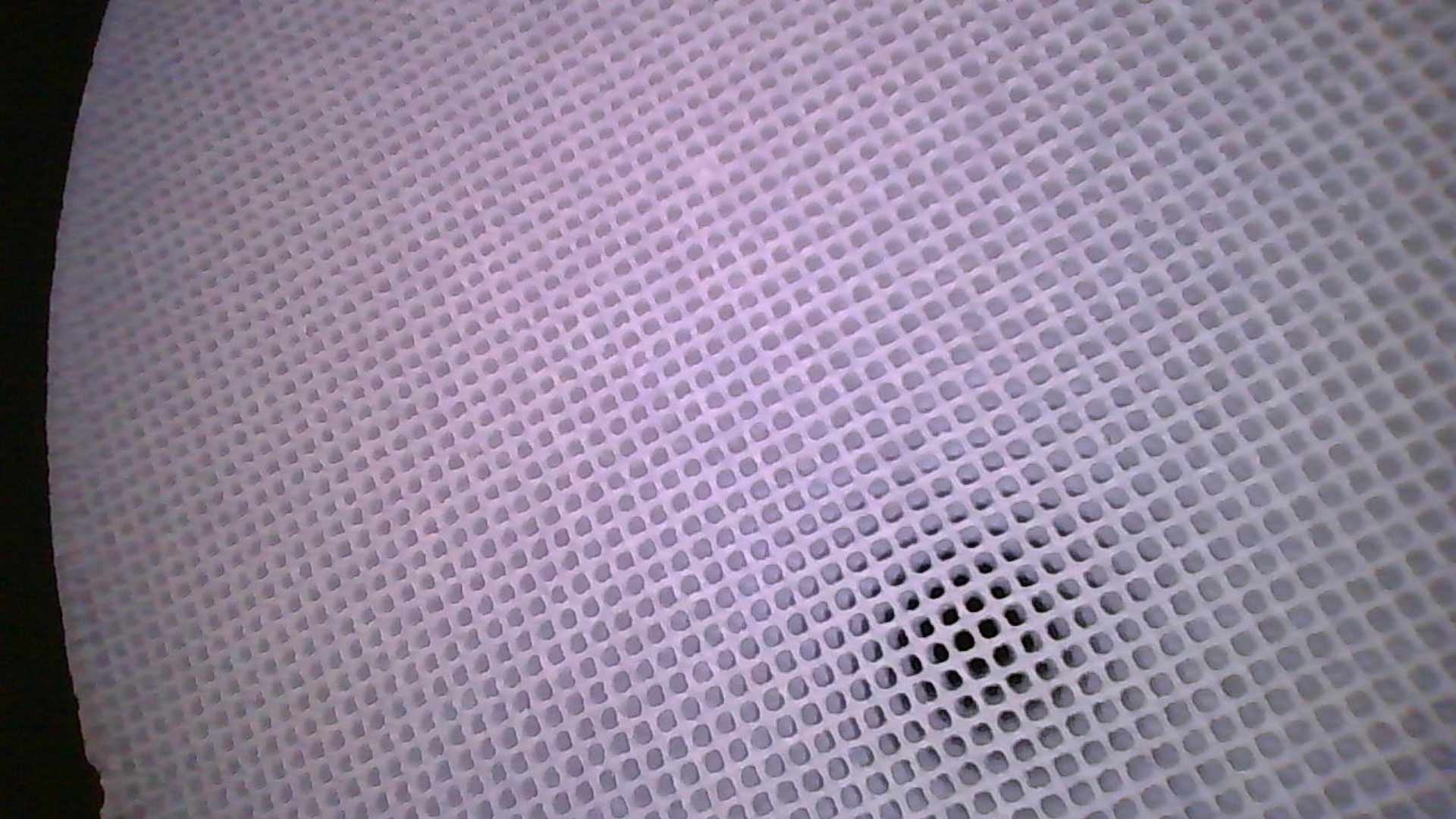

I wouldn't worry about buying any oscilloscopes. unless you are referring to the digital inspection camera. I use mine all the time, I used it yesterday to inspect a Catalytic Converter with the front oxygen sensor out of the exhaust. This is an example of that, although my borescope is a different one, it's still the same idea. They can be used to look into cylinders, there's many applications for them.
Here is a guide on transmission issues, but I would really expect to see codes setting in the ECM if this was more of an engine problem, especially on a 2013. The ECM is capable of setting codes for so many components when it comes to engine performance. If the engine rpm is jumping up but the vehicle is not moving, really sounds like transmission problems, Temperature would definitely have an effect on that as well. On flat level road you don't need to have such high transmission line pressure as you would going up a hill or trying to get out of the way in traffic. But start with checking for codes in the TCM.

I think you're going to have to look into the transmission at this point, if there was something effecting engine performance that much there would be codes setting, you can try AutoZone, but I don't think their scan tools can access any other modules besides the engine control module. I believe they just use a basic OBD2 code reader. Nothing fancy. You could stop at a local shop and ask them to just do a full system scan for you and see what codes show up in other modules. That will at least give you some direction.
