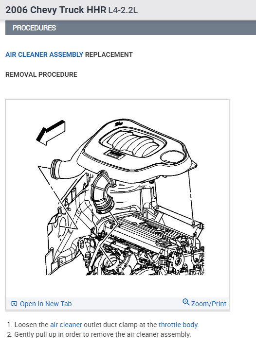

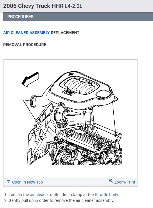

Idles fast.
Wednesday, June 29th, 2022 AT 8:48 PM
SQM
MECHANIC
6,383 POSTS

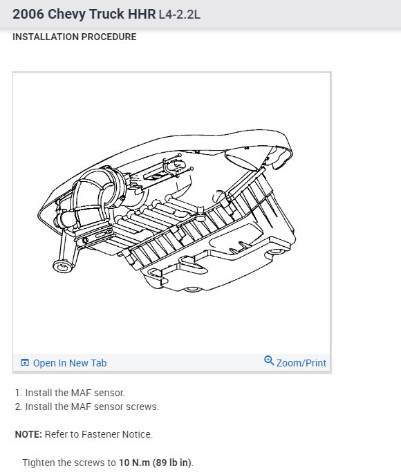

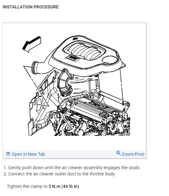

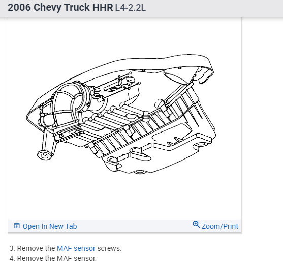

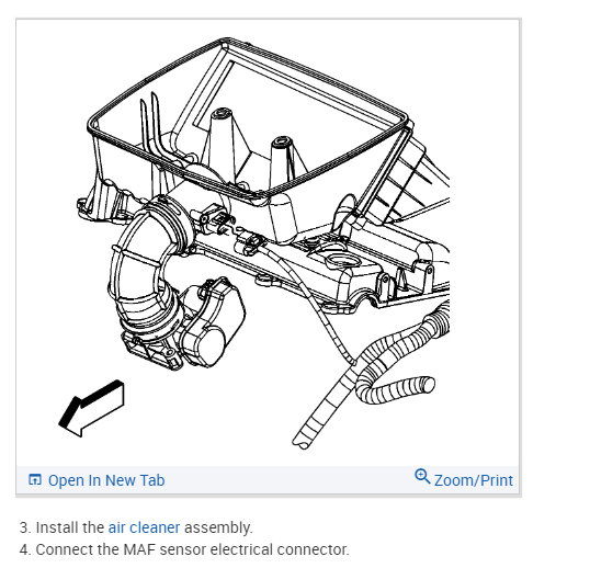

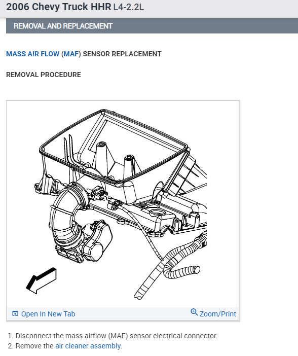

An engine can idle high due to a vacuum leak as well as loose intake tube, also could be due to the throttle body.
What exactly are you experiencing?
https://www.2carpros.com/articles/engine-idles-too-high
https://www.2carpros.com/articles/replace-an-air-intake-boot
I have attached the diagrams below for your reference.
Let me know of any questions.
