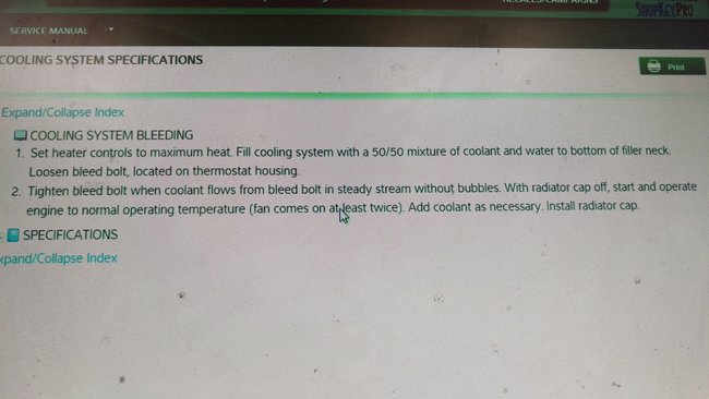

Car running hot, new hoses, new water pump.

So you have a air pocket? Is the radiator fan working correctly?

Fan is working correctly.

There you go
Image (Click to make bigger)
