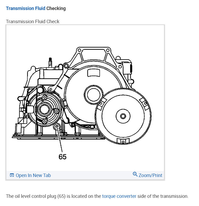

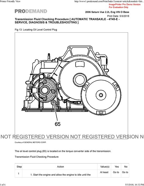

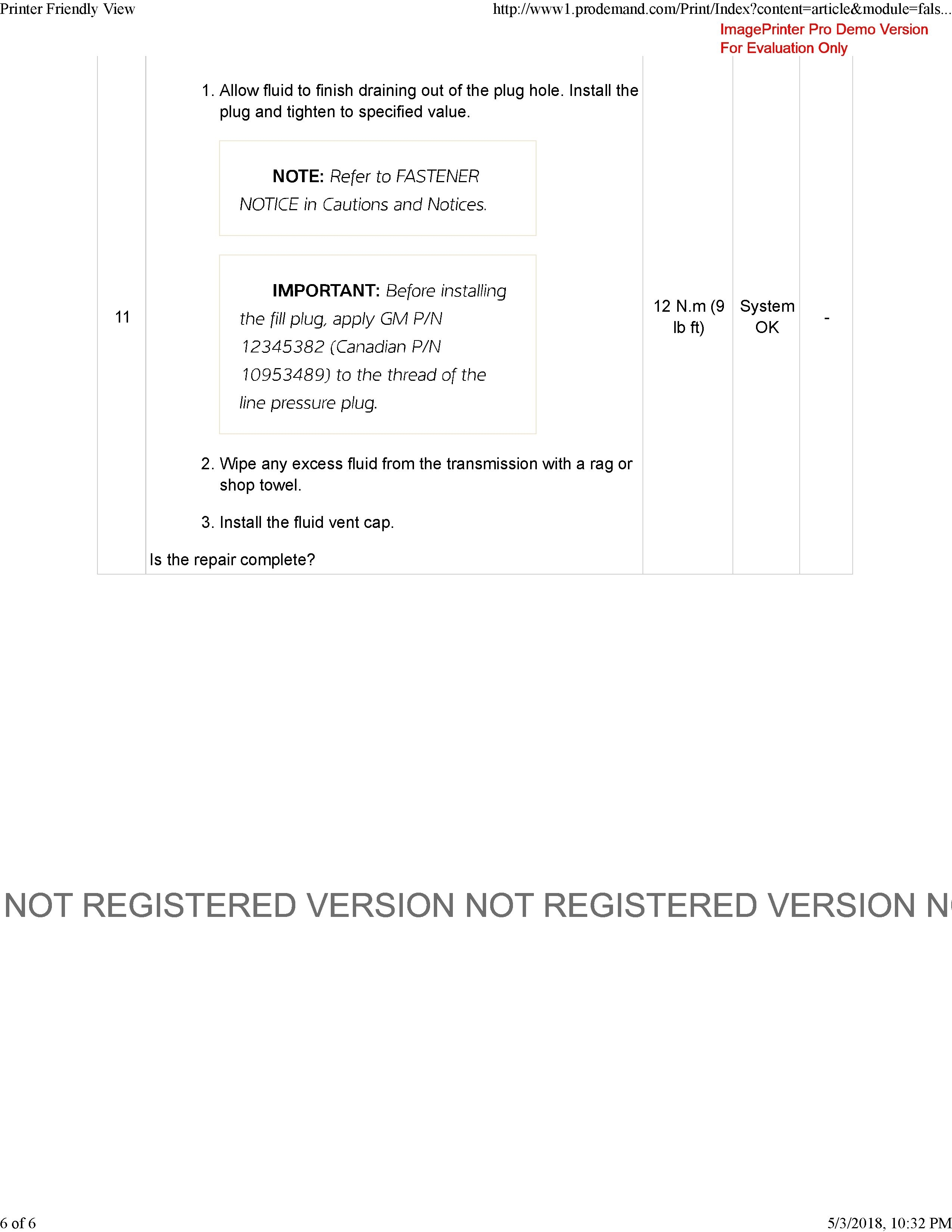

how do i check transmission fluid and if its low how do I fill it. There is no dipstick. also my saturn might be a 2.2 if that matters. please tell me how rto check and add T- Fluid to my saturn
Nov 7, 2015 at 11:57 AM
SATURNTECH9
  • 30,869 POSTS
Hello

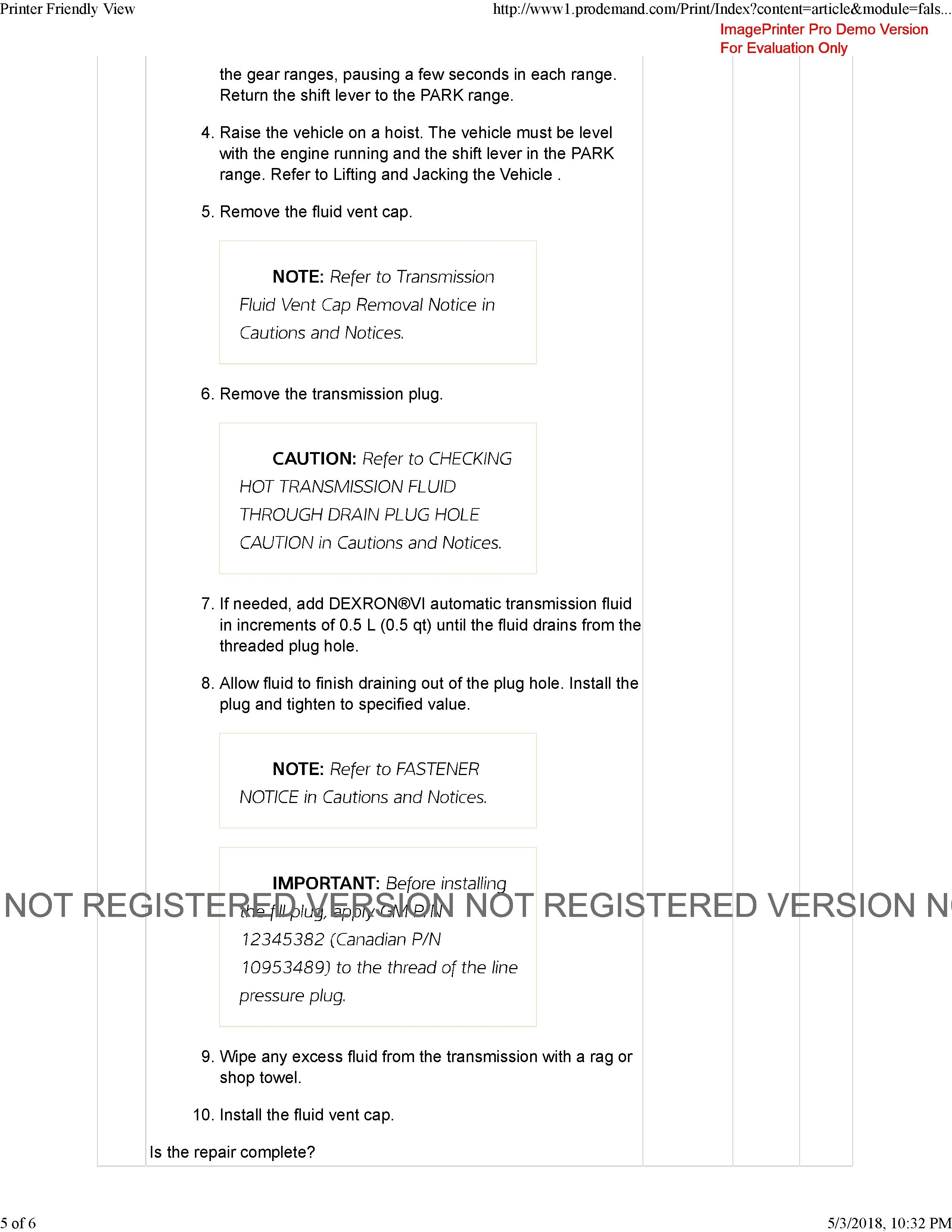

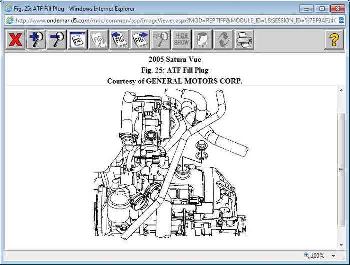

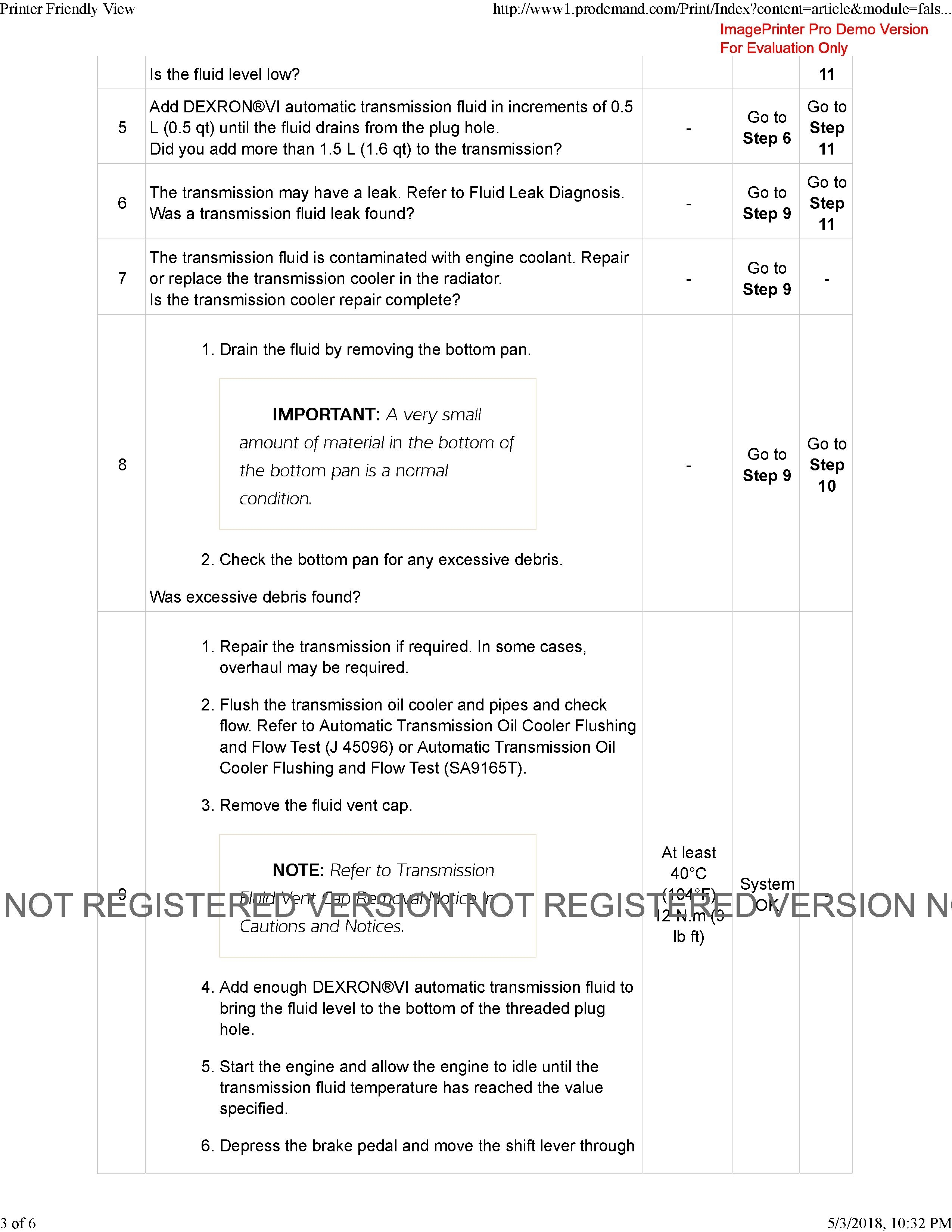

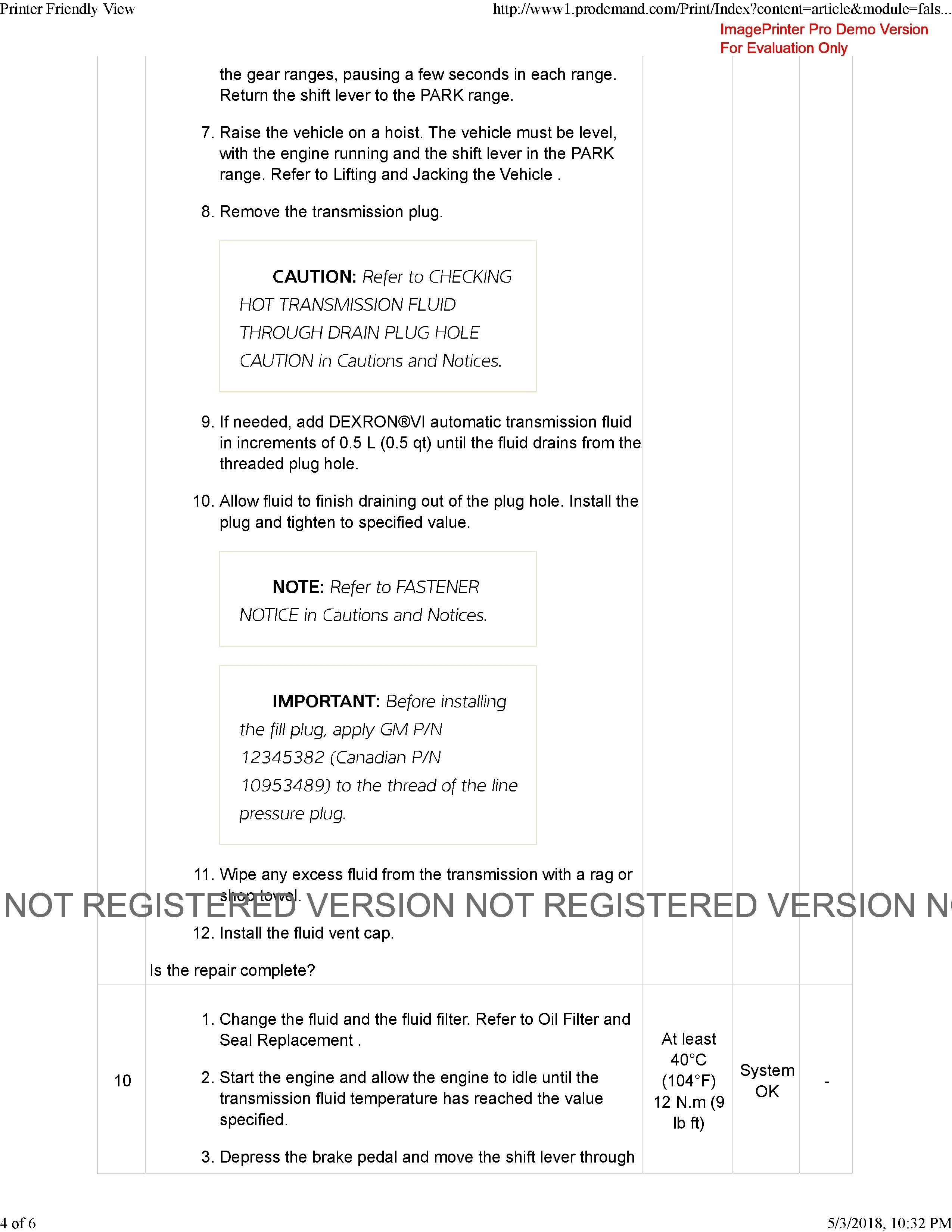

The fluid level plug is on the side of the transmission which is checked much like a stick shift, with the engine running fill until it comes out here is the plug location in the diagrams below.
Fluid Types
AUTOMATIC TRANSAXLE FLUID
ATF Z1 Automatic Transmission Fluid (Saturn Part No. 22717466).
Capacities
4T45-E Automatic Transaxle
AUTOMATIC TRANSMISSION 4T45-E
Bottom Pan Removal .................... 6.5 liters (6.9 qts)
Complete Overhaul .................... 9.0 Liters (9.5 qts)
Dry .................... 12.2 Liters (12.9 qts)
Measurements are approximate

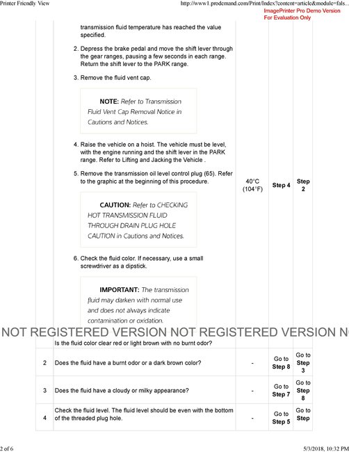

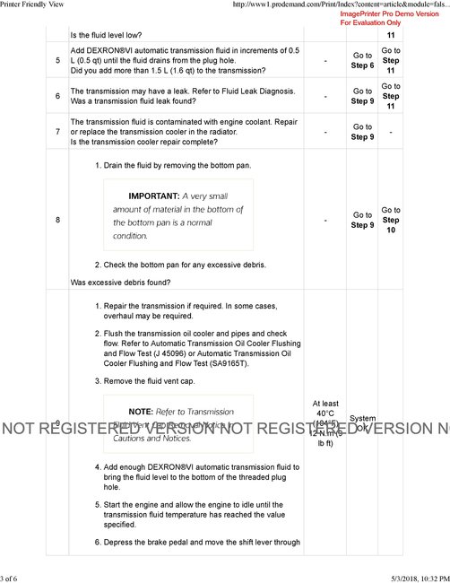

You noted that you are trying to check your transmission fluid, but you also say that you have a manual transmission. If your Vue is a manual, then you do not have transmission fluid. You have gear oil, and a lack of it is most likely not your issue. Your issue would be a worn out clutch pressure plate, which is normal given the vehicle mileage.
If your Vue is an automatic, then there is no dipstick to check the fluid level. Instead, there is a bolt on the side of the transmission that you have to take off to check the level. Basically, you put the car on a lift, take the bolt off, and stick your finger in there. If you get fluid on your finger, then no more fluid is needed. If not, then pump some fluid into said hole until it leaks out. See the images below for more in depth explanation.

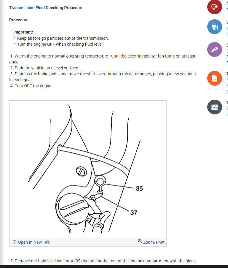

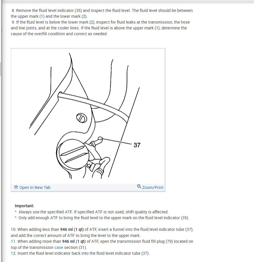

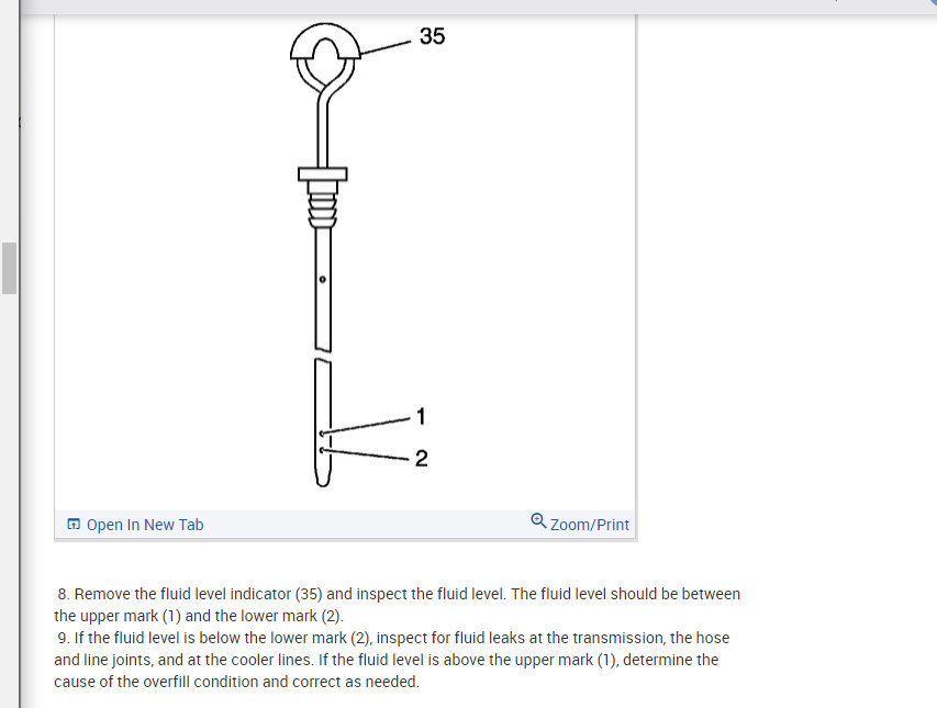

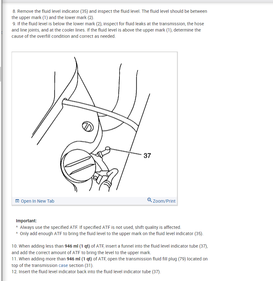

Hi and thanks for using 2carpros.com. I agreed with the above statement however, you could have the 5 speed unit. If you do then you will have a dipstick. Take a look at this video that will help with checking fluid this way.
https://youtu.be/D7bgOjIRMMw
Then please see the info below from the manual on how to check the fluid on this unit.
I hope this helps

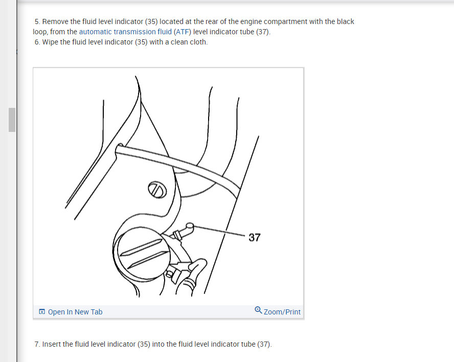

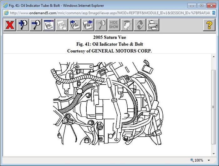

i was changing out the radiator on my 2005 saturn vue 3.5 v-6 and lost some transmission fluid what kind of fluid and i think there is a fill hole on the top of the transmission , will it have a dip stick there also thank you
Dec 31, 2019 at 11:00 AM (Merged)
FIXITMR
  • 9,990 POSTS
On the driver side of the vehicle, on the top of the transmission, there's a plastic yellow thing with a picture of a gear with liquid in it (indicating transmission fluid), that's your transmission dipstick. The only other yellow plastic piece that you can see is your oil dipstick. The tranny dipstick is bolted down with a 12 mm bolt that you'll have to remove. After removal of the bolt, just pull the dipstick straight out to check fluid level. The dipstick may be a bit harder to pull out than you imagine, but as long as you took that bolt off, it'll come out.
The transmission that's in your Saturn was not intended to be checked by the owner. The theory is that you'll check your fluid when it's not up to temp, think its low, and add more, overfilling your transmission. However, I think most owners would prefer having a more easily accessible dipstick. Even if it's only to check the color of your tranny fluid. You should also make sure that the fluid doesn't have a burnt odor.

SATURNTECH9
  • 30,869 POSTS
Just to add to this one i posted the location of the fill hole and the dipstick.It uses atf-z1 fluid.

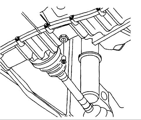

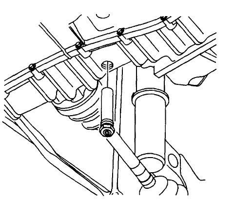

How drain the automatic transmission fluid CVT onthe car listed above?
Dec 31, 2019 at 11:05 AM (Merged)
STEVE W.
  • 15,172 POSTS
Draining it is easy, refilling it is the problem.
First you need the correct CVT fluid and the CVT additive. These are not common fluids or universal types, generally they are dealer only items.
Fluid = Saturn DEX-CVT P/N 22688912 Additive = Saturn DEX-CVT P/N 22697447
And a new lower tube drain plug
Next you need a scan tool that can read the transmission temperature. That is because it gets filled by temperature.
The drain is located on the trans near the axle. But it is two parts, there is a plug in the middle and a tube that the plug screws into. You remove the plug first. Then remove the tube. That lets the fluid drain out. Now to refill you replace the long tube first, torque it to 20 Nm (15 ft lb). Now install the smaller drain plug finger tight.
With the vehicle flat and level, add 6 quarts of DEX-CVT fluid.
Now start the engine and hold the brake. Shift the trans into reverse for ten seconds, then into drive for another ten seconds. Now back into park. Leave the engine running. That circulates the trans fluid around the system.
Next go under the vehicle (keep it level, if you are using a jack you need to jack both ends, if ramps use them on both ends, or use a lift) and remove the small drain plug. If fluid runs out in a steady stream, let it run until it stops. If no fluid runs out, add fluid until it starts to run out.
Once the fluid stops you install the new lower tube drain plug and tighten it to 11 Nm ( 97 Inch lb)
