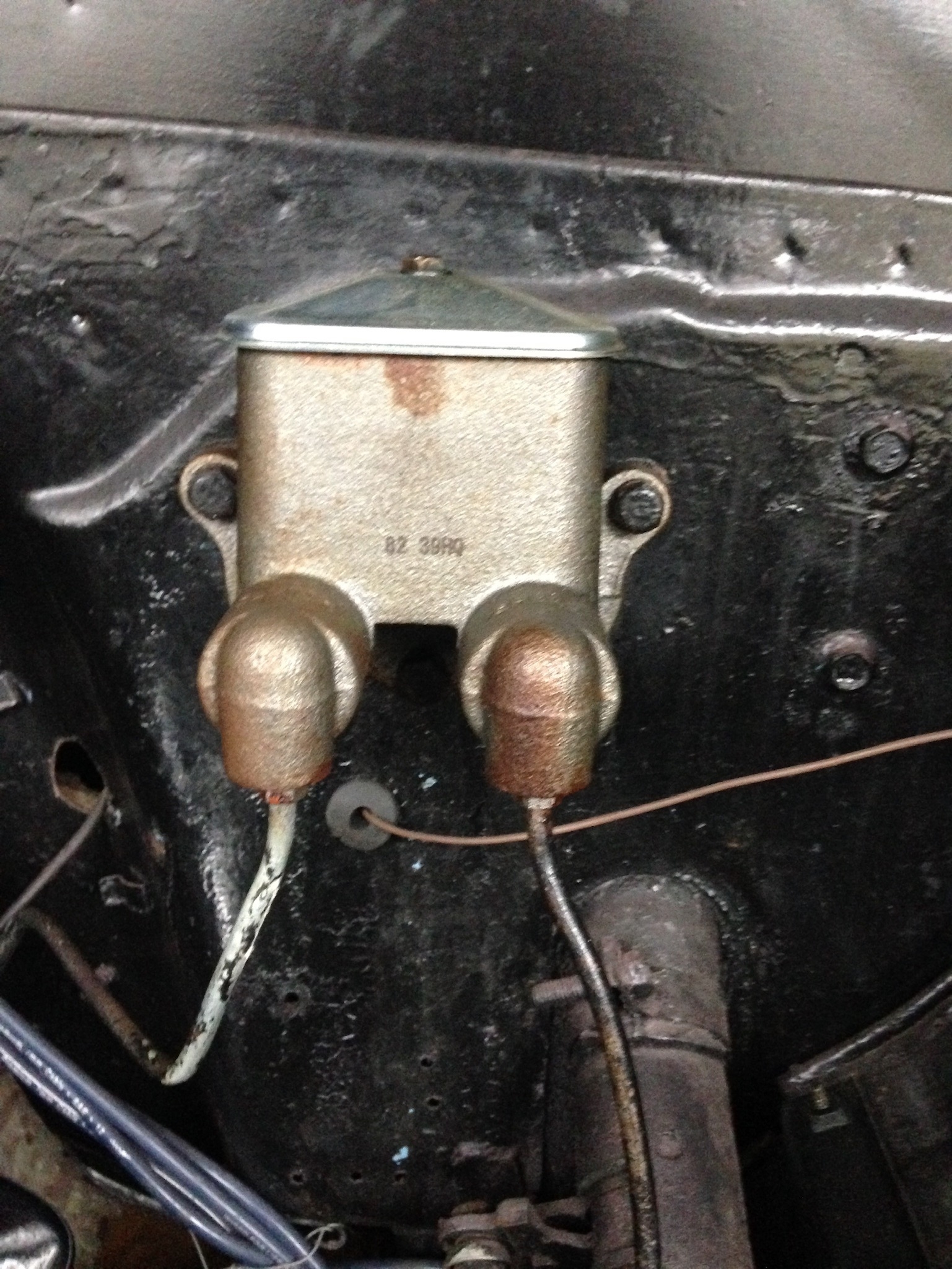

Hydraulic clutch using 1961 OEM master hooking up slave cylinder and trams from 1995 Chevrolet clutch pedal very strong pressure when letting out pressure constant all the way up and out.

Good morning,
Are you still using the single action master cylinder? If you are, then it will not work.
You may need to install a separate clutch master cylinder for the system to work correctly. The original does not have the check valves for releasing the pressure as the dual action cylinders have.

Do you currently have a single action or dual action cylinder?

Don't know. Clutch is using original 1961 dual master cylinder one side is for brakes and one side for clutch.
Monday, December 17th, 2018 AT 4:11 PM (Merged)
What size truck is this?
Can you post a picture of what you see?

Stick shift for 1961 uses linkage.
You say there are two sides to the master cylinder? The OEM has only one line coming out of it, not two.
That is why I need a picture.

Here it is:

Who added that master cylinder?
That will not work. It is for brakes and not a clutch set up. You will need a separate master cylinder just for the clutch separate and away from the brake master.
In the newer cars, the fluid from the master cylinder for the brakes feeds the clutch master but no one uses a brake master cylinder section for clutch movement.
