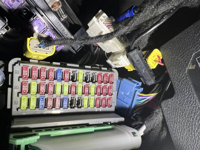

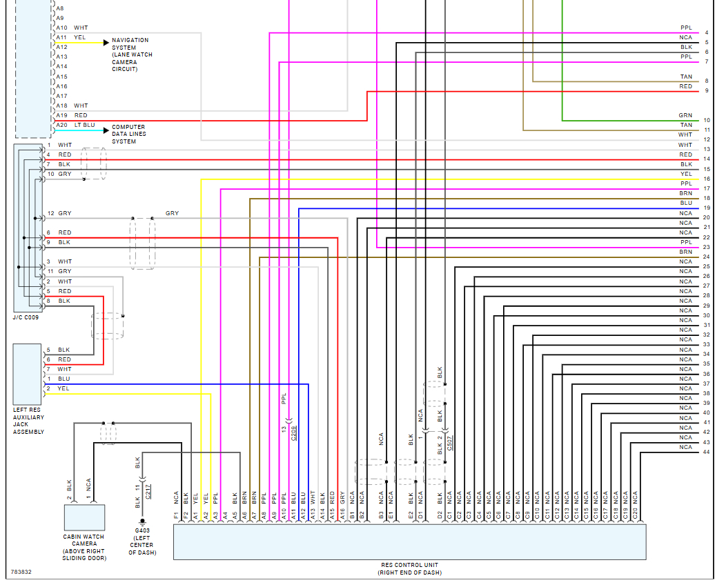

Hello!
I have the vehicle listed above Touring that the turning signal, hazard lights and also back up camera alert sounds all don’t function!
I’m assuming it’s a problem with a fuse, but I’m not sure as I don’t have schematics!
Any help would be appreciated!

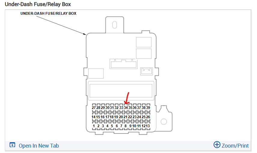

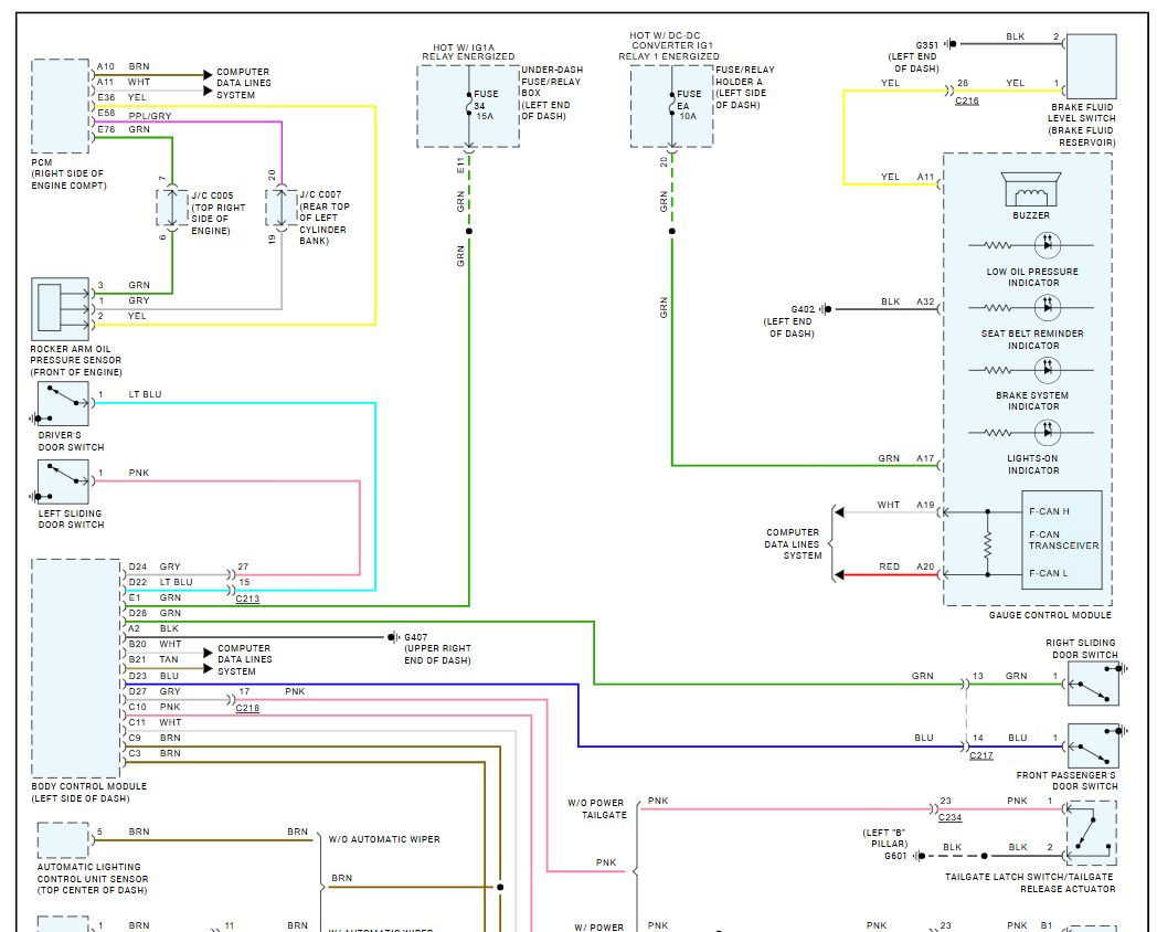

The warning systems all go through the BCM which might be having an issue, I would disconnect the battery overnight to help reboot the system. Also, check fuse # 34 and fuse EA in the fuse panel on the left side of the dash.
Here is a guide to help:
If the fuses are good and the battery disconnection does not work, I would run a CAN scan. You can get a CAN scanner (Controller Area Network) which will work on most cars from Amazon.
https://youtu.be/u-4syLc-ifQ

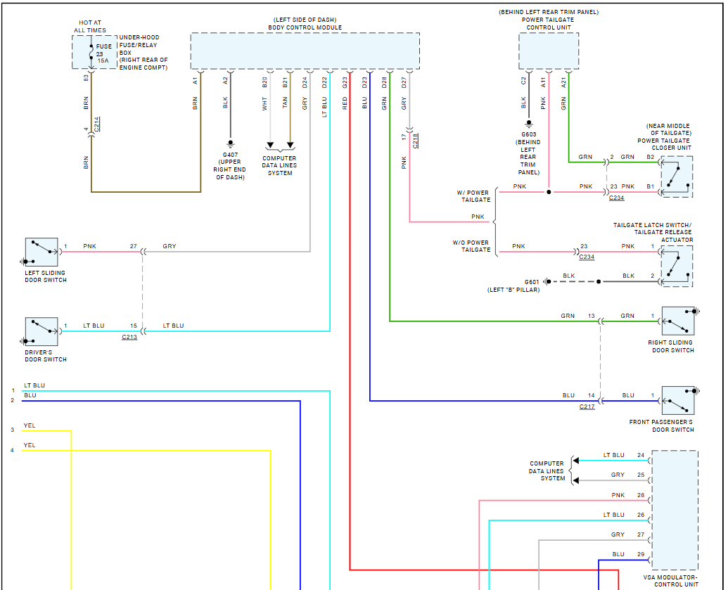

Here are the fuse locations to help you. Check out the images (below). Please let us know what happens. Here are the warning system wiring diagrams so you can see how the system works.

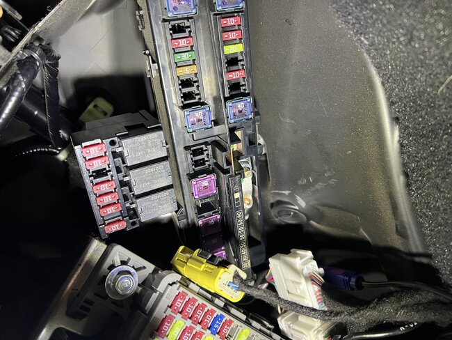

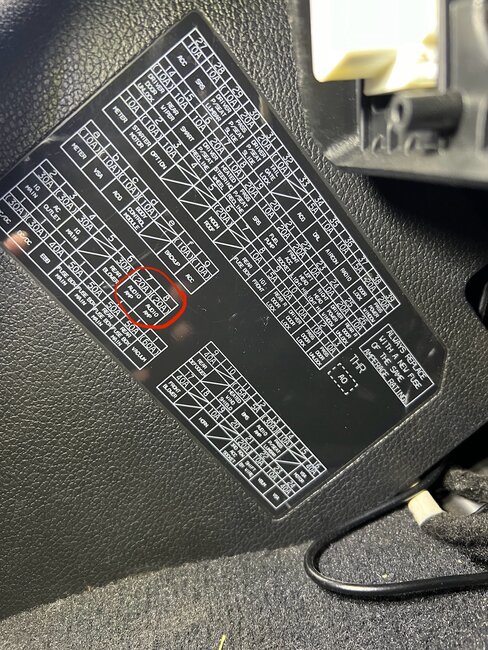

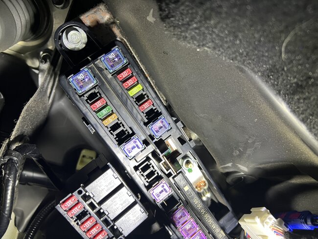

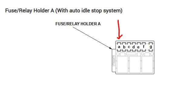

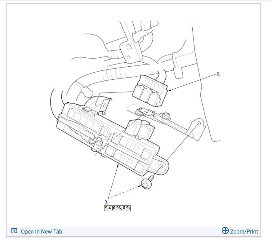

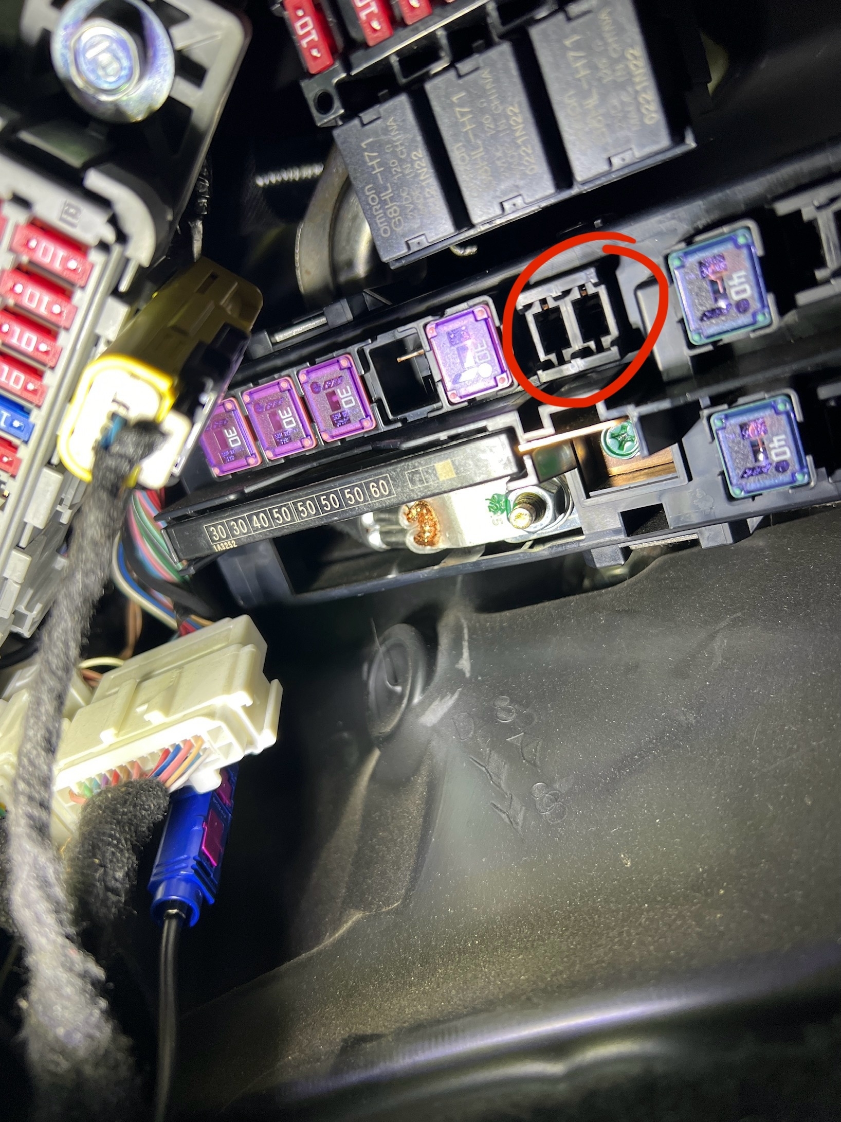

I went under the dash and tested the 2 fuses you mentioned #34 and “a”. Both were fine. I then went to the legend at the side of the car and saw 2 20-amp fuses named audio amp. Looked at their sockets and both were empty. So naturally I went and bought 2 20-amp fuses and replaced them. Still nothing lol I also noticed that the rear side door for the passengers doesn’t make a sound either. Maybe another fuse is bad? Or missing?
For reference I’ve added all the other fuse holders under dash.

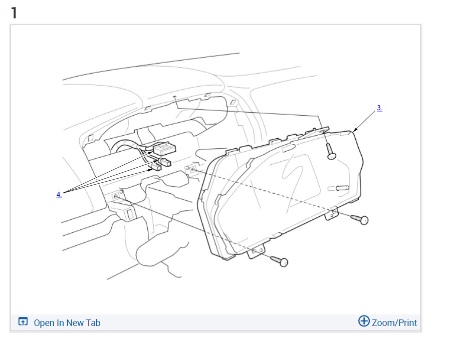

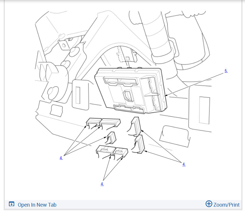

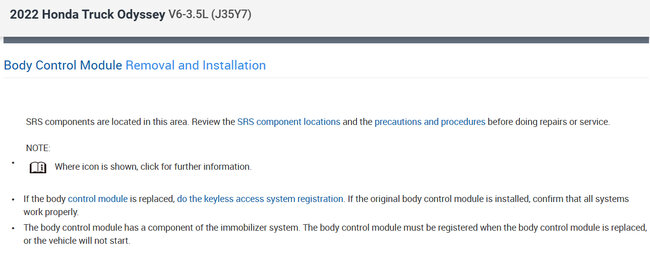

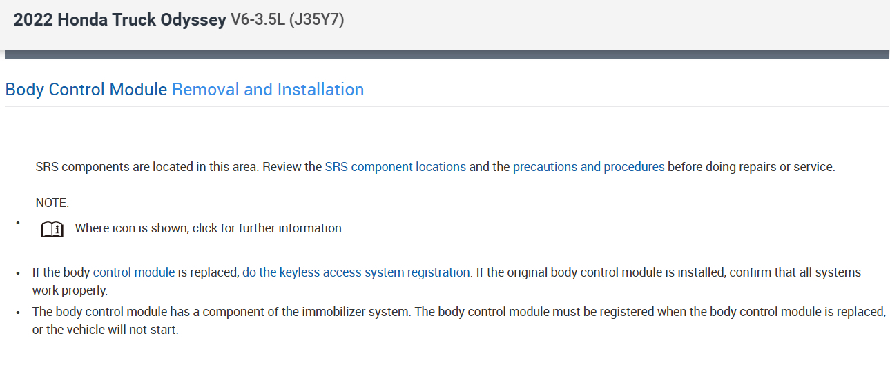

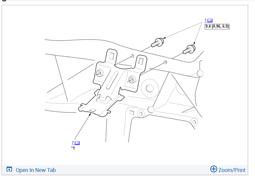

Thanks for the images. The sounds alerts come from the radio speakers, and since you say the radio works, I think the BCM has gone out, but we should do the CAN scan now which should report a code for the BCM to confirm the issue. Please go over my first post to see how to do the scan. Here is how to replace the BCM which you can get a preprogrammed unit by searching Google or Ebay in case a code is present for it. Check out the images (below). Let us know how it goes.
Nov 14, 2024 at 10:01 AM

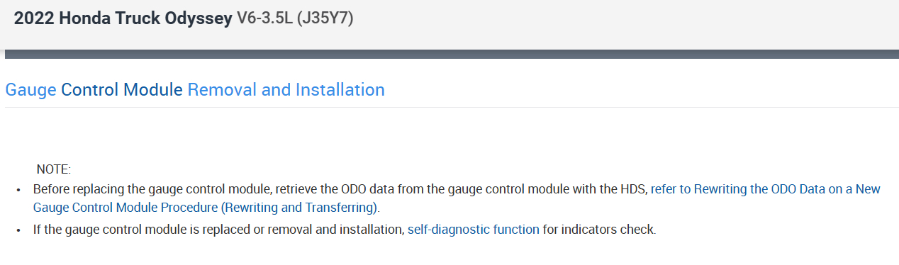

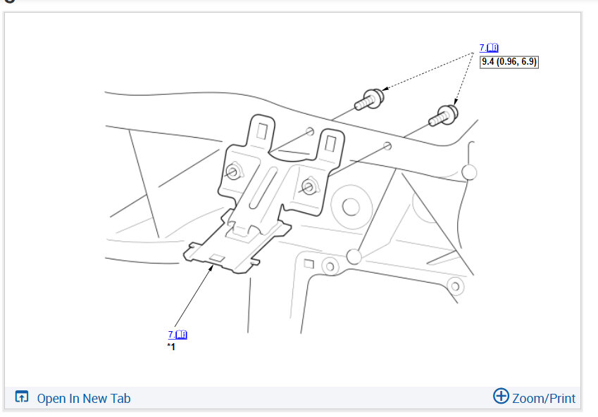

So, it looks like this sound transducer has gone out inside the cluster which will need to be swapped out, you can get a preprogrammed unit by searching Google or Ebay. Here is how to swap the cluster out to help fix the problem. Check out the images (below). Please let us know what happens.

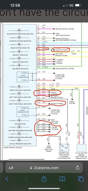

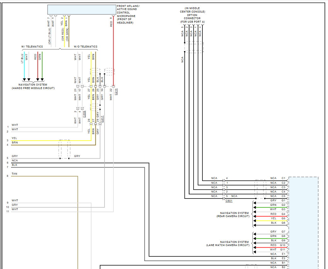

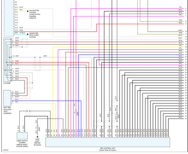

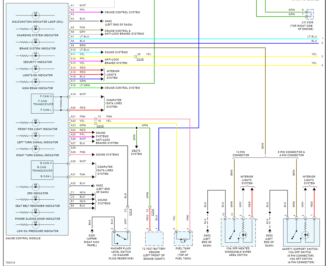

Before I order and re-program the new cluster, I wanted to check the transducers wires to see if they read a resistance, or if they are open. Would you by any chance have the wiring schematics for the sound transducer in the dash? And. if the wires go to where all the fuse boxes are under the steering wheel? I’m thinking maybe something happened to one of the pins or something was disconnected.
Thank you again for all your help.
I really appreciate you!
Nov 15, 2024 at 11:23 AM
FLIGHTS5628
  • 12 POSTS
I will try to run a CAN scan as well today!
Nov 15, 2024 at 11:24 AM

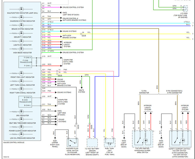

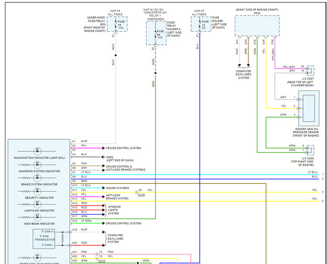

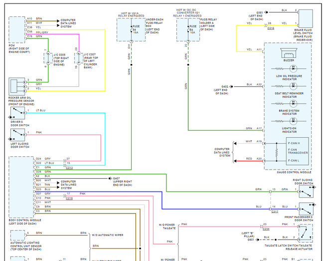

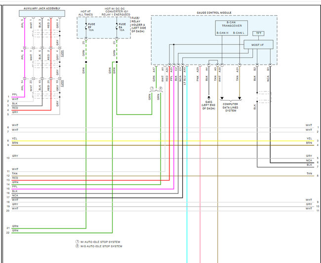

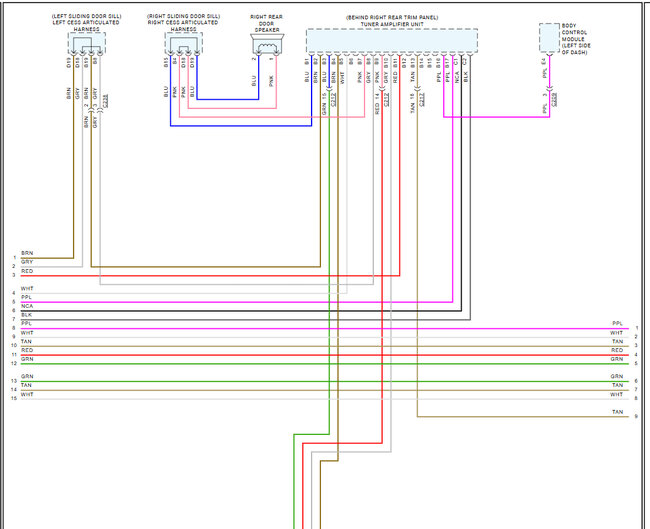

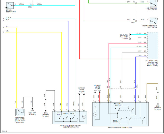

  • 54,520 POSTS
I don't have the circuit board diagram, but I do have the wiring diagrams for the cluster if that can help. Check out the images (below). Let us know how it goes.

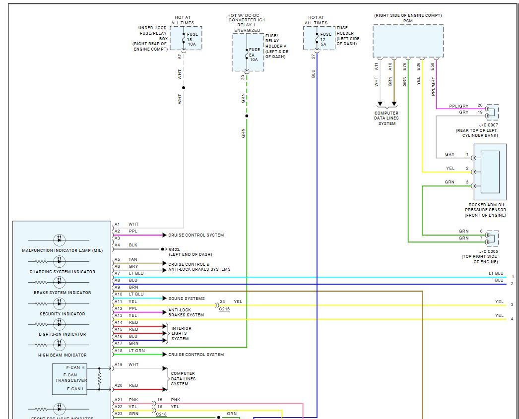

FLIGHTS5628
  • 12 POSTS

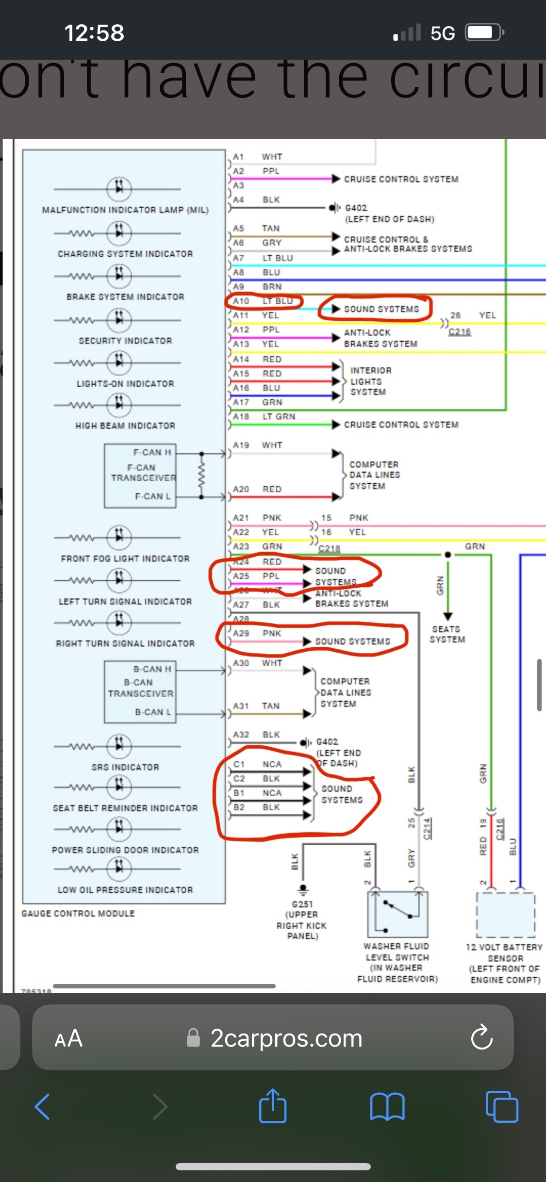

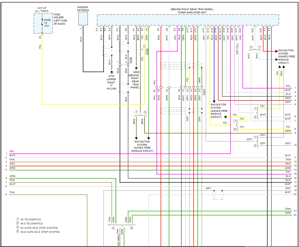

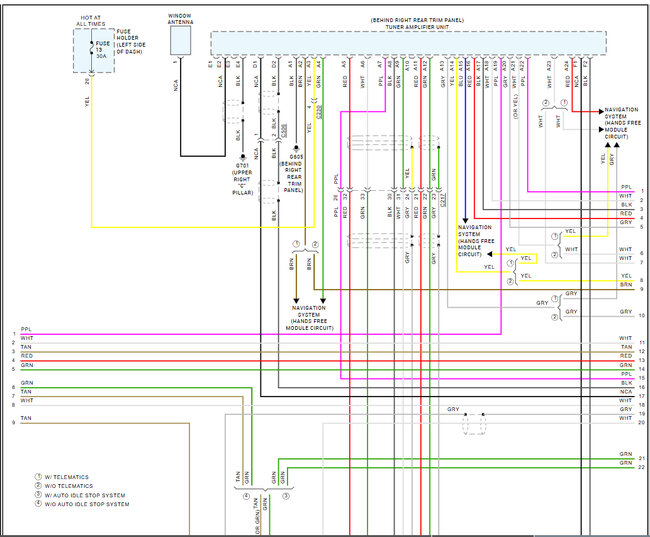

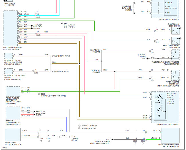

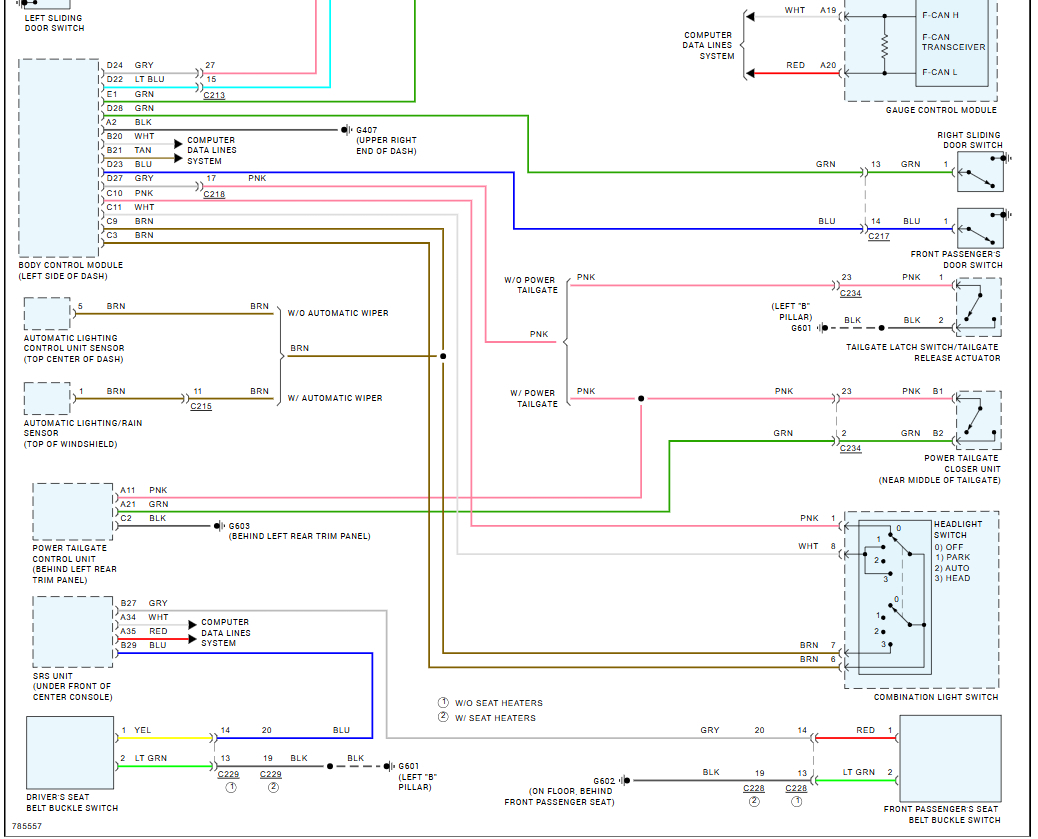

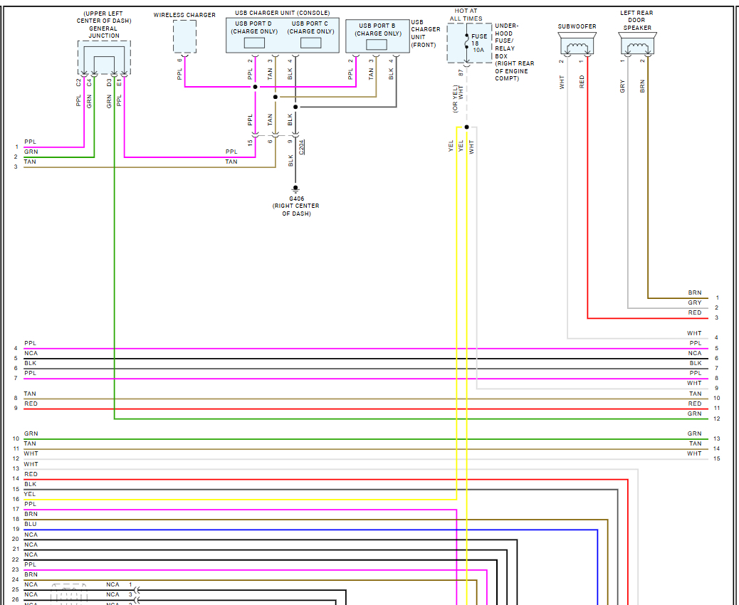

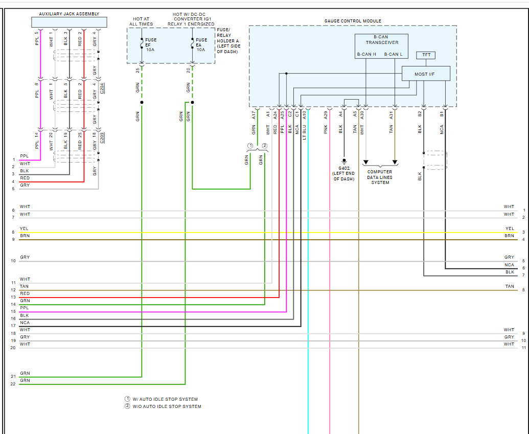

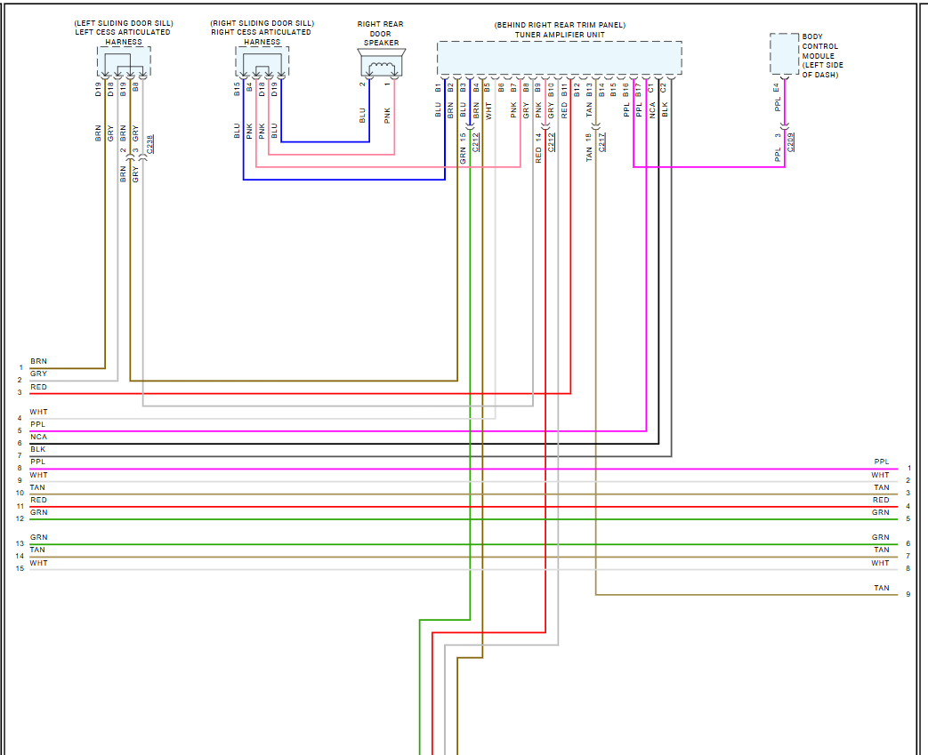

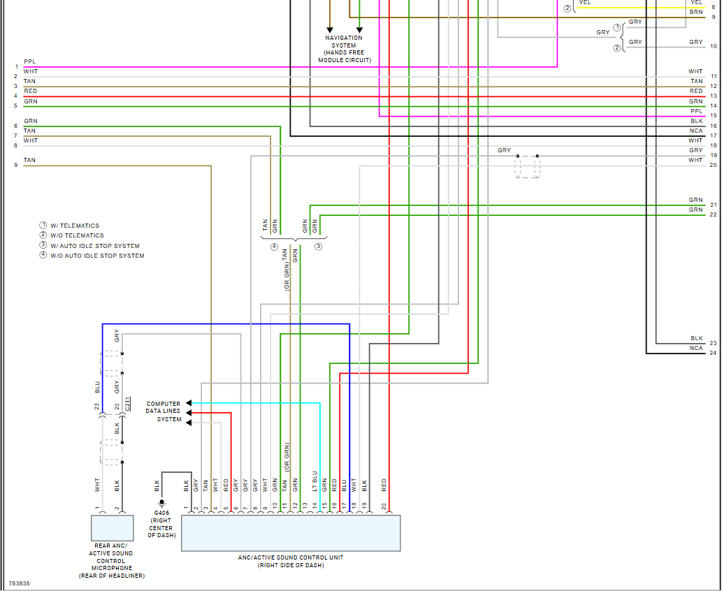

I looked at the wiring diagrams and I see 4 places that the gauge has a wire running to sound systems. Unfortunately, it just says the wire goes to “sound systems”. Do you by chance have the wiring diagram of the sound system that comes from the cluster? I’ve attached the photo you sent me circled in red all the points of mention of “sound systems”.
Thanks again
Nov 16, 2024 at 10:03 AM
FLIGHTS5628
  • 12 POSTS
Here is the photo.
Nov 16, 2024 at 10:05 AM

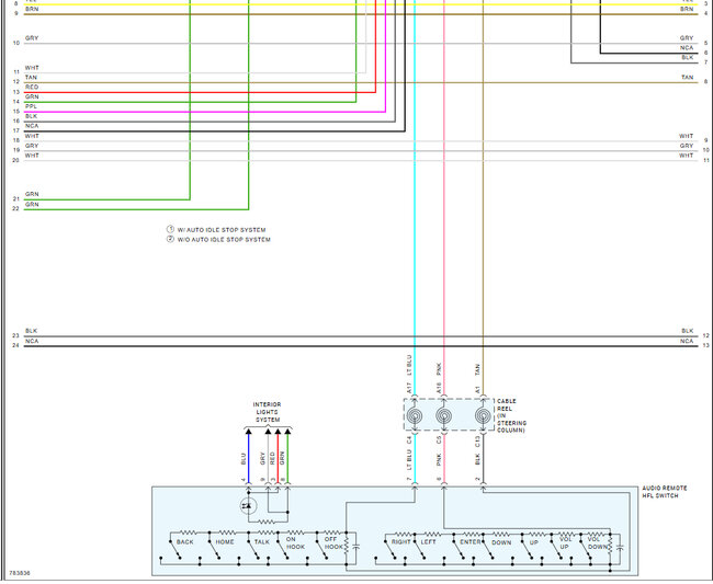

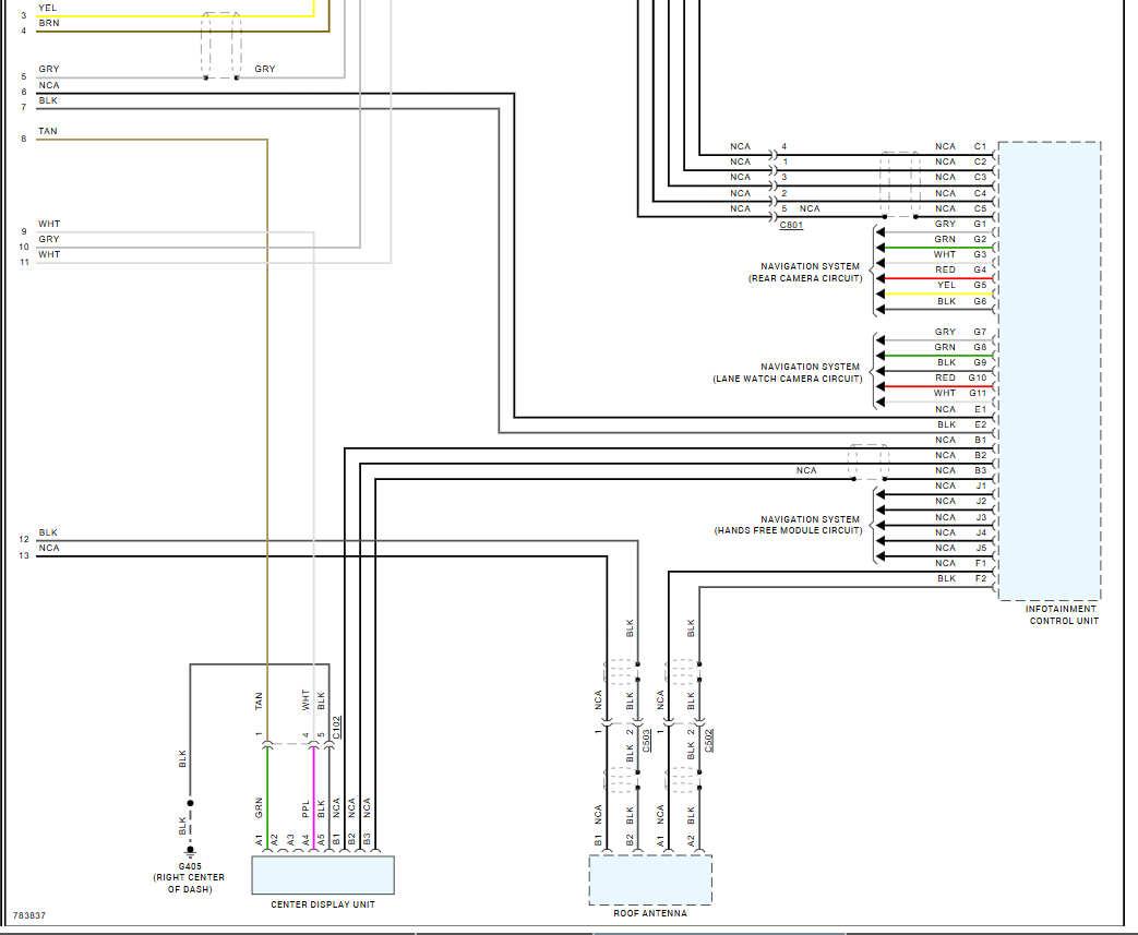

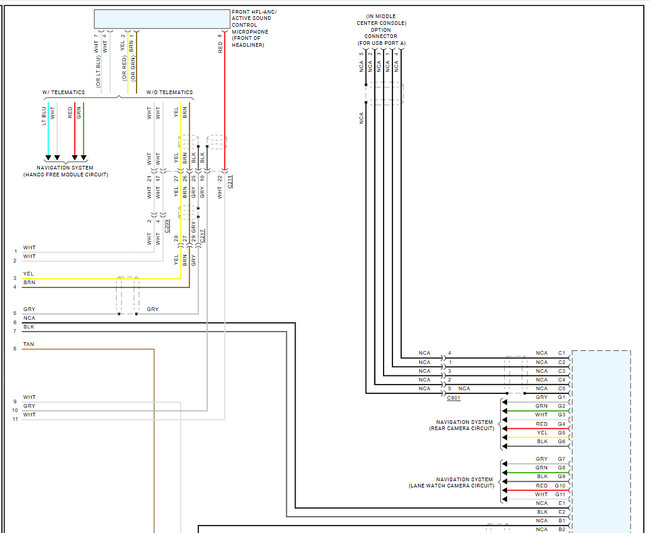

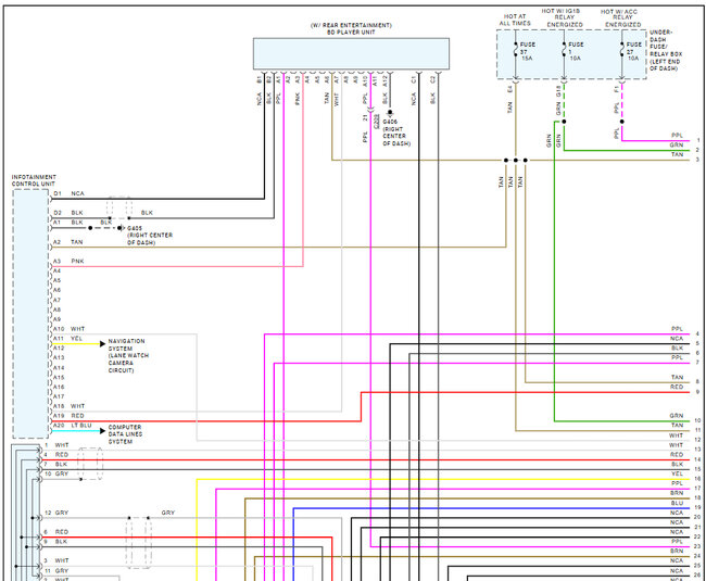

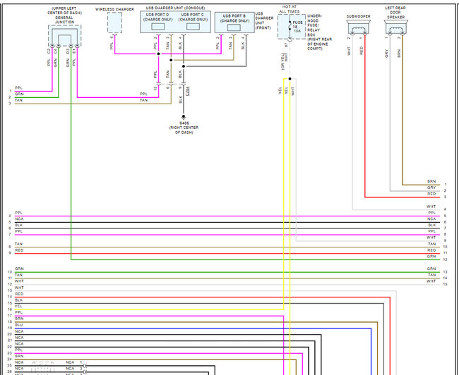

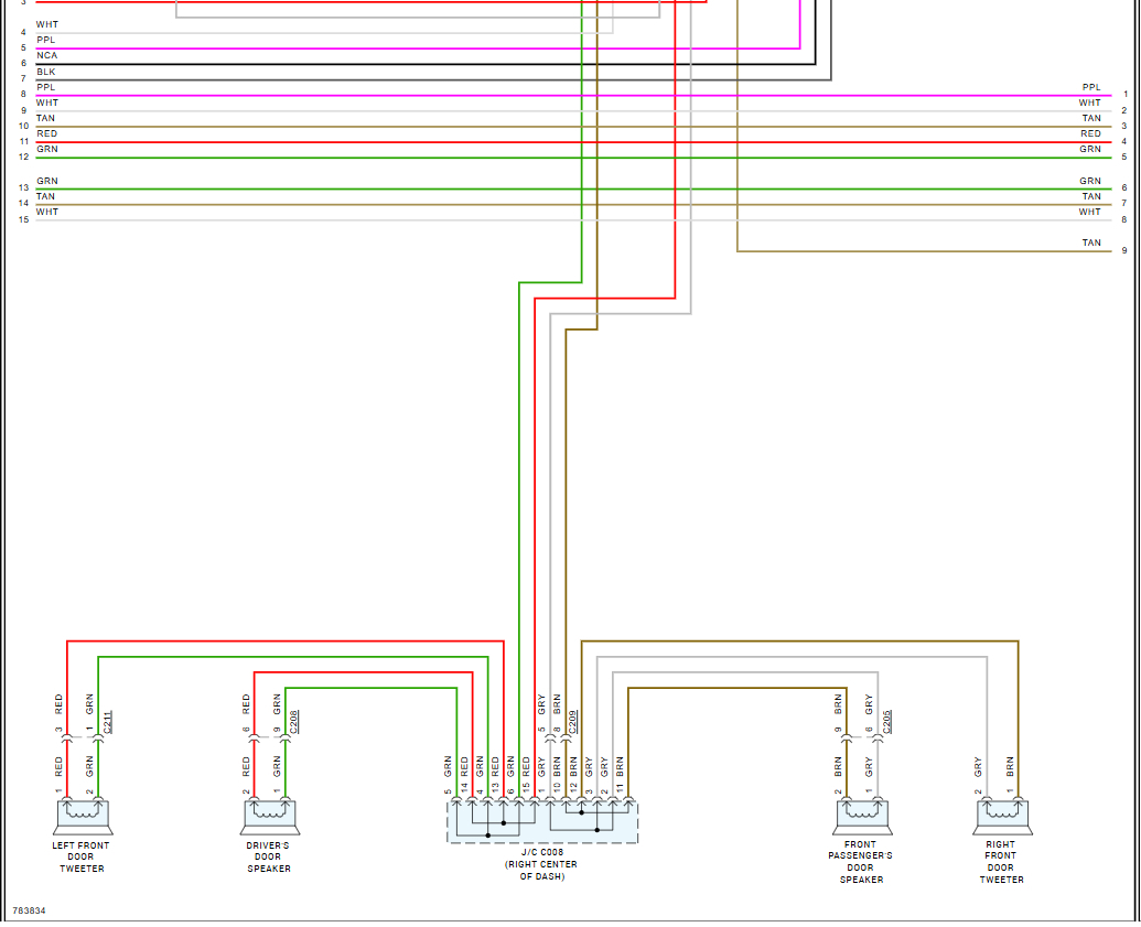

  • 54,520 POSTS

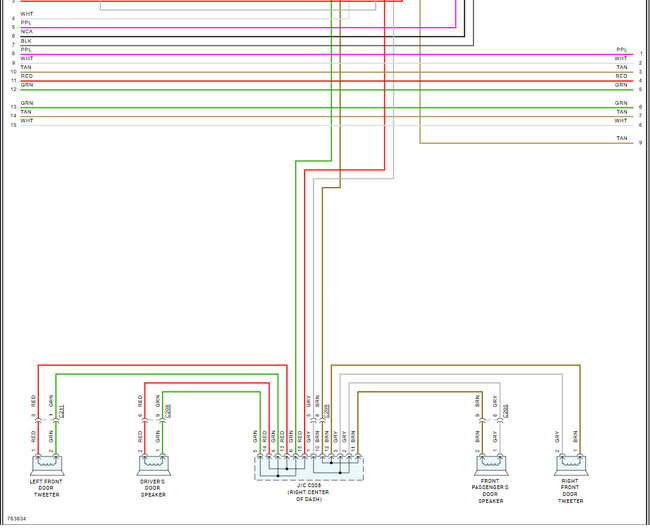

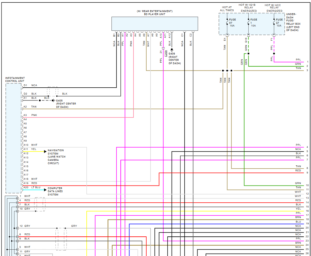

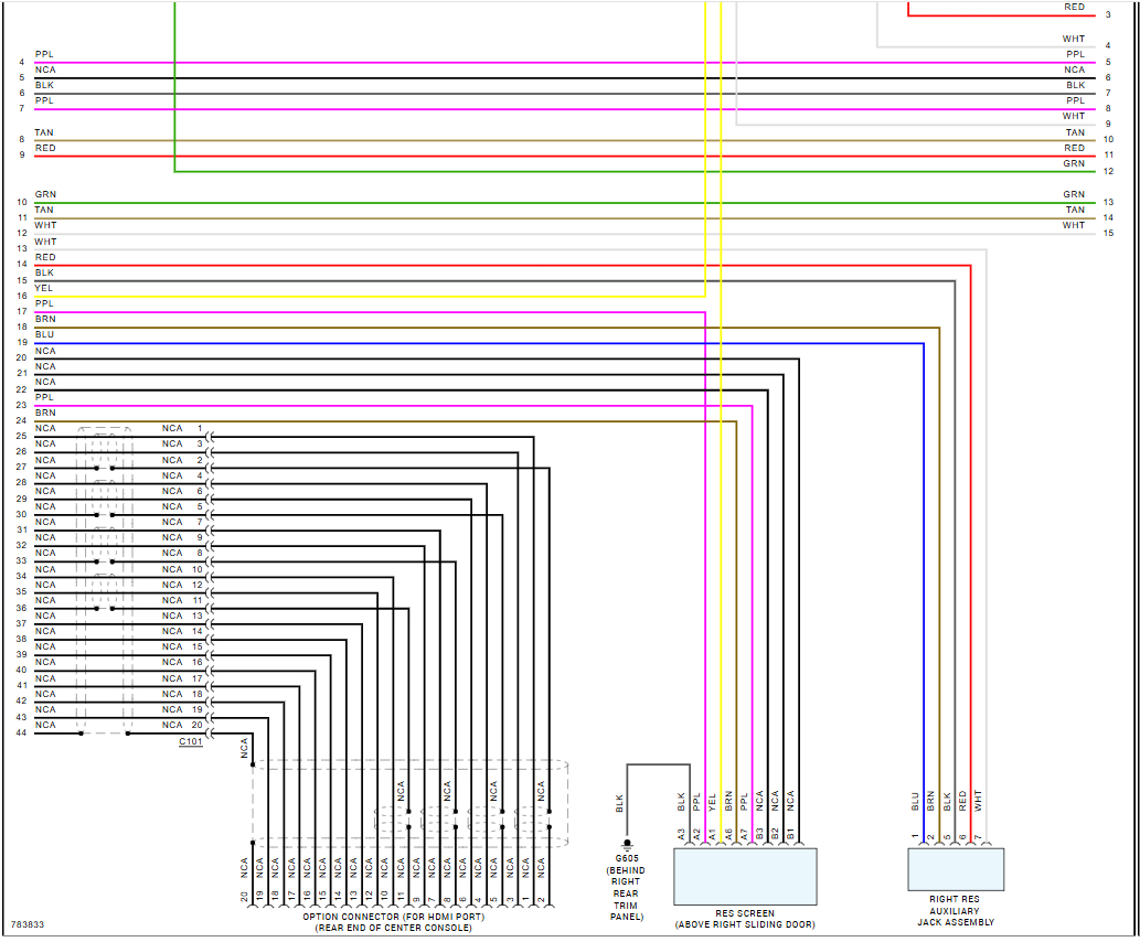

Sure, here is the sound system wiring diagrams, Check out the images (below). Please let us know what happens.
