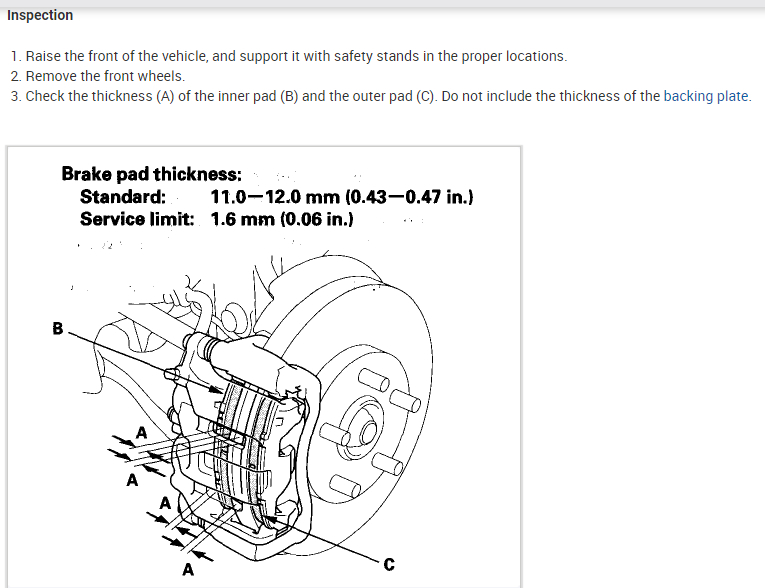

The minor maintenance requires an inspection of the brake pads
2008 HONDA ODYSSEY
7,500 MILES • 6 CYL • FWD • AUTOMATIC
MIKMETT

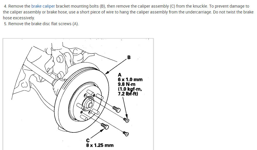

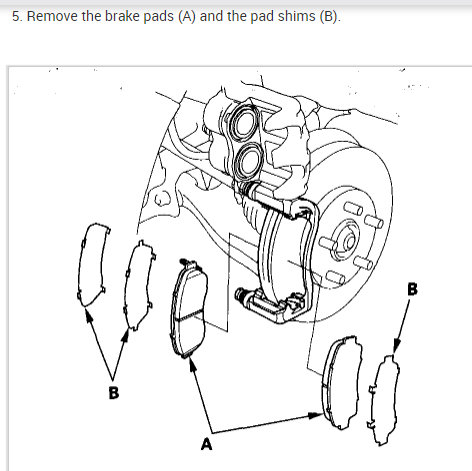

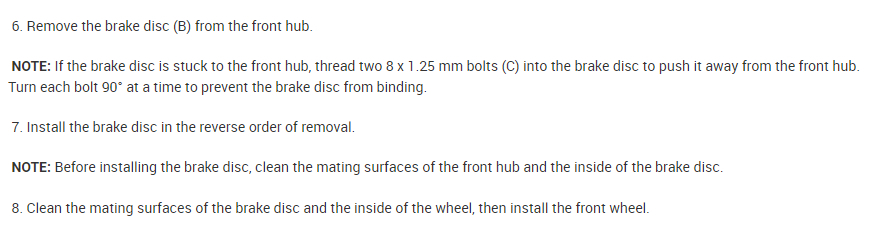

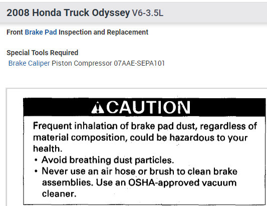

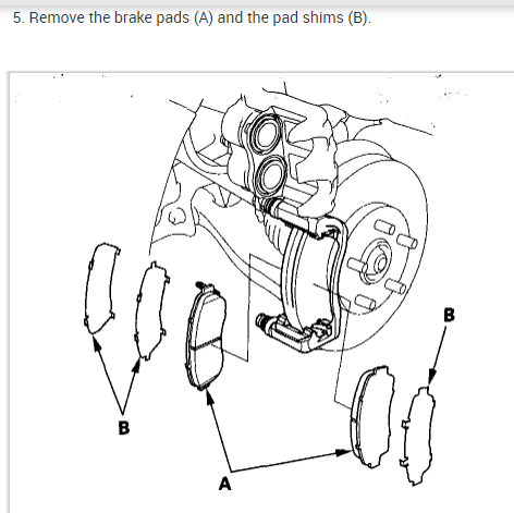

I plan to do all of the minor maintenance service intervals recommended by honda myself. The minor service intervals are 7500 miles and 30000 miles for major factory maintenance checks; I will have a dealer do the major service. The minor maintenance requires an inspection of the bake pads. Please explain with illustrations if possible or direct me to an appropriate illustrated diagrams on how to do this. I will purchase tools required. Thank you
Jul 9, 2008 at 9:48 PM
DANNY L
  • CAR REPAIR CONTRIBUTOR
  • 5,648 POSTS

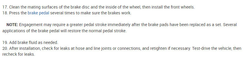

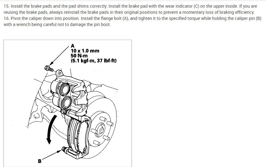

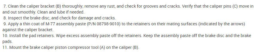

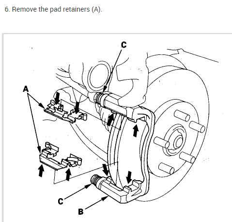

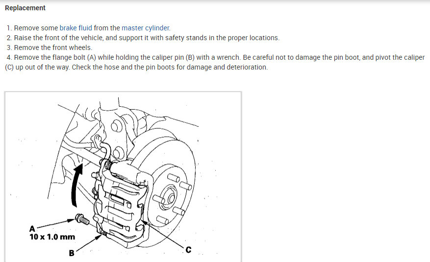

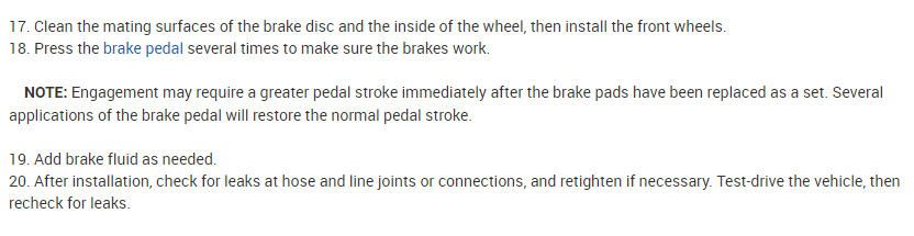

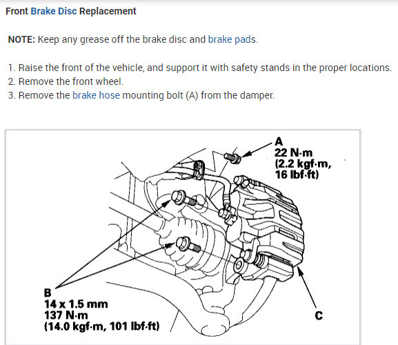

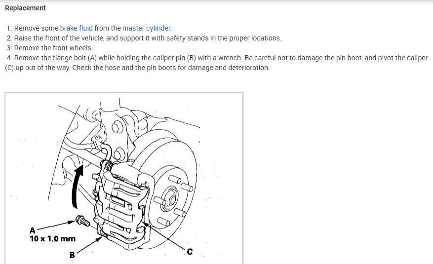

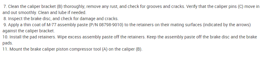

Hello, I'm Danny.

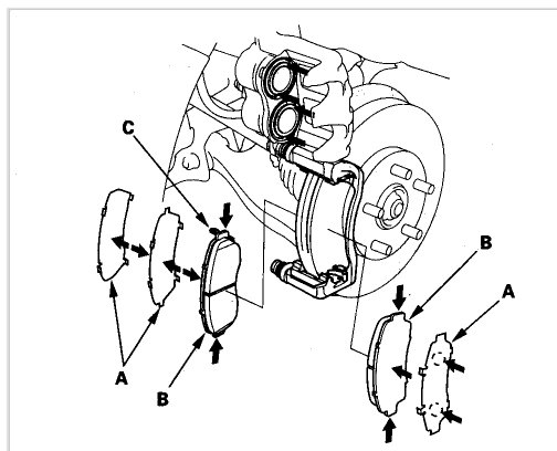

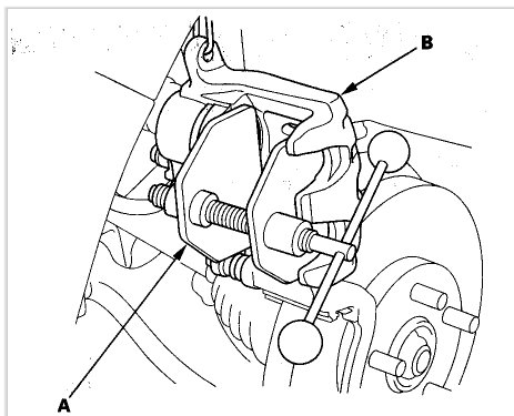

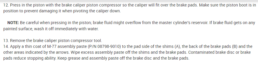

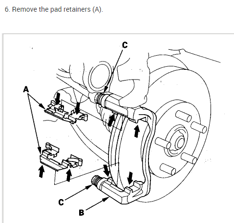

Here is the information you requested. This is a tutorial showing what is involved on how to change front brake pads and brake rotors:
I've attached picture steps below on how to change the front brake pads and rotors on your car. Hope this helps and thanks for using 2CarPros.
