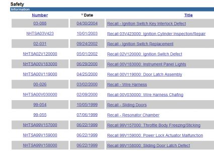

Also, you may have numerous recalls on various items on your vehicle. I believe the dealer will pay to have these fixed. I have attached them for you. Please contact the dealer, provide the service department with your VIN and have them see if any apply to you.

Hey - forgot to attach the recalls for you to check on!
https://www.2carpros.com/forum/automotive_pictures/248015_1_44.jpg
there we go
