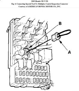

My 2003 Cr-V has stopped chiming when I open the door and forget my headlights on.
Yesterday I drained my battery because I am so used to this chime telling me that the lights are on.
How do I fix/diagnose what the problem?
Note that the dome light still works. So am not sure if this is the door switch or not that is the problem? Is the chime and dome light on same switch?

Hi JohnnyBMe,
The door and dome light switch are the same for iindicating when the door is open. The dome light has an additional switch that can operate to over ride the door switch.
If the dome light is working with the doors being opened, then the door switch is not the cause of the peoblem.
The other likely cause would be the key in switch. It is located on the key cylinder and not operating to inform the system that the ignition key has been turned off.
Another possibility is a faulty integrated control relay plugged into the under dash fuse box.

Sorry for a mistake made in my earlier reply. The integrated control relay is for an older version and for your model it is known as Multiplex Control Syatem.
All the problem listed falls under this control system.

Check the # 9 fuse in underdash fuse box. Replace it if it is blown.
Diagnostics can be done with the aid of a special tools which can be fabricated, it is a jumper wire as shown in diagram.
Get the jumper ready and I will send you the diagnostic procedures.

Upon further investigation. It actually is the door switch I think. The dome light trigger for the driver door does not work as I thought. I didn't test it correctly at first.
I think it is busted. The one on the passenger side is more firm. The driver switch is very soft. So probably broken.
. Do have/know of instructions to replace this switch.
Wednesday, January 13th, 2010 AT 7:00 AM
KHLOW2008
  • 41,814 POSTS
Yes, a faulty door switch would cause the problem.
I am not sure which tyoe of switch is used for your vehicle but for most Honda door switches, push the moveable tab and you would notice a crossed head screw.
Remove the screw and the switch can be pulled out, it is slotted in, behind which you would see a wire coupler. Disconnect the coper and the switch can be replaced.

Well, what do you know? Every once in a while a get a little bit of luck on my side.
. Before I went out to actually purchase the part, I went and checked it first. It ended up being that the darn switch came off the metal holder that is fastened to the rubber cover. I just snapped it back in and presto! It works again. Saved myself about $15CDN.
Thanks again.
