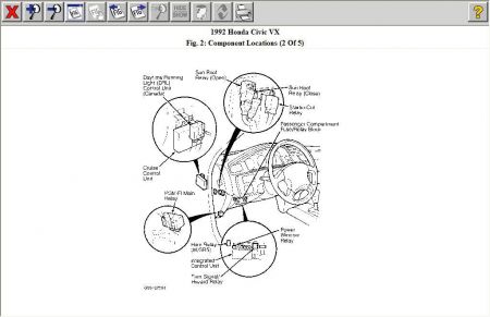

Is there anything else I need to do? like disable the ignition or anything else for testing compression?[/quote:e08360e9ec]
Go ahead and remove the PGM-FI main relay.then do your dry and wet check, makes sure you remove all the sparks plugs and mark the wires and also block the throttle plate wide open-[/quote:e08360e9ec]
Can I just hold down the gas pedal all the way when cranking the engine instead of blocking open the throttle? Also when doing the wet test, do you recommend using any special oil like marvel mystery?[/quote:e08360e9ec]
You cannot be in two places in one time get a helper while you look at the gauge-10W30 will do it.

Is there anything else I need to do? like disable the ignition or anything else for testing compression?[/quote:710a27240a]
Go ahead and remove the PGM-FI main relay.then do your dry and wet check, makes sure you remove all the sparks plugs and mark the wires and also block the throttle plate wide open-[/quote:710a27240a]
Can I just hold down the gas pedal all the way when cranking the engine instead of blocking open the throttle? Also when doing the wet test, do you recommend using any special oil like marvel mystery?[/quote:710a27240a]
You need to puff it atleast 5 times[/quote:710a27240a]
So is that a yes, it will be sufficient to have a helper press down the gas pedal while cranking and me looking at the gauge?

I just ran the compression test. For the dry test the results were: cylinder1: 195psi (6 cranks) 2: 200psi (7 cranks) 3: 200psi (8 cranks) 4: 200psi (8 cranks)
wet test results: cylinder 1: 220psi (7 cranks) 2: 230psi (8 cranks) 3: 230psi (8 cranks) 4: 230psi (7 cranks).
I know you told me that it should be reading 125-135psi on the dry test. Why do you think it is consistently reading so much higher?
