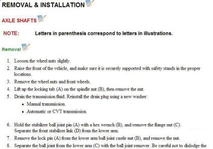

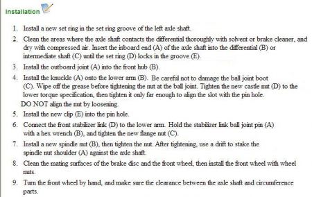

2002 HONDA CIVIC
2002 Honda Civic Two Wheel Drive Automatic
would like to know how to replace the driver side axle.
Tuesday, March 2nd, 2010 AT 1:30 PM
BLUELIGHTNIN6
MECHANIC
16,542 POSTS
Tuesday, March 2nd, 2010 AT 2:48 PM
