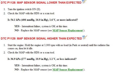

MAP sensor has different faults, what is the error code you are getting?
DTC P0107, P0108, P1128 or P1129 all are MAP sensor codes and different code has different testing procedures which requires a scan tool.
https://www.2carpros.com/forum/automotive_pictures/192750_DTCP1128112903Civic_1.jpg

Each one of the options tells me to replace the sensor. I've already done that.
