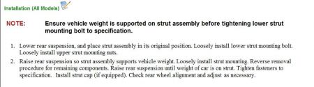

BLUELIGHTNIN6
MECHANIC
16,542 POSTS
Wednesday, October 13th, 2010 AT 12:47 PM
