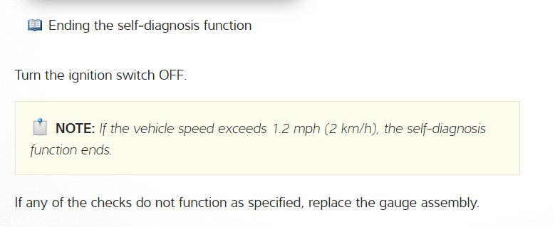

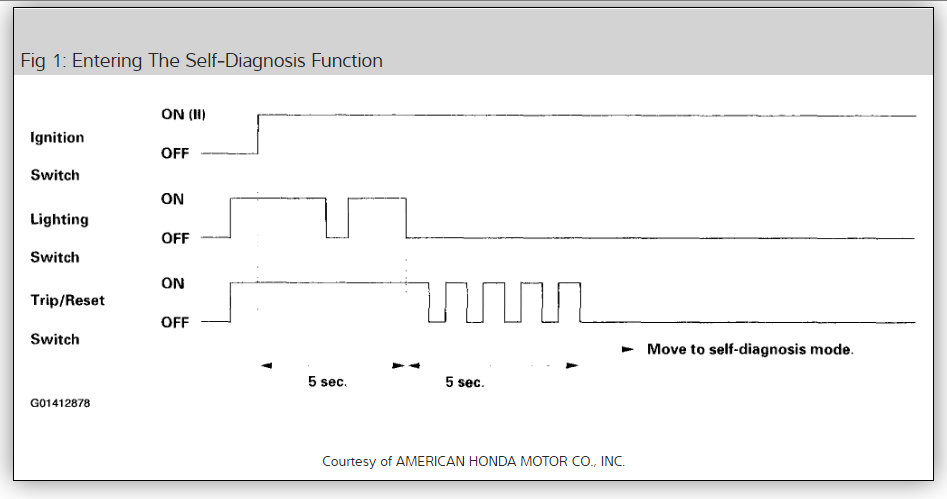

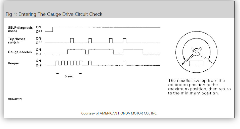

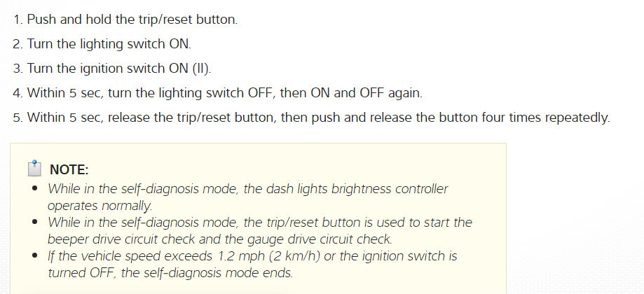

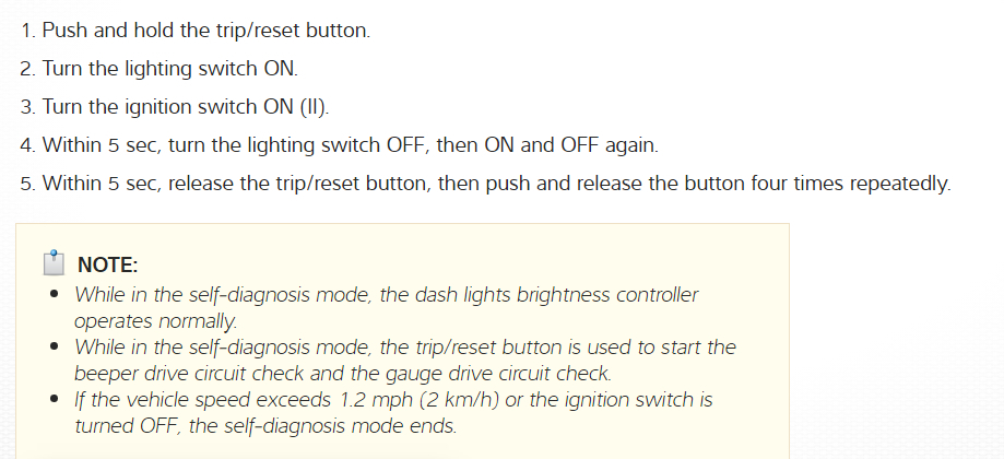

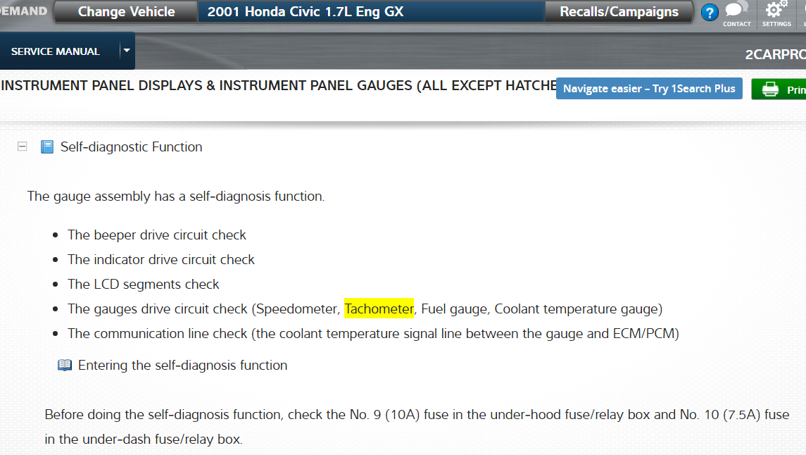

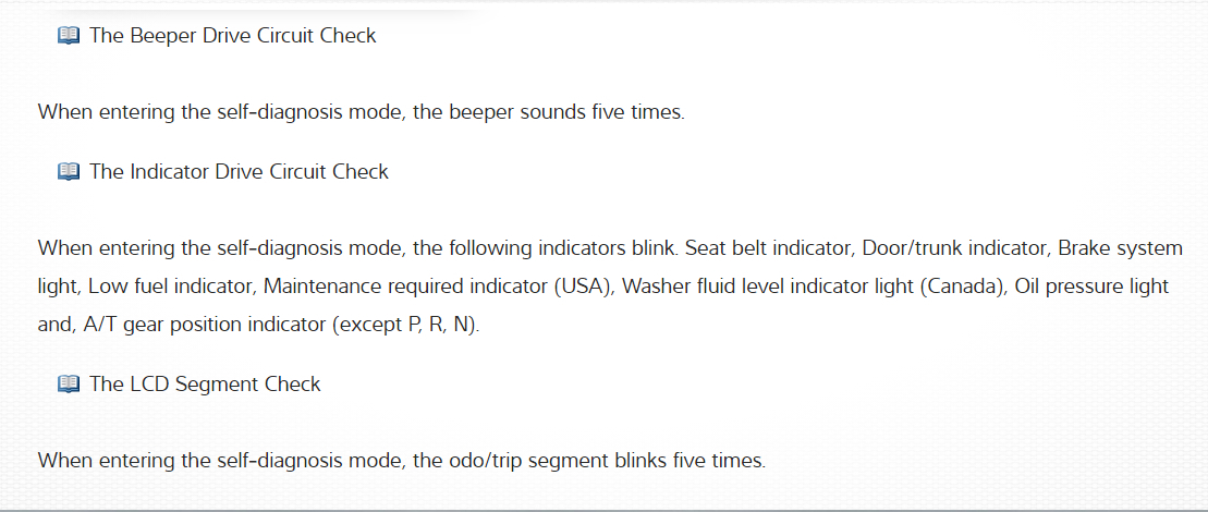

I've been working on the car listed above EX model. The car drives and runs but the rpm doesn't go up at all and the car doesn't accelerate like it's suppose to. I've changed three of the oxygen sensor at the front of the car, the TPS, and the mass air flow sensor. I was hoping someone would have an idea of what's wrong.
Aug 8, 2020 at 11:13 AM (Merged)
TANKB
  • CAR REPAIR CONTRIBUTOR
  • 19 POSTS
Hello SEGMA.
Pull your cluster panel check the cable that runs from the transmission to the cluster.
SEGMA
Everything on the cluster looks good and it was plugged in properly.
SCGRANTURISMO
  • 4,897 POSTS

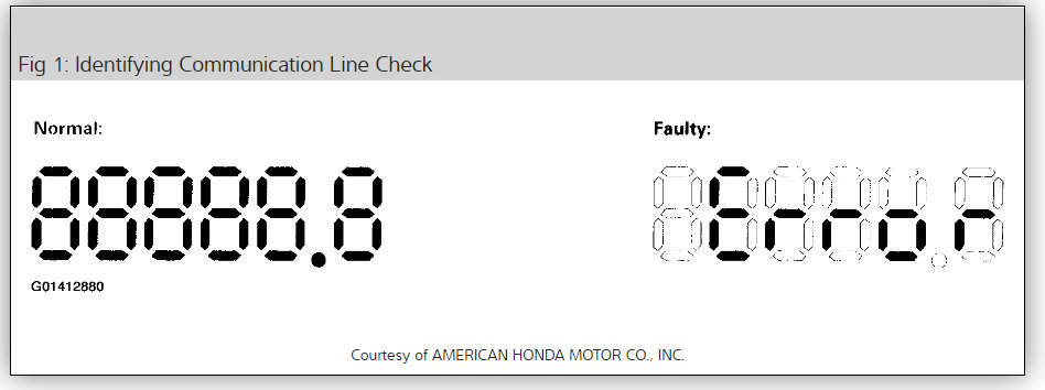

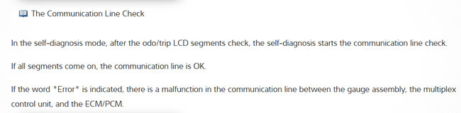

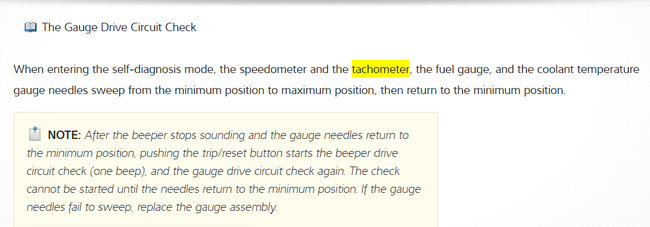

If I could step in here real quick. There is a Self Diagnostic Test you can do to test the functioning of the gauge assembly. I have included it in the diagrams down below. Please go through it and get back to us with what you find out. If the gauge assembly needs to be replaced we can give you instructions on how to do that as well.

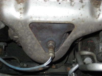

I was driving my honda civic fine until yesterday, it suddenly started to slow down.Here is what i observed 1.The car did not stop until i stopped it manually. 2. I Started my car, and it started perfectly alright. 3.Tried to Accelerate the car, But the RPM only stops at 3000Rpm and doesent go beyond that. 4.I tried to move the car on Drve mode, the car moves very slowly and does not have power to go up the street. 5.After driving to home probaly like 2 miles, in th same spped i.e 20-25mph.When i apply brakes on traffic lights when in Drive mode the engine stops. 6.i opened my Hood and observed that the Chamber where the spark plug is located id RED HOT. 7.I stopped the engine and checked for Oil levels and transmission fliud's everything fine. 8.In the morning turned back the car ON, perfectly turned on,and put the car on Drive and the car was runnig fine. 9.Im still wondering what could have happened to the car??? 10.Could that be a problem of coolant?? 11:Transmission problem??
https://images.2carpros.com/forum/automotive_pictures/468275_IMG_1785_1.jpg
F4I_GUY
  • 3,302 POSTS
The engine is in limp mode and there is either a fuel or ignition cut. Your exhaust manifold is red hot because you are spitting out a lot of raw fuel into the exhaust.
Scan the PCM, that is the first step to diagnosis. There could be a number of different problems.
