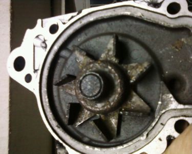

AXIS
  • 107 POSTS
Most probably you have a water pump problem.your thermostat was changed several times, however the pressure of the pump in not enough to open the thermostat fully. when whas the last time it was changed? before you replace more parts,have it checked,replace if the blades are badly corroded.

HJ3
  • 7 POSTS
I changed the water pump in the middle of june of this year. Before that, the water pump that was in the car was the original water pump and finally died. The problem existed though before that water pump died. When I replaced the water pump, I also replaced the timing belt, tensioner, and pulley belts. I replaced the original water pump with a gmb water pump and a contitech timing belt. Thanks!
