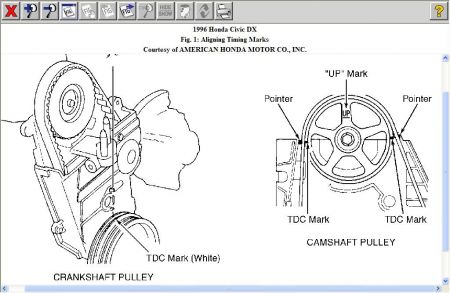

I had the head pressure tested and they found a crack. It was cheaper 2 get another head so my question is how do I set it 2 TDC? On the block the pistons are #1 Up to top of block#2 down #down and #4 up to top of block. Thank you for all of your help, This has been a nightmare.

Put no.1 piston on its compression stroke-then line the camshaft and crankshaft sprockets then put the belt/chain on-

So on the #1 piston I have it up to the top correct? On the head lining the camshaft and crankshaft sprocket do you just line them with the #1 so when the piston comes down on #1 the intake should start to open on the #1?

Put no.1 piston on compression stroke/TDC
Line the sprockets as you see below then install the belt-
https://www.2carpros.com/forum/automotive_pictures/12900_timing_16l_1.jpg

So it does'nt matter how many times I turn the sprocket on the head just as long as I line up the up mark with the white mark? Thank you very much!
