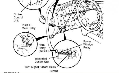

Starting the engine for a short while would not cause any further damage if there are oil and coolant.
Did you check the radiator coolant level?
If the engine could not be started and the cause is lack of fuel, then the most likely fault would be the PGM-FI main relay. It is a known problem and tends to fail intermittently.
Remove the relay to chjeck for cracked solders on the circuit board and if any found, resolder them to rectify.
https://www.2carpros.com/forum/automotive_pictures/192750_PGMFIRelay95Civic_4.jpg

This afternoon I returned to my car and found a red "7.5" chip on the driver's side floor. I checked under my steering wheel and found the slot it was missing from and put it back in (I am unfamiliar with the chip and am going to look it up online). Then I added coolant to the car (max volume) and started the car. It took a couple of tries, but it started. I let it run for five minutes to check if the coolant was leaking. It was not. The engine ran quietly.

I looked up the chip, it is a fuse. It may have been the fuse for the PGM-FI, like you mentioned earlier, but 7.5 fuses are used for several different things.
