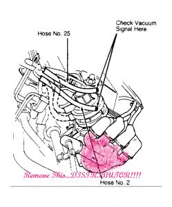

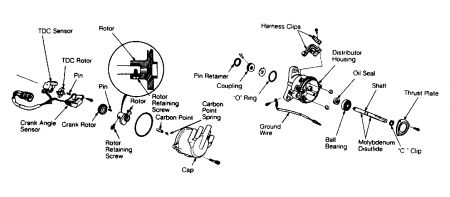

'90 Honda Accord. About 220k. Auto. I had my car checked out to see where my oil leak was. They said I needed to replace my oil pan gasket and the distributor seal. I know how to fix the oil pan gasket, but where does this distributor seal go? I'm assuming that after I get the pan off it might be somewhere up there but I cant fix it til I know. Help.

The distributor is the ignition part with spark plug wires coming out of the top. Remove it and replace the seals!
https://www.2carpros.com/forum/automotive_pictures/62217_90_Dist_copy_1.jpg
https://www.2carpros.com/forum/automotive_pictures/62217_Seals_1.jpg
https://www.2carpros.com/forum/automotive_pictures/62217_30961_mitchell_2_10.jpg
