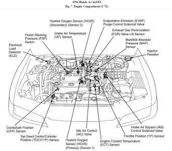

2.I asked about the resistor box under the hood?

I am sorry I do not understand which resistor box you are referring to, can u upload a picture of it?

Resistor box is at the left firewall DIRECTLY UNDER THE Hood

You must be referring to the injector resistors.
https://www.2carpros.com/forum/automotive_pictures/192750_EngComp96Accord6cylFig07_1.jpg
Fuel Injector Resistor
Unplug injector resistor harness connector. Injector resistor is located over left front fenderwell. Measure resistance between injector resistor terminal No. 5 and terminals No. 1, 2, 3, 4, 7 and 8. See Fig. 4 . Resistance should be 5-7 ohms for each measurement. If any measurement is not as specified, replace injector resistor.
