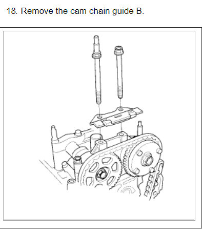

I have a 2004 Honda Accord 4 cly with 117,000 miles. Do I need to replace the timing chain? If so, at what miles?
I just double checked my owners manual and the 4 cyl.'S do not have a belt. The V6 does but not the 4cyl. It has a chain. And they recommend every 60,000 miles changing the belt (though I usually see 90,000).

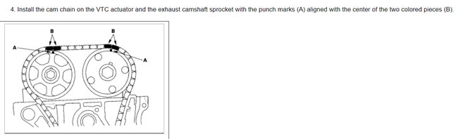

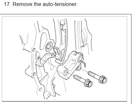

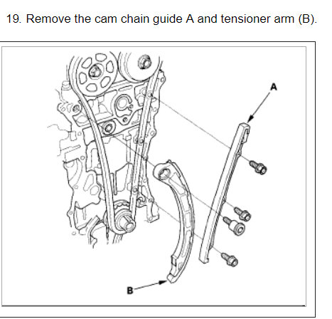

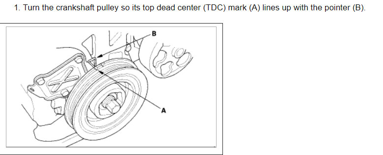

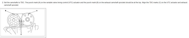

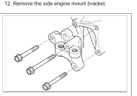

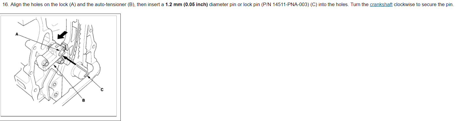

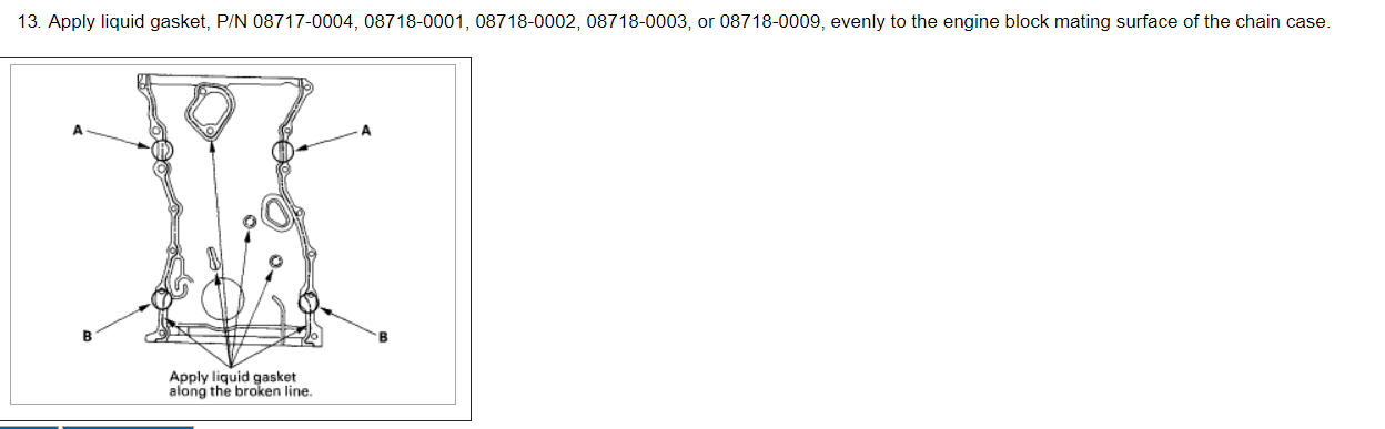

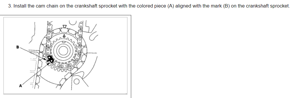

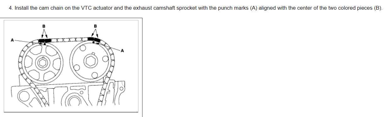

That is correct. The in-line 4 cylinder engines do have a timing chain, but there is no set interval for replacement. They are supposed to last up to 150,000 miles or the life of the vehicle. As for the V6 with timing belts, the mileage depends on the severity of the driving style. 105,000 is what the dealer recommends replacing the timing belt under normal operating conditions. Under severe operating conditions the mileage is every 60,000.

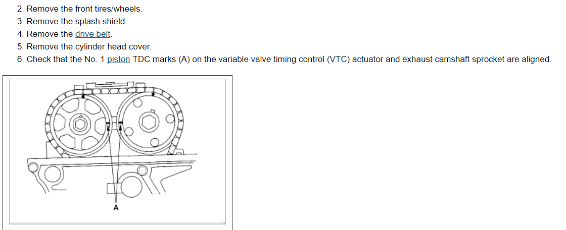

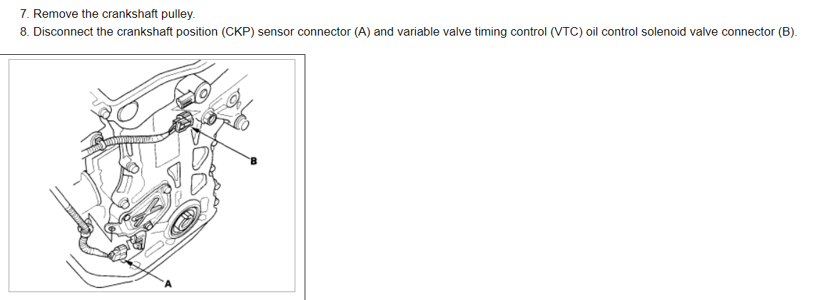

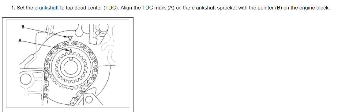

Here are the timing chain replacement guides so you can see for yourself.
