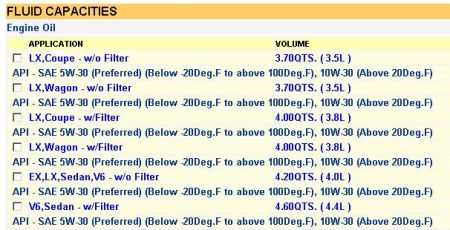

How many quarts of oil and type of oil are required for this car?
Thursday, August 15th, 2019 AT 5:36 PM (Merged)
ZACKMAN
  • 4,202 POSTS
Fluid Types
Engine Oil
New standard for engine oil, GF-4. See TSB SN050109 for Honda Service News 050109 for additional information.
API Classification .................... SG
1993-95 Del Sol 1.6L VTEC & 1993-96 Prelude 2.2L VTEC
Above -2°F (-20°C) .................... 10W-30 (preferred)
Below 32°F (0°C) .................... 5W-30
All Others
Above 20°F (-7°C) .................... 10W-30
All temperatures .................... 5W-30 (preferred)
Capacities
https://www.2carpros.com/forum/automotive_pictures/55316_96accordoil_1.jpg
